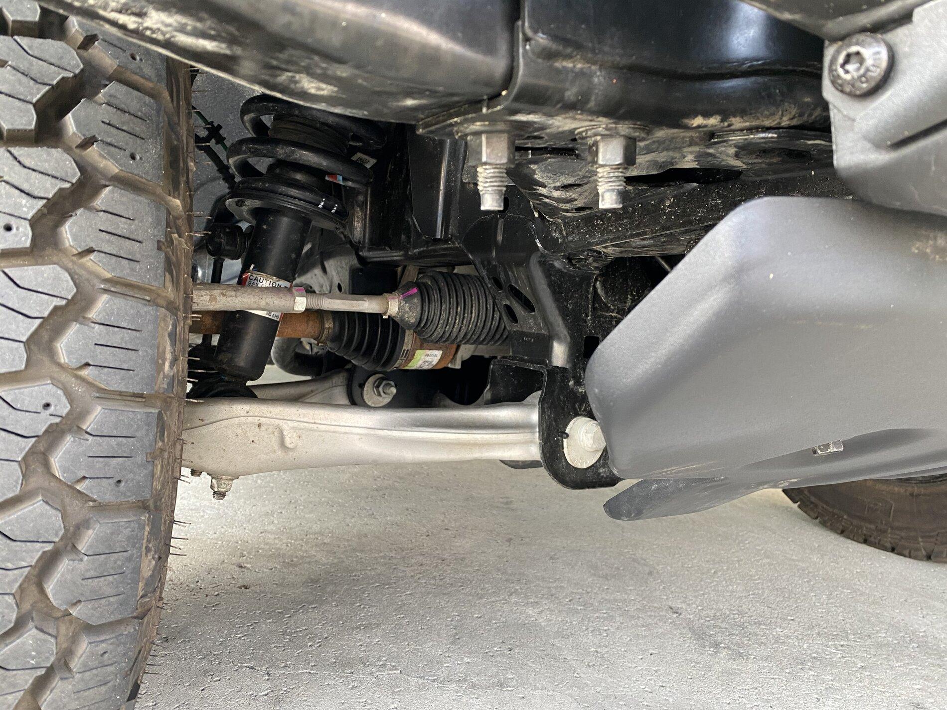

Thank you to @618TRVLWILD Ashley for getting photos at a demo yesterday and to @Pittguy for photos from an event he attended.
📸: STL Ball Park Village Event: (2) Badlands 4-Door Broncos in Race Red & Rapid Red
Taking the Bilstein part numbers from the photos here is what I found so far:
F4-BE5-M970-W6
MB3C-18080-ARJ
202660079
The Bilstein "F4-BE5" part number denotes the Bilstein 5100, non-reservoir, family of shocks. However since this is a Badlands, which include units with an external reservoir we have to assume Bilstein is playing with the part numbers for Ford or these are Pre-Production units that do not have the final part numbers assigned. The second and third set of part numbers did not reveal any information in a Google search.
The "HOSS System with Bilstein™ Position Sensitive Dampers" appear to be a derivative of the Bilstein "B8 8112" family which are called the ZoneControl® CR family. These dampers-shocks are that are available on the BL, WT, FE or Sasquatch package.
BILSTEIN B8 8112 (ZoneControl® CR) Damping perfected
The standard "HOSS (High-Performance Off-Road Stability Suspension) System" are on the B, BB, BD and OB. Currently these have been seen as black colored shocks so what Bilstien series these are is still unknown.
REQUEST: For anyone that is able to see the Bronco's in person, please see if you can get photos of the dampers-shocks with the part number sticker and then post them with the model they came from.

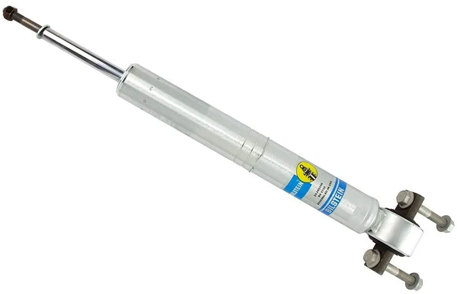

has anyone seen how they attach to the control arm ? they look similar to 6112 bilsteins for the F150 and those have an adjustable spring seat

Ford Bronco Bilstein HOSS & Position Sensitive Dampers Part Numbers & Differences 9D94CF0B-3709-46DC-A667-06380B7048AE
crossbar mount like this is my guess... since it’s a thru hole style shock, mounted to an aluminum A-arm.
