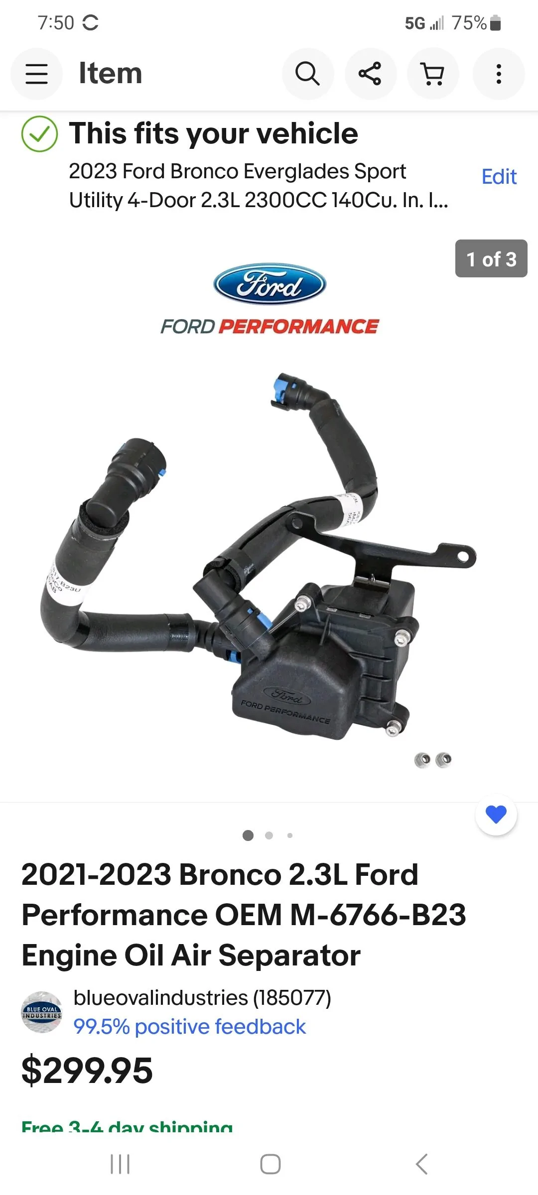

Catch can needed?
Helomech73
Everglades
Jan 30, 2023
39
2023 Bronco
Everglades
Ford Performance
Ford Bronco Catch can needed? Screenshot_20230322_195054_eBay

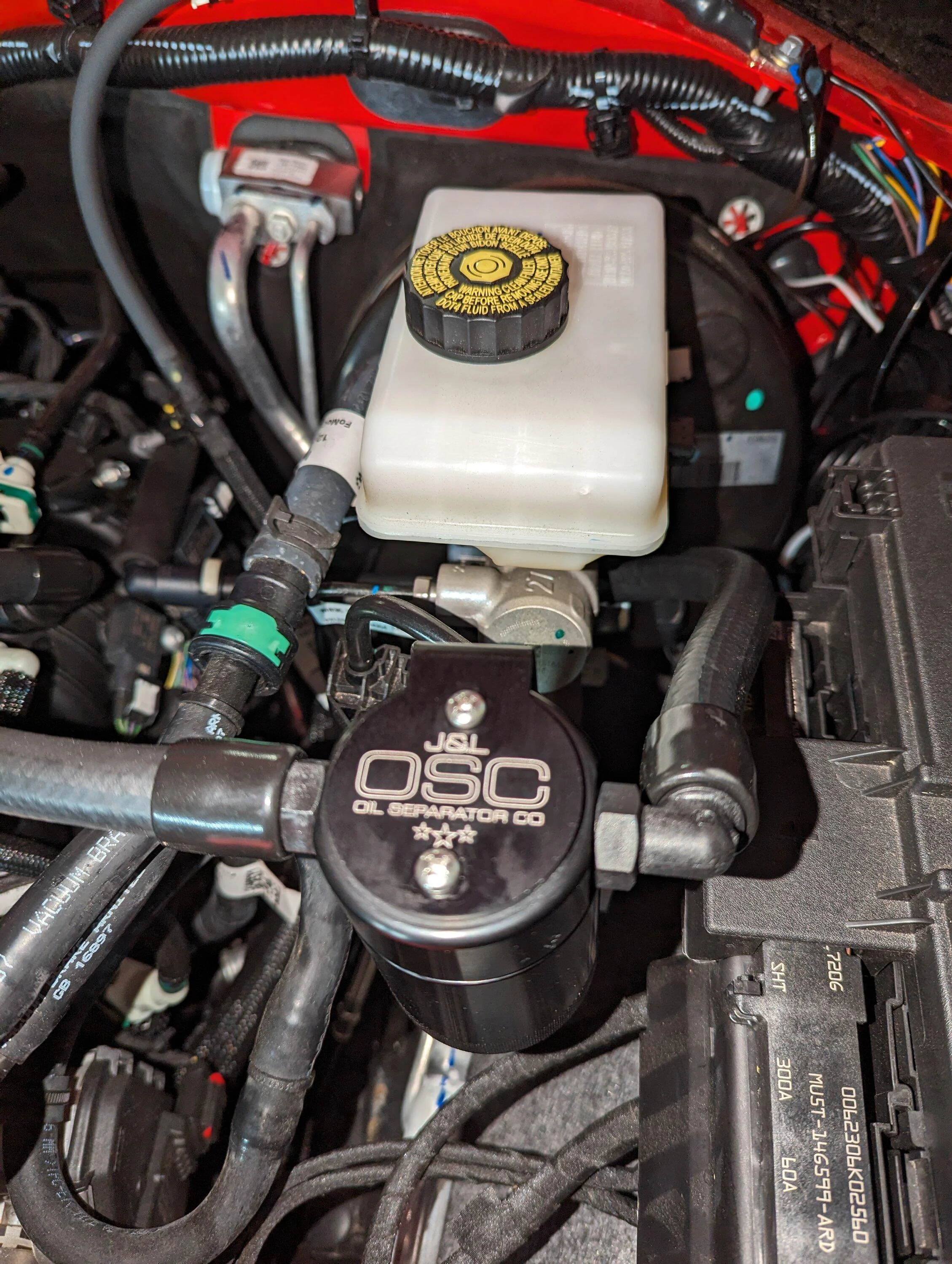

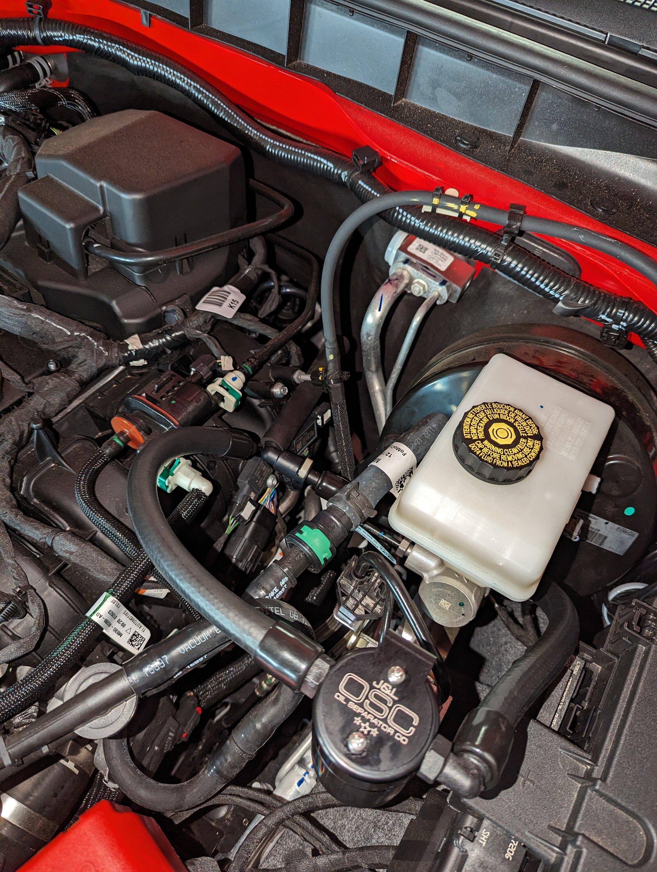

J&L Oil Separator Co. sells a can for both the 2.3 and 2.7. Found on Amazon for free shipping. I have a 2023 Big Bend with the 2.3L and the can mounts in what looks to me to be a very convenient place. It mounts on the end of the "brake line lock". There is already a hole there and you just bolt the can there. The rest is plug and play. The can I believe is 3 ounces but for about $40 more you can purchase a 6 ounce can.
I looked up the 2.7 and while maybe not as convenient as the 2.3, it is still in a very accessible place on top of the engine. It bolts into an empty mounting hole on top the engine. Looks like you discard the original hose and use the J&L hose. You can find the pdf instructions on their site by looking up the product.
Do I need it? No idea but for about $159, I will play the game. Installed today and will check it at 500 more miles.
I had a 2020 Colorado ZR2 Bison diesel and some of the forums for that engine recommended a can but as I recall you would needed to cut factory lines and I just wasn't in to it. Unplugging the factory line and plugging in a middle line and can is easy maintenance.
Ford Bronco Catch can needed? PXL_20230805_141059802
Ford Bronco Catch can needed? PXL_20230804_143154035
Ford Bronco Catch can needed? PXL_20230805_141050935
BobN - USAF
Robert
Mar 26, 2023
90
180
Tallahassee
2023 Bronco Big Bend, 1942 Ford GPW (jeep)
Well, do I need a catch can? The J&L is a quality product to be sure. I checked the can 500 miles and again after another 1000 miles. There is basically no liquid in the can but there is a fine coating. So it is catching the oil. Not sure how many miles you have to drive without one to see any accumulation or what ever. I'm going to leave it for 2000 miles and see what I have after that. I don't really drive much these days since I'm retired. I bought the 23 in March and since then I have a little less than 5000 miles on it.
