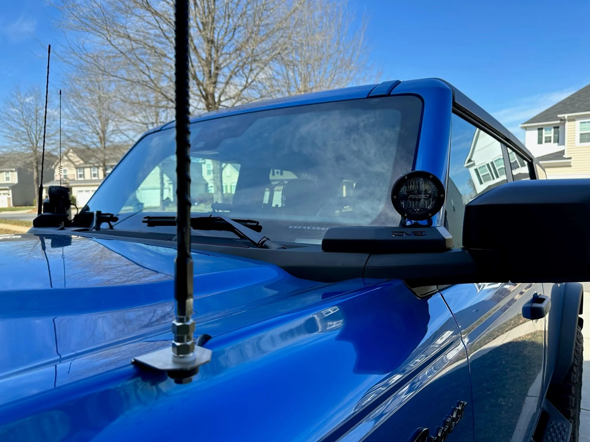

Hi, Brandon-- No the GMRS ant is mounted on the passenger side fender on a stainless mount just like the CB ant is on the driver's side (photo). Both coaxes are run from a rubber grommet in the firewall just above the brake pedal (automatics only, I believe). So the GMRS coax is the only one that has to traverse the engine bay (this is an old photo when I had the GMRS ant mounted on a DV8 light mount). I'm thinking I may just have to get an inline RFI filter for the GMRS. :confused:

Ah so it runs along to the driver's side and goes through the firewall then back to the radio above the glove box.
Just curious but did you notice the noise when that antenna was mounted up by the mirror like in this photo?
Reason I ask is the lights that are mounted, LED's, especially cheap ones if they are that, are notorious for noise.
Last question, I think, factory connectors on the antenna cable or did you put the connectors on? Not trying to question your work just working through my own troubleshooting in my head.
