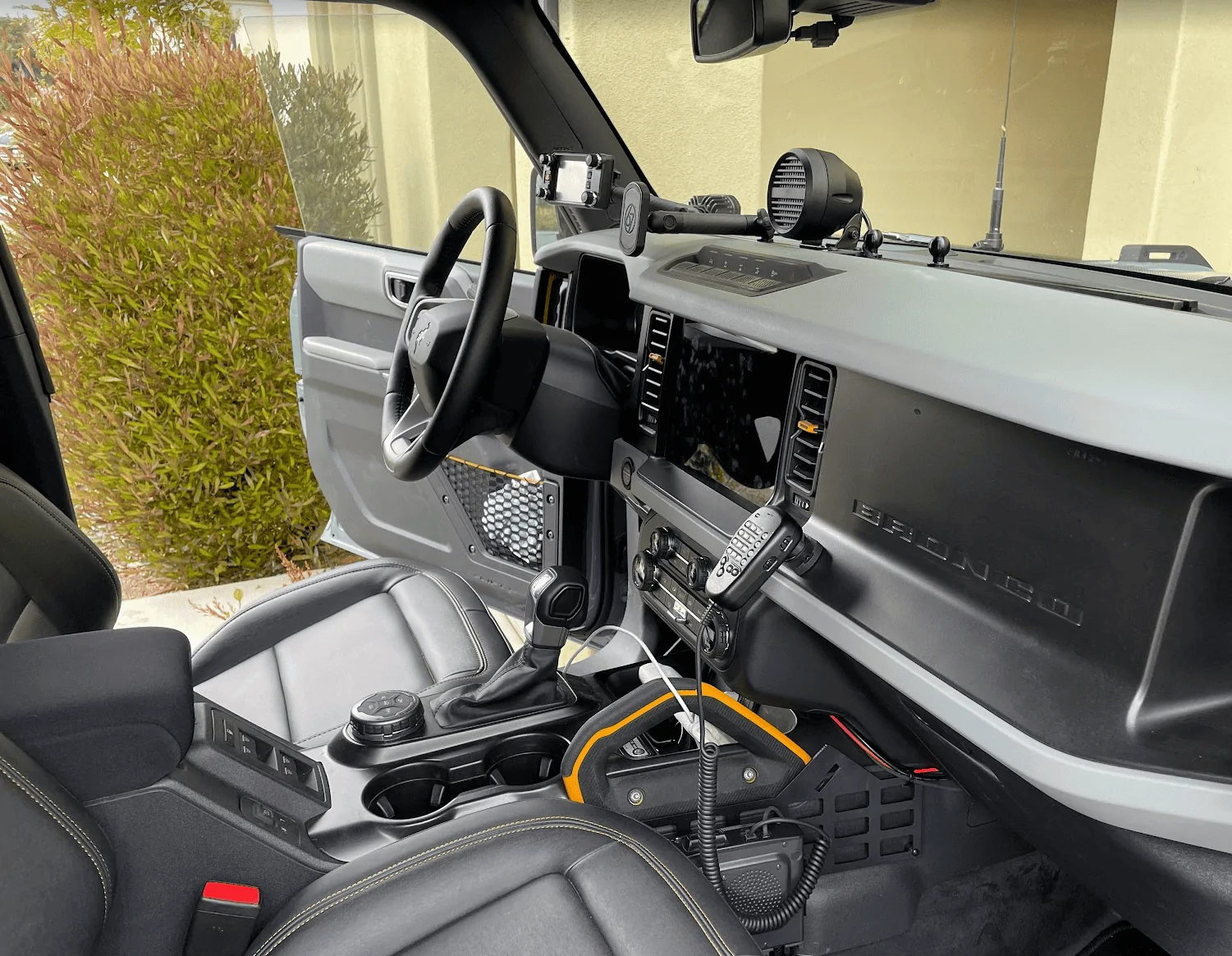

Currently I put my 400 on a JCR molle panel off the passenger side of the center console, with a remote speaker in the center of the dash mounted to a 67D device rail, and the radio control panel off of an mounting arm coming off the same device rail over the left most AC vent. I intend to relocate the radio itself to underneath the steering wheel, move the antenna to a mount near the a-pillar (and out of my field of view entirely), and the control panel to above the driver's sun-visor to clear up my dash. As for my remote speaker, I love that damn thing despite the eye-sore. I can hear everyone nice and clear.
Also: If you can get the MARS mod done to your 400, you should. Being able to also transmit on GMRS is NICE. One radio to rule them all!
You can see most of my setup in this one photo:
Ford Bronco Ham Radio gear help 1690323763906
This is awesome. Thank you very much for the extensive information and picture of your setup. I sincerely appreciate you taking the time.
