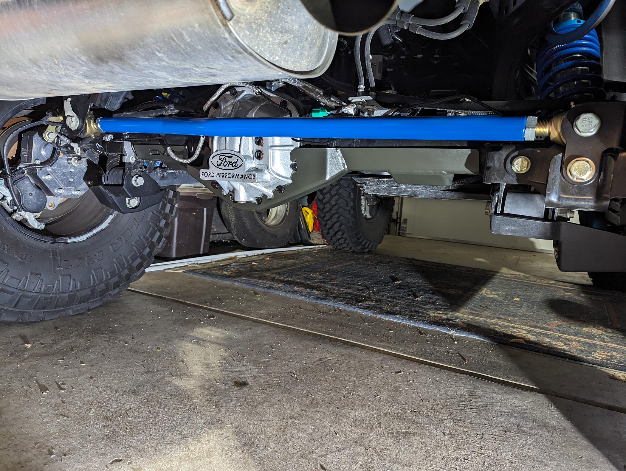

Does anyone know which rear diff skid plates will still work with this cover?
I got the DV8 to fit, just had to do some cutting to clear the cover "fins" and drain plug area.
made a cardboard template using the skid then trimmed until it fit the outside of the cover.... Used that template to cut the skid. Easy enough.
And YES it rides/steers better with the track bar horizontal.
Ford Bronco Ford Performance Rear Differential Cover Installed Impressions Glute Day
That's fantastic! Thanks for the input!
