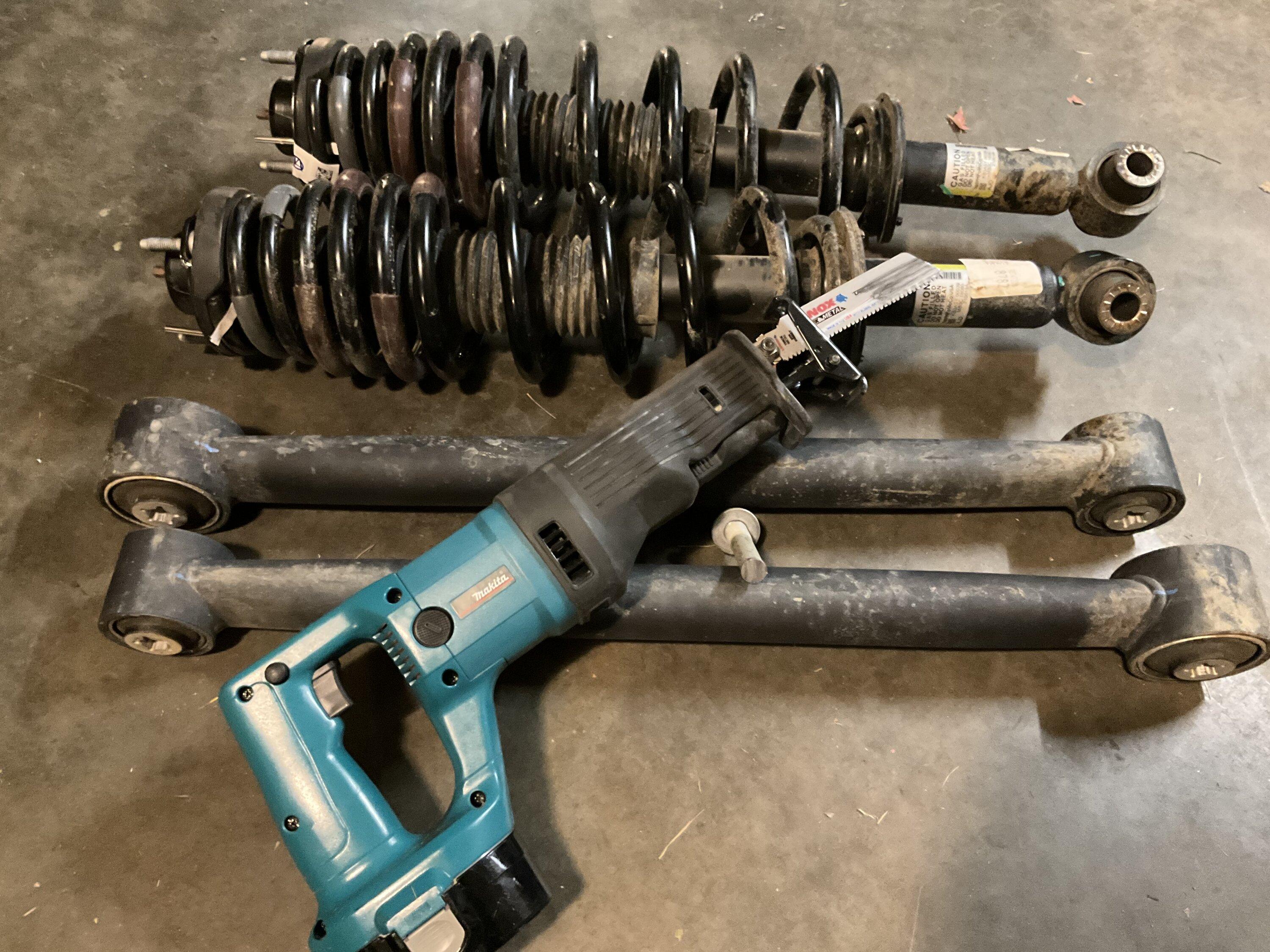

kodiakisland
Jul 10, 2020
5,767
16,374
Arkansas
12 Tacoma, 18 Indian, 23 GV70
Sawzall works fine to cut the bolt.

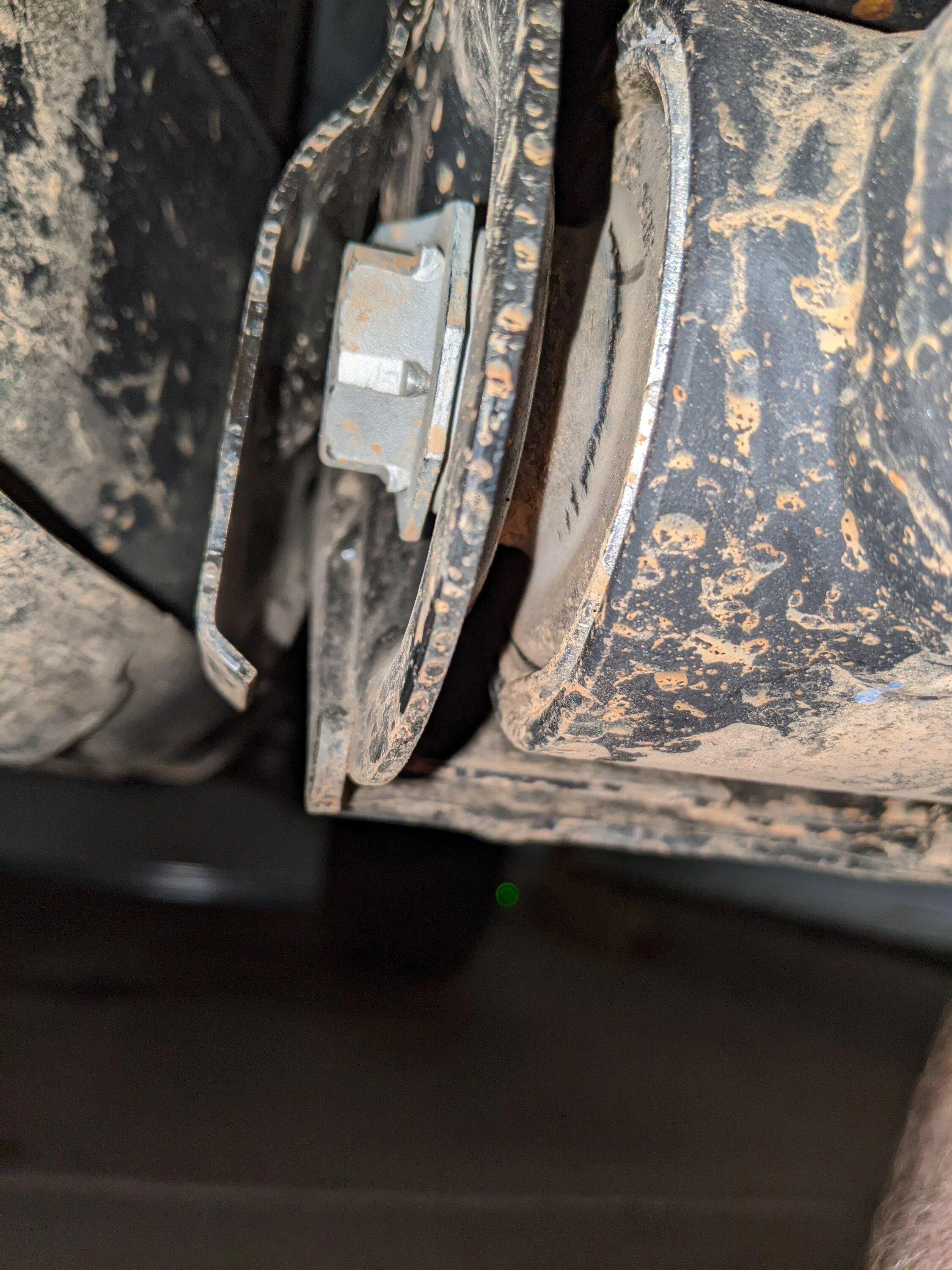

Did you not have this cover over the head of the bolt?
The way it sandwiches the tab on the bolt head, I don't think I can get it clear of the frame mount to cut the head off. I also don't think I can get to the screws holding the cover on.
