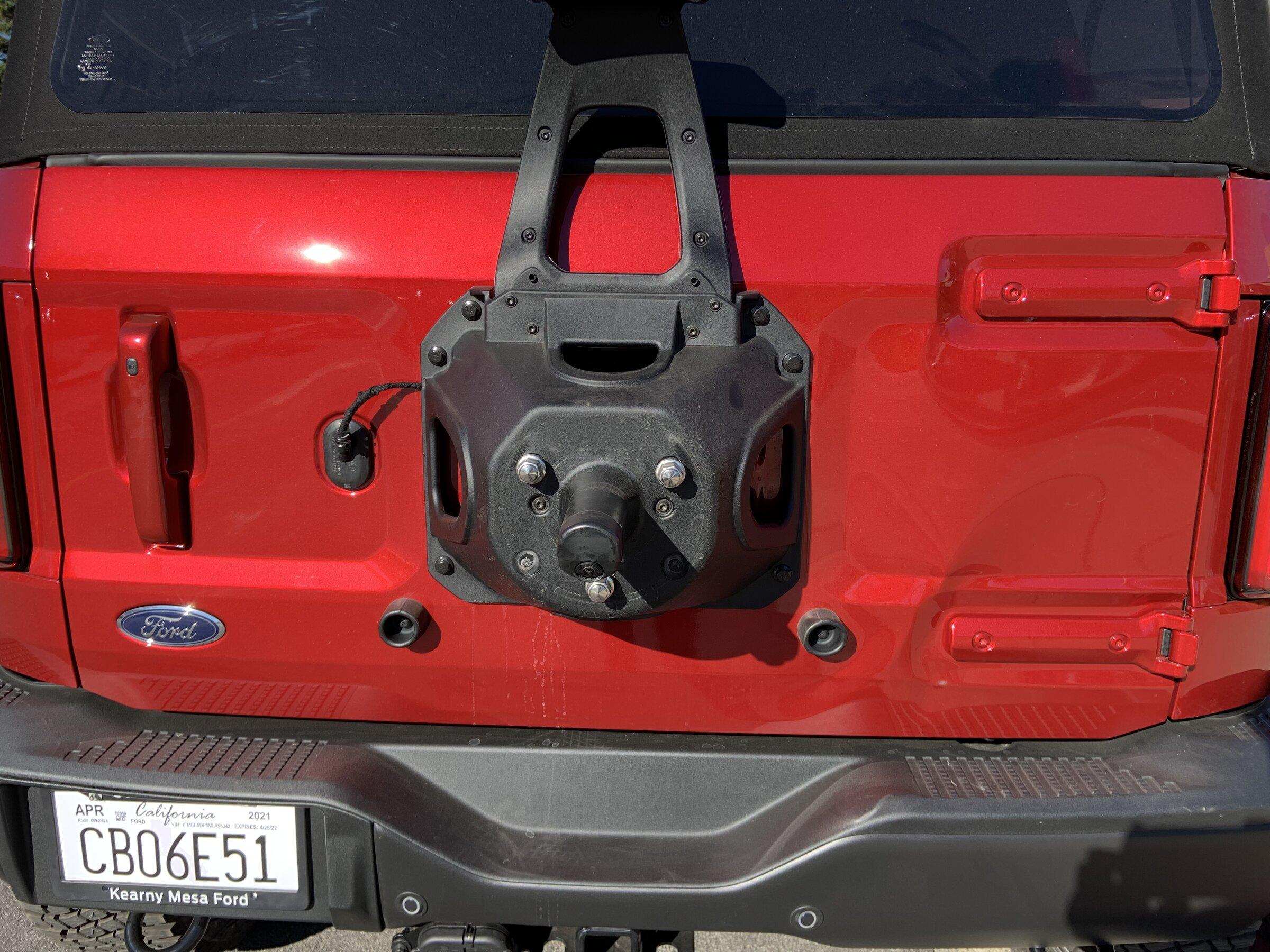

Brocno was dropped off this morning at my local dealer. The intense thudding/ratting has caused damage to my tailgate.. Dealer said its so bad that looks as if somebody backed into something... This is within the first 300 miles. Very upset to say the least

They said the tailgate was creasing at the rubber tire bumper & that it looked like somebody backed into something. I donā€™t believe anybody backed into anything though; I think that damaged was caused from the constant thudding of the tire on the 3 1/2hr drive home

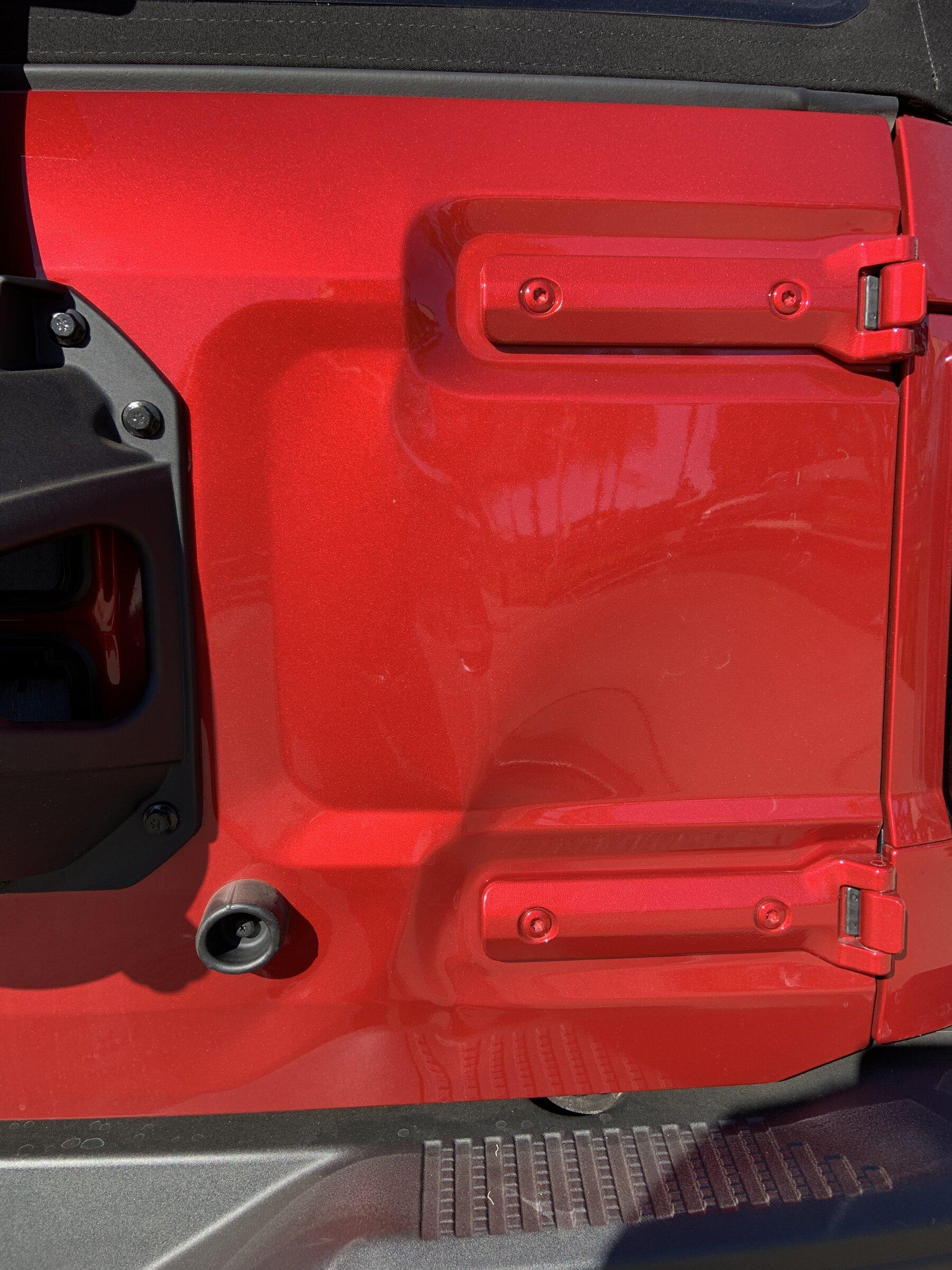

Took the Bronco back to the dealer and they found this. Hopefully will get replaced
Ford Bronco Gnarly tailgate rattle 0D736BE8-F9DC-4AC7-ABB2-A91DE8C4703A
I bet mine will end up looking like that eventually. Seems the noise gets louder. I havenā€™t had time to get it to the dealer. Whatā€™s up with this @Ford Motor Company ā€¦?

Thatā€™s fascinating - why would that happen on some trucks and not others. Bad batch of rear gates that arenā€™t properly stamped or reinforced.
Iā€™m surprised they didnā€™t just say you bent it and go pound sand
