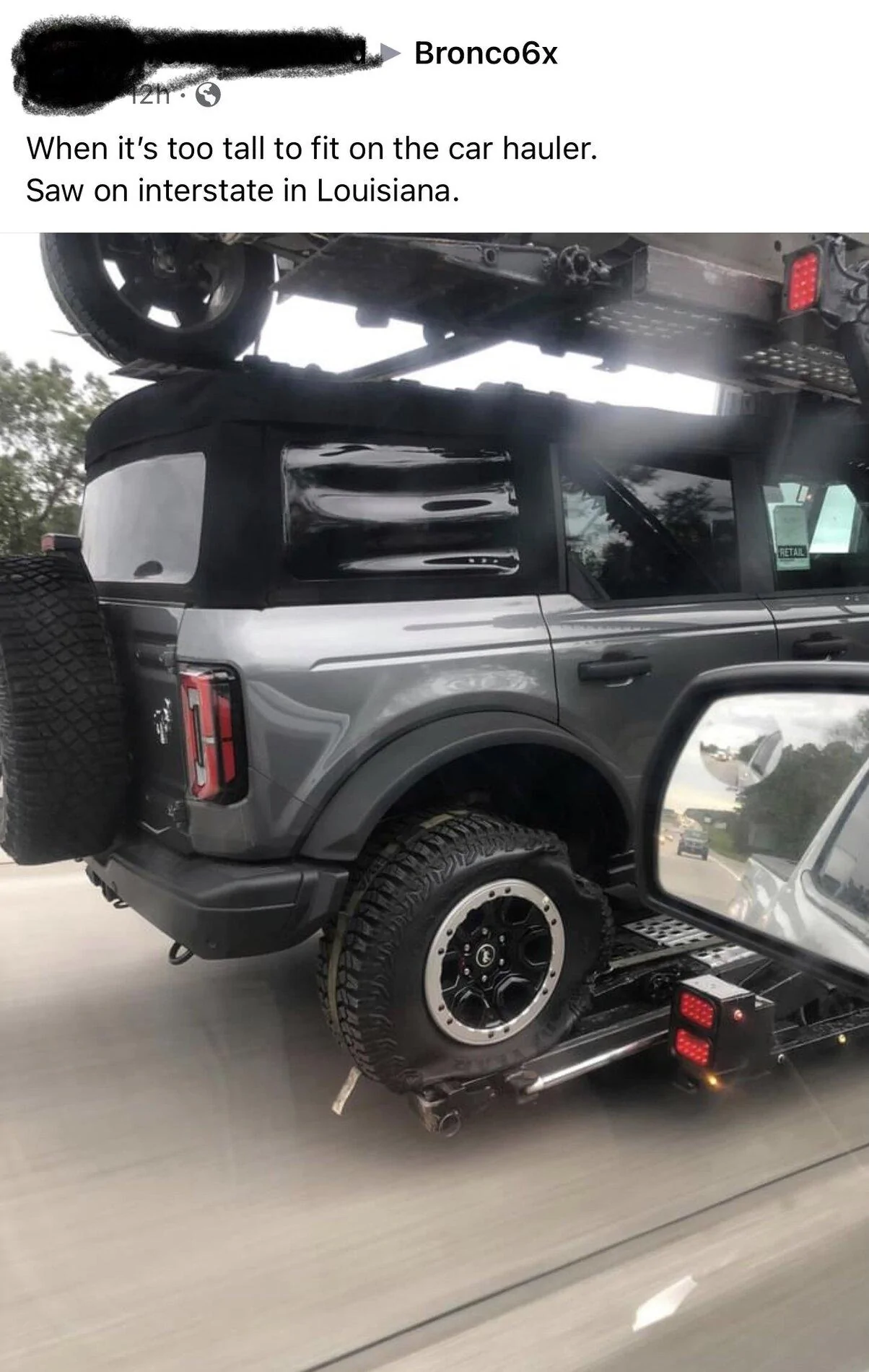

I strongly believe those GY Territory MT (max traction, not mud terrain) tires on the Sasquatch were chosen because Ford could strike a deal with GY for an “OEM spec” tire which would achieve the look of a 35” tire but still maintain best possible MPG by keeping the weight down. If they went with a more durable option, my guess is the real world MPG would drop significantly.
Those “35’s” weigh only 52 lbs and are C rated. For reference, a BFG KM3 in the same size weighs 75 lbs (E rated). That’s 92 lbs overall difference in rotational mass.
Ford also probably took into consideration that vast majority of Sasquatch package Broncos will never see actual off-road driving beyond an occasional gravel road. Just being realistic here. So the GY Territory is probably more than adequate for most people, and should in theory offer better fuel mileage than a more durable (and heavier) option with better sidewalls.
Also, some Broncos being transported like this probably doesn’t help with tire durability either:
Ford Bronco Goodyear Tire Punctures 1635730797018
Edit: I didn't take that picture, it's from a Facebook group.
