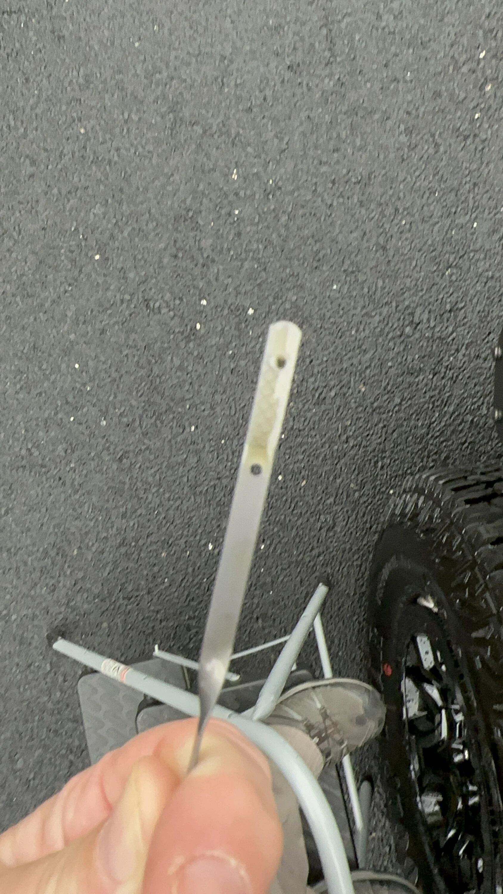

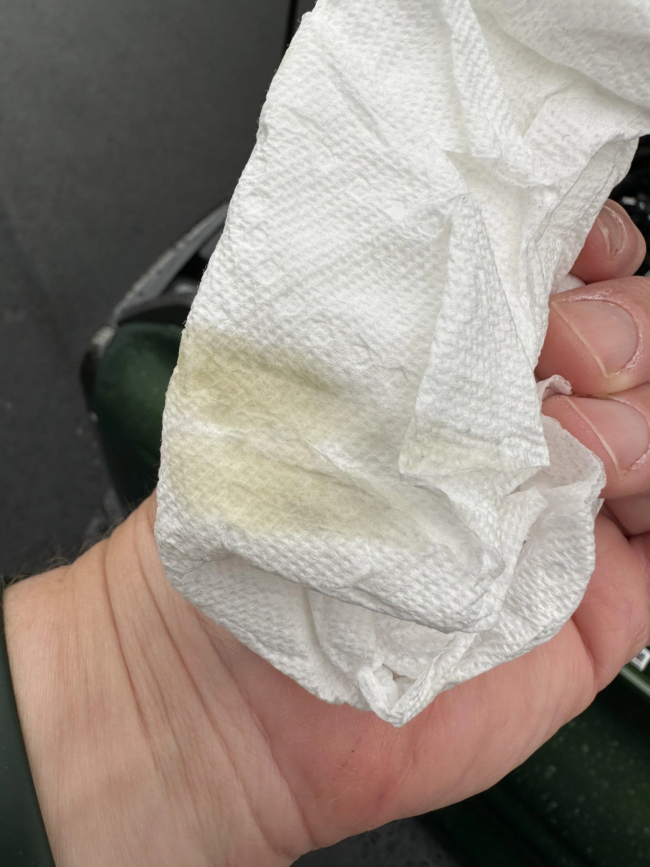

First thing I did at daylight. Doesnt look like anything on towel. Drove rough even for tow driver and dealer
There's your problem, or at least a symptom. The oil level (with 7.5 quart factory fill) should be at about your thumb, halfway up the twist. Factory shorted it about 2 quarts
JohnnyBronco
Sep 3, 2021
2,528
2,437
Pennsylania
X4
The top of the braid mark is full per the manual The dealer double checked me and its full.

And you are too new around here to have been exposed to the multiple dipsticks and is it 7 quarts or 6 for a proper oil change and that even with 6 quarts and supposed correct stick that from the factory the oil level would be partway up the twist. from that scenario your engine would appear to be oil starved - which as others have said can cause noise from under lubricated moving parts.
The cynic in me says drive it until it actually breaks but you are stuck now unable to drive it and any day without a Bronco is a bad day
da_jokker
125
6,173
7,134
Jeep Wrangler JKUR
Ok, hold on here. 6 qts of oil should put the lone right at the top hole/hash on either official dip stick.
Getting into the twist requires 7 qts (or the factory fill of 7.5 qts)
The shop the OP shows has his oil to the 2nd hole...this is correct per Ford's newest 6 qt revision.
As for the knocking..... Rod knock or possibly the torque converter bolts not tight and hitting. (Automatic yes?)
