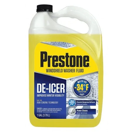

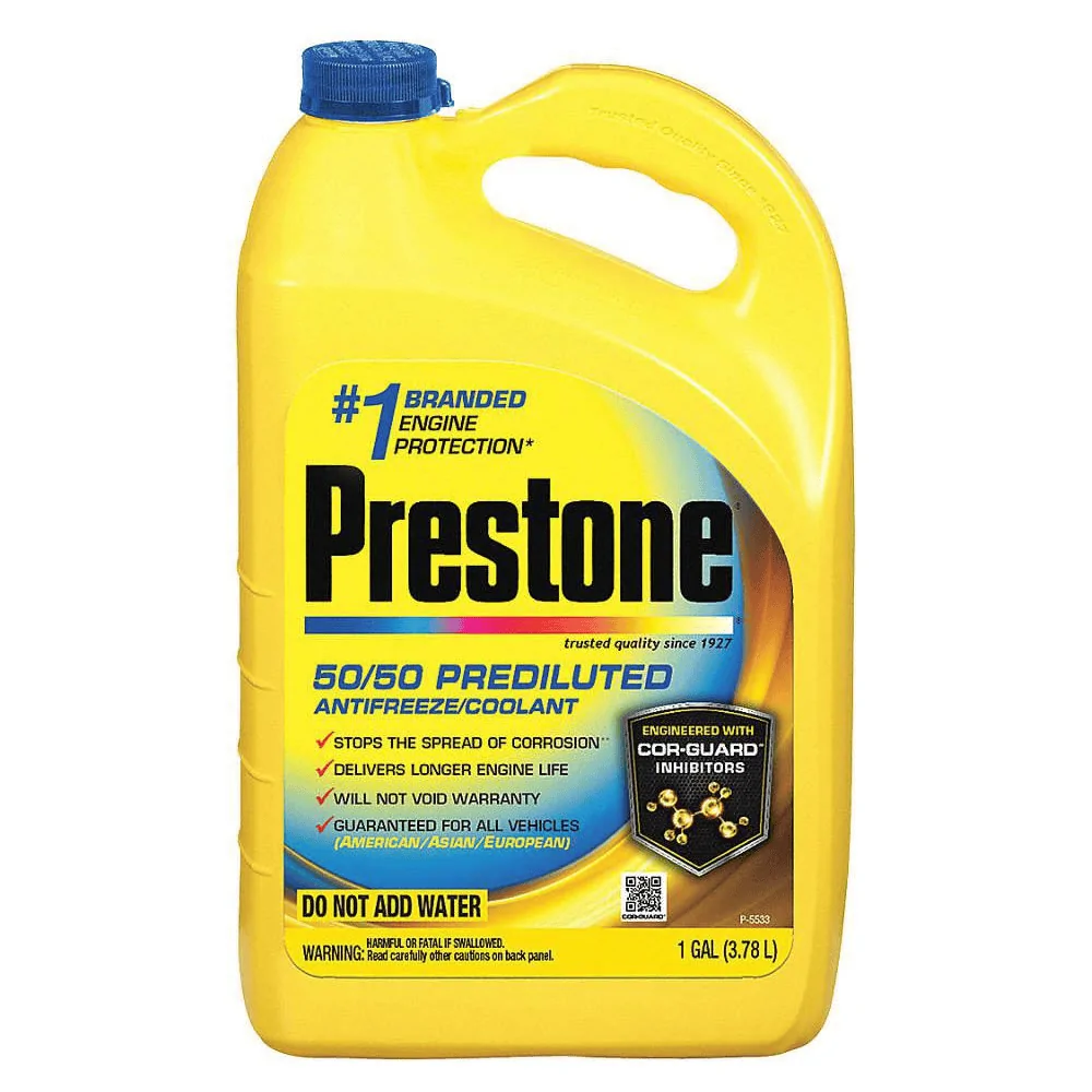

To be fair a casual, non-knowing person could be confused.
AF is no longer just green.
WF is no longer just blue.
DexCool and the orange "Antifreeze" washer fluid are close enough in color (and Prestone makes a version of both, pictured below) I can see someone who didn't take the time to check or felt anxious being out of their element making a simple mistake.
