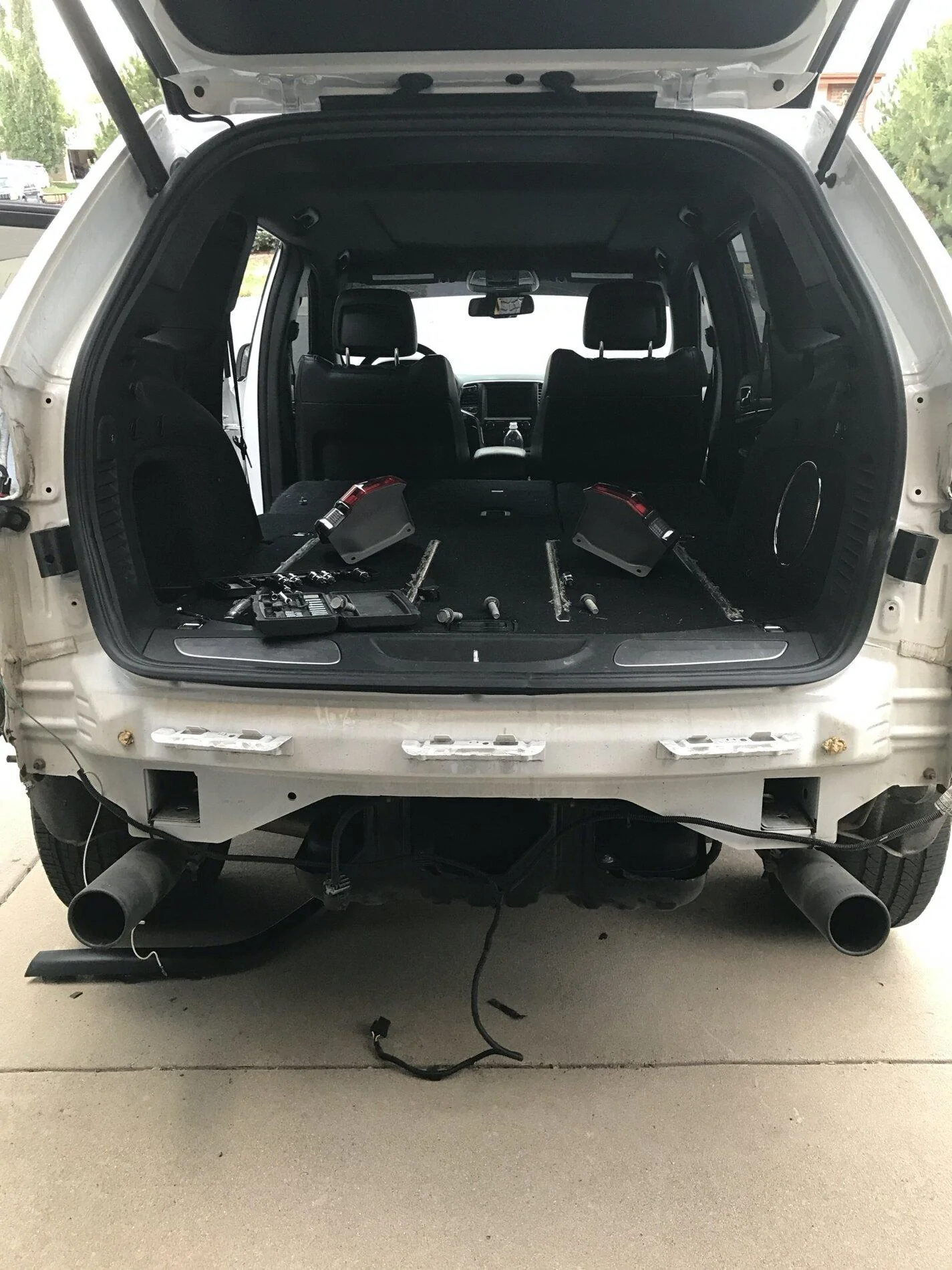

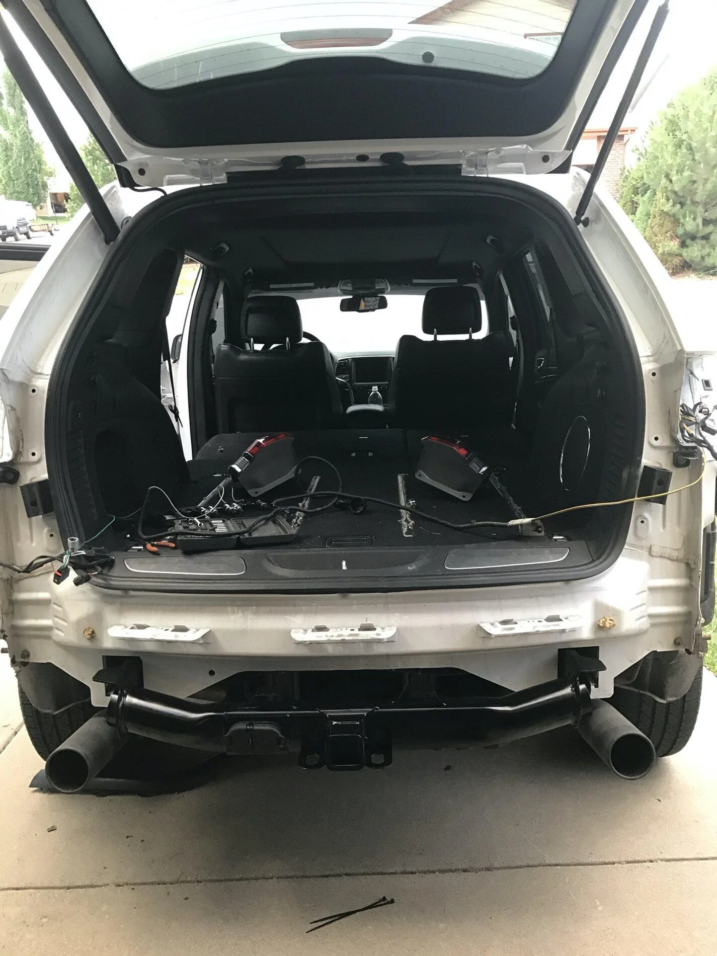

@LaminarThe way Ford has attached the rear receiver is weaker than the design you provided pictures of, where it is mounted to the frame rails. It is a weak way to do it. There are stronger ways to do it.
Why can’t ford mount it like jeep’s grand cherokee? I have an offroad camper that is extremely capable offroad, that I yank over bolders, last thing I want is a damaged rear crossmember. I would think they could still do it without losing departure angle.

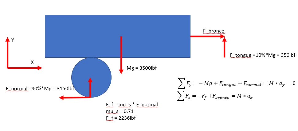

But let's say they are - if those are 3/8" grade 8 bolts, each of them has a minimum yield strength of 11,418lbs. Four of those bolts would give a yield strength of 45,672 lbs. In no way, shape, form, or universe does the Bronco have enough traction or power to create that kind of pull.
Just for kicks did a little dynamics. In order for the bronco to experience 45,000lbf it would have to be able accelerate from 0-60MPH with a fully loaded trailer in 0.2 seconds.
Assumptions:
1) No slip condition at the wheel
2) Coefficient of friction is = 0.71
3) 10% tongue weight
Ford Bronco Increased towing.? 1615926810267
Assumptions:
Is that trailer of uniform density?
