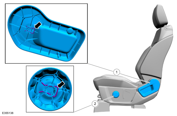

  1. Remove the front seat.
    Refer to: Front Seat (501-10A Front Seats, Removal and Installation).
  1. If equipped, adjust the front seat manual lumbar to the fully relaxed position.
Ford Bronco {thread} {filename}

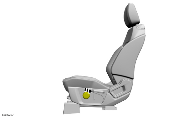

  1. Remove the front seat side shield screws.

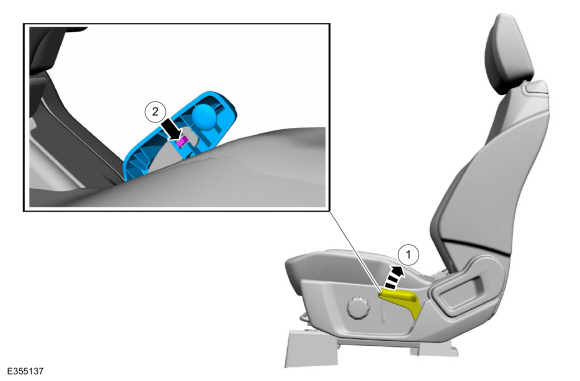

  1. Remove the front seat manual height adjusting handle cover.
    1. Lift up on the front seat adjusting handle.
    1. Release the retainer and remove the front seat manual height adjusting cover.
    1. Remove the retainer and the front seat recline adjusting handle.
    1. If equipped with manual adjusting lumbar.
      Remove the retainer and the front seat lumbar adjusting handle.

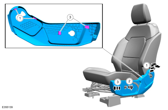

  1. Remove the front seat side shield.
    1. Firmly grasp the front seat side shield, lift up and out separating the front seat side shield from the recliner bracket.
      Pull the front seat side shield over the front seat manual lumbar adjuster.
    1. Slide the front seat side shield forward.

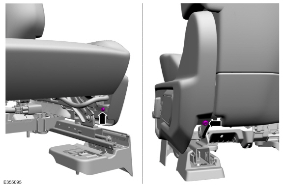

  1. Detach the front seat electrical connector retainer and position the wiring harness aside.
