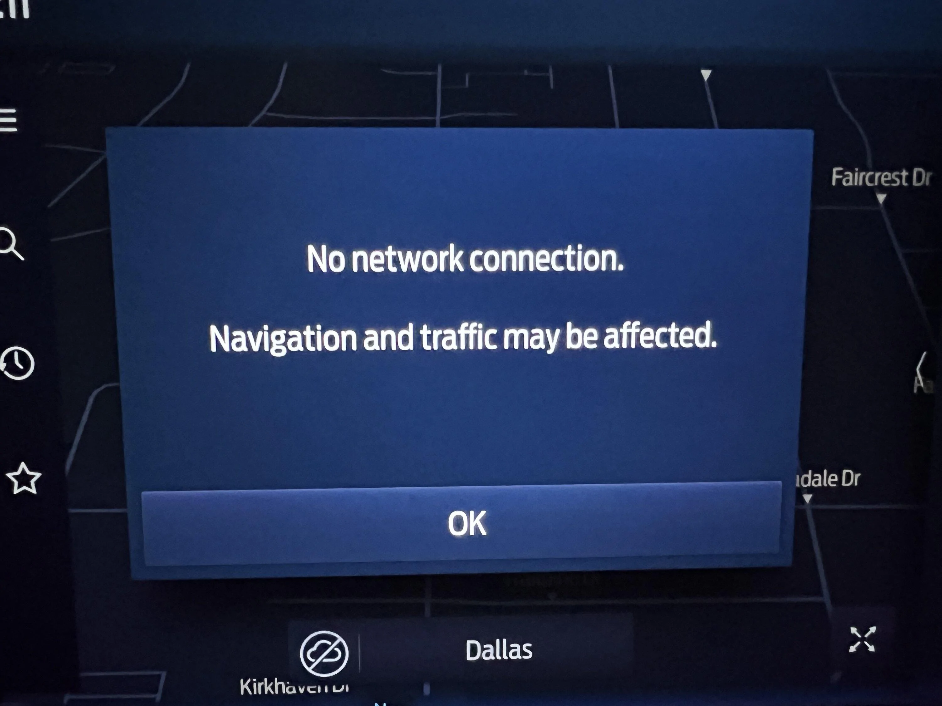

This just started a couple days ago. I get this error when I start the car. Also, ford pass stopped connecting at the same time, so no auto start. Carplay still works fine through my phone.
Same! Got the same message yesterday, although the message stopped appearing on startup. I can't get to the menu to turn the modem off. Maps work, but no remote start.

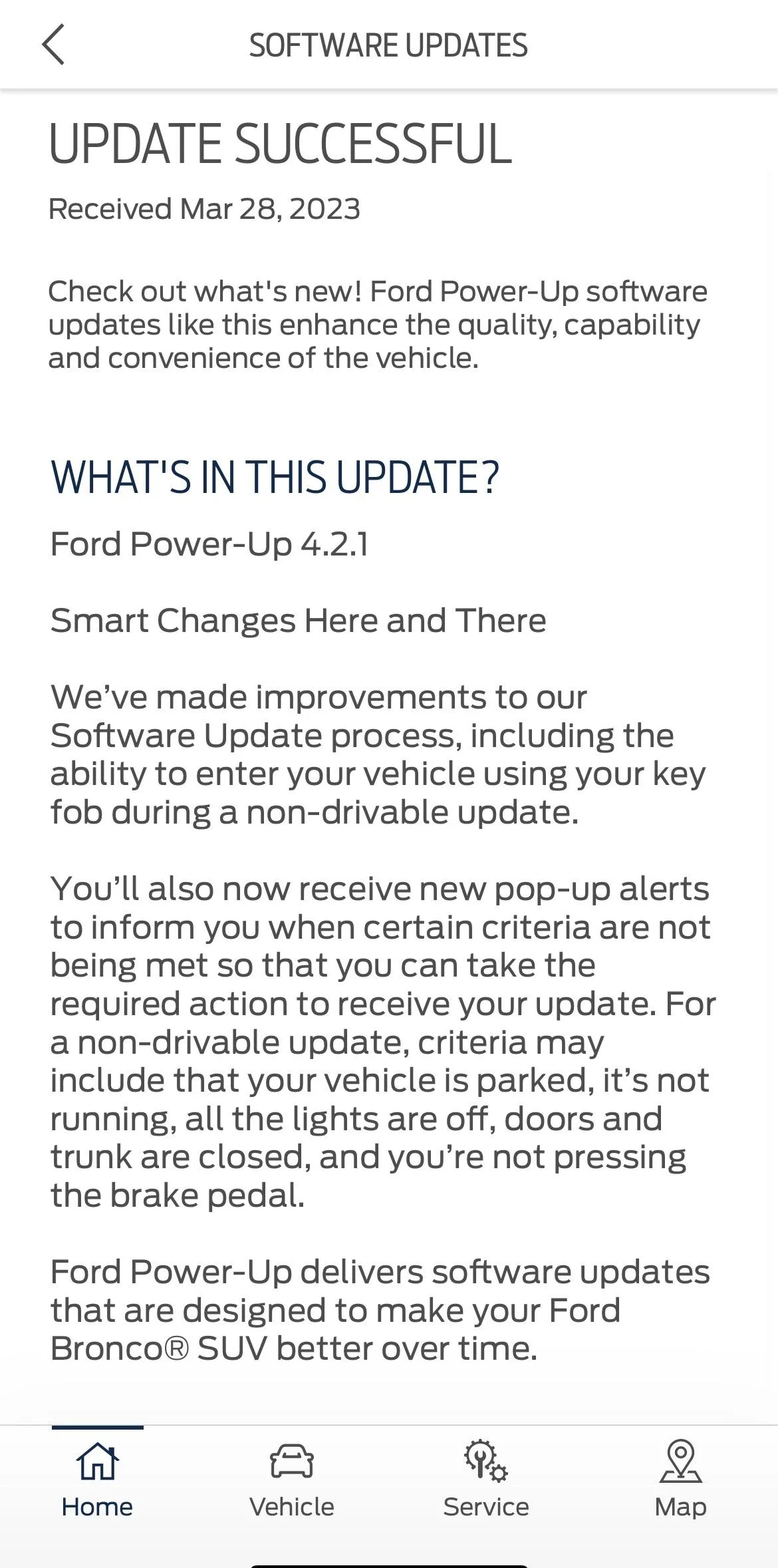

Here's an update y'all (March 28, 2023) I received the update (4.2.1), Modem is working again!
See screenshot:
