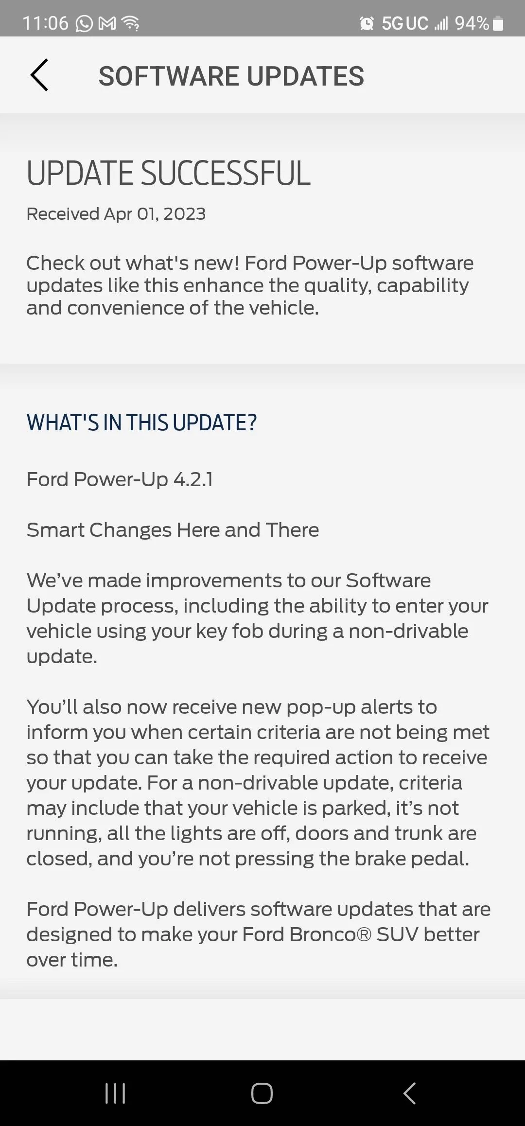

Just got the same update. Looks good so far.
Ford Bronco No network connection error Screenshot_20230401_110643_FordPass
