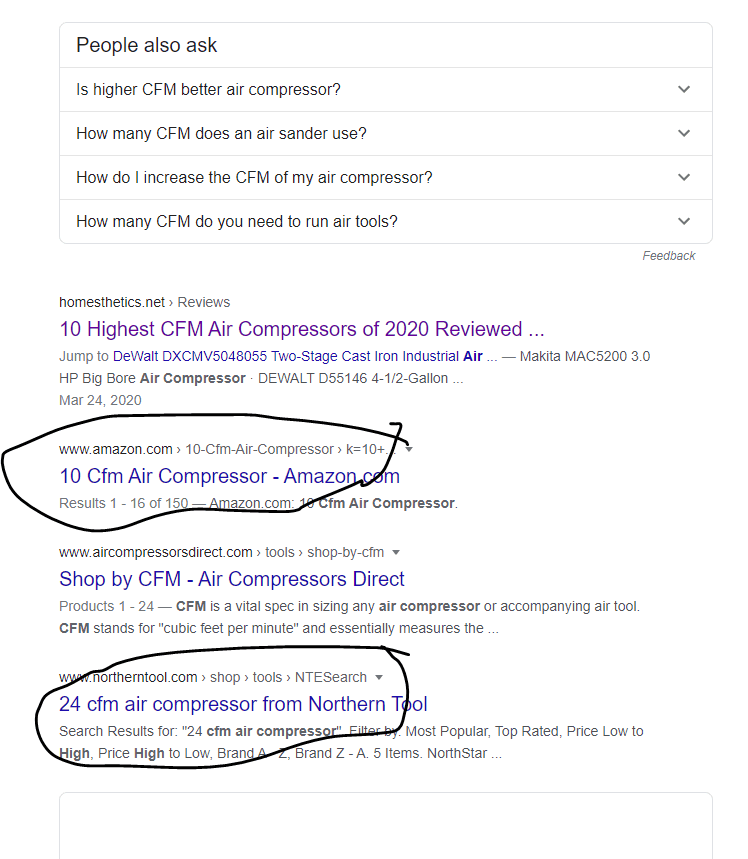

what comes up when i search high cfm air pump on google:
https://www.amazon.com/VIAIR-40043-400P-Portable-Compressor/dp/B000X9AXR8/
https://www.amazon.com/ARB-CKMTA12-Board-Performance-Compressor/dp/B0050DI9YQ
Viair has a bunch of different models and they rate them based on tire size so it's pretty easy to comparison shop on https://www.viaircorp.com/compressors
I ran the Viair 400H (hard mount version of the one linked above) in my Xterra for years without a hiccup. Filled my 34" tires and a friends 33" tires in one go.
