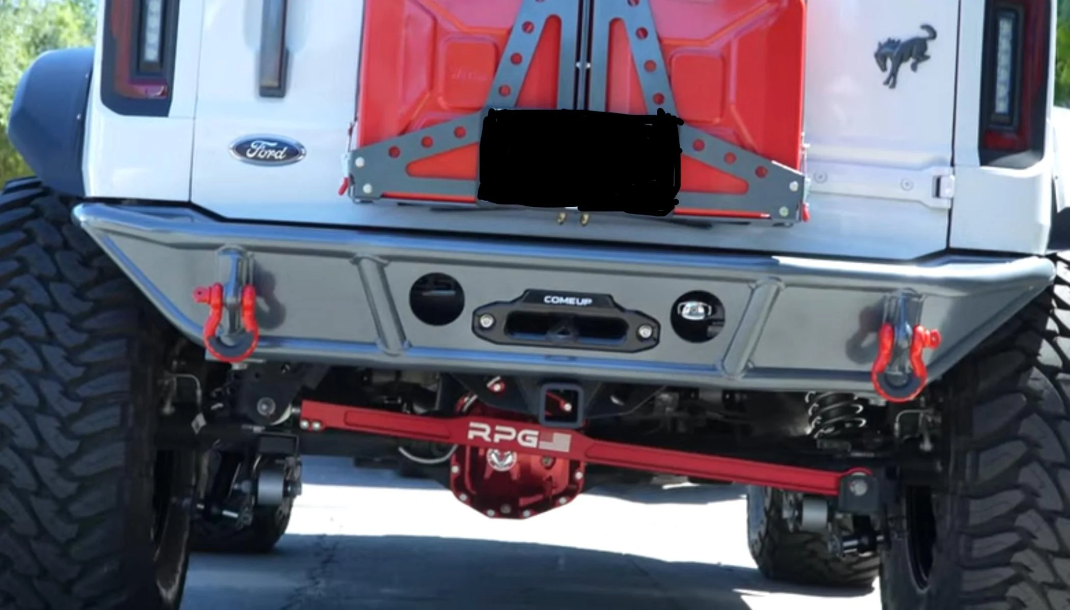

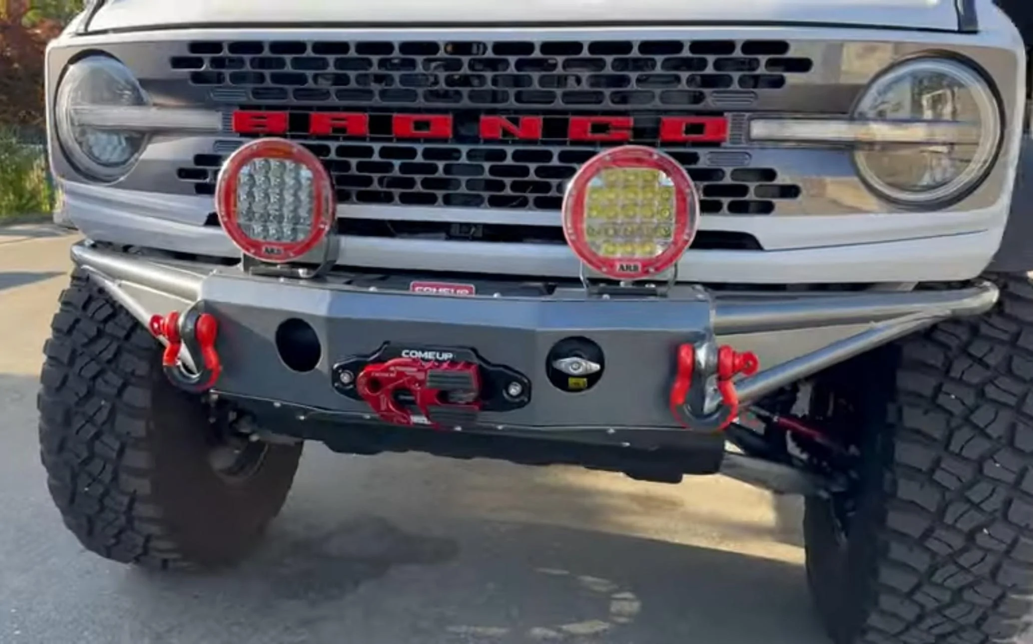

Not sure if the owner is on this forum but I stumbled onto this via YouTube. Since then, saw him post a couple times in some FB groups.
He did custom fab and bumpers and ran ComeUp winches.
Tried linking the videos but they are now private. Short version they too had to cut and fabricate the frame so it was supported. StellarBuilt in CA did the fab work.
I frickin love that setup. I haz the jealousy
Me too, me too. 😂
I talked with Stellar. They were willing to do another but I had to drop my Bronco (approx 2,000 miles from me) and work was by the hour. It’s all custom and intricate stuff. The front included a skid plate and also custom mounts for crash bar removal.
*Approximate* estimates shared with me put both bumpers as shown in the $9-10k range. Had the wife bought in, but distance was the deal killer for us. And I couldn’t find a local shop with skills or time to tackle this project.
