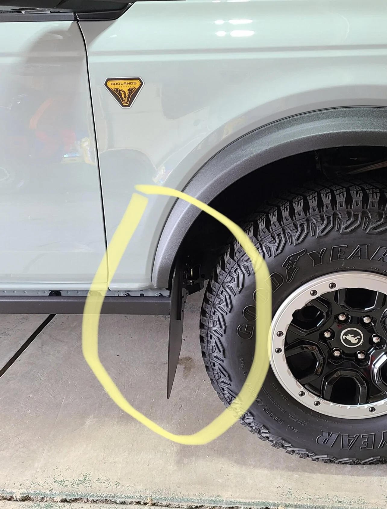

Honest question. How can they be high quality if they’re paper thin like this? The equally overpriced ford ones at least look sturdy and robust:
It’s the type of material they use. These are a touch over ⅛” thick and more of a hard plastic.
The factory flaps on my superduty are 1/16” thick and more rubbery.. the factory flaps only look thicker due to the 3d style mold.
I had rokblokz on my raptor and they took a beating getting smashed on rocks, yet rebounded and still looked new. A factory flap would still be on the trail.

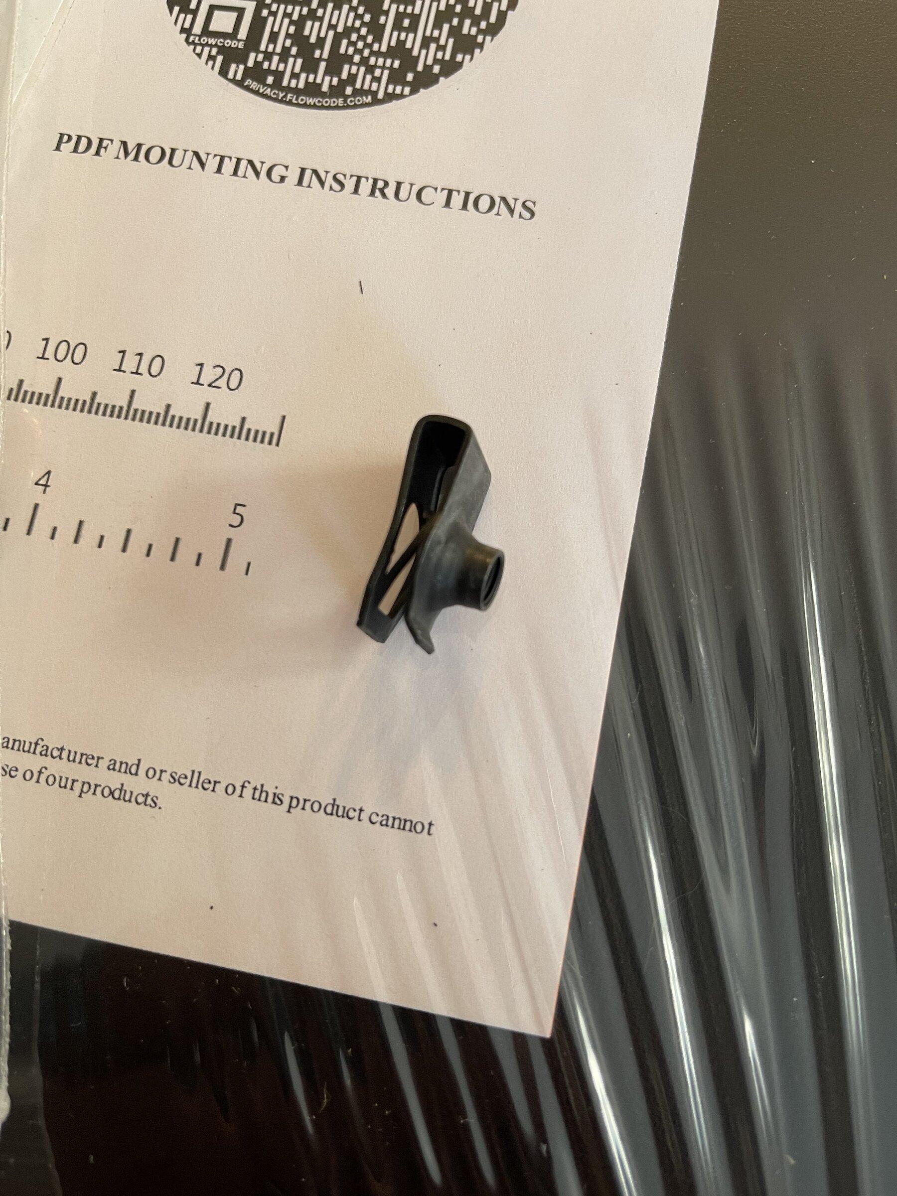

Playing with the clips more, it’s not just the length, but the diameter/thickness of the nut insert side of the clip too.
You could use your own hardware to “make it work”, but it’s best to wait for the correct clip as the nut insert is tapered for a reason (wedges into the flap).

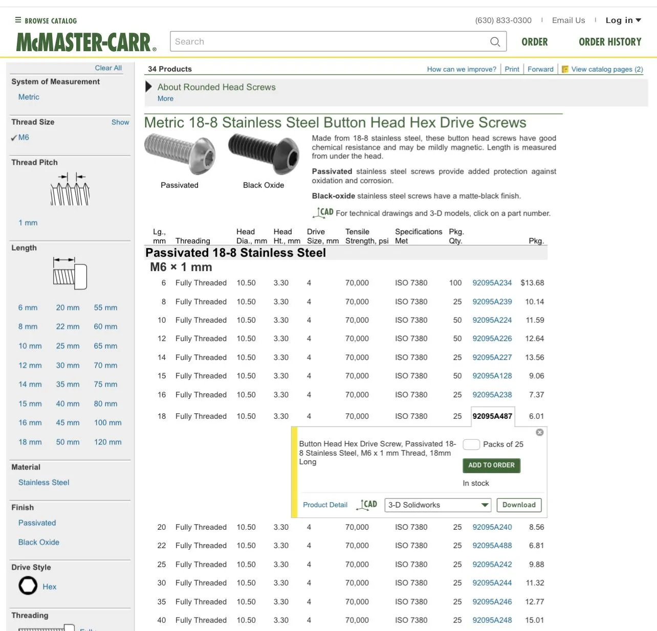

I'd be interested in the size of the hardware I'll need to buy to switch from the quick release screws to the allen head screws. I don't need QD flaps, and don't want some douche stealing them because they come off easily.

The thumb screws can easily be swapped with a button head hex screw.

To our Bronco owners,
It has recently come to our attention that there may be a slight hardware issue with the Bronco kit, specifically affecting the front flaps. We received a batch of clips for our new Bronco kit and unfortunately, there is a very slight difference in the new clips vs the old clips which is causing there to be some play and a little wiggling on the front flaps. The issues were not present during testing and we truly apologize for the mix-up. We are currently in the process of correcting the issue and will be reaching out to provide solutions for anyone affected. All kits being sent out from this point forward will be corrected. Please reach out to us if you have any questions or concerns, we appreciate your patience, understanding and feedback. If you are experiencing this please email us directly at [email protected].
