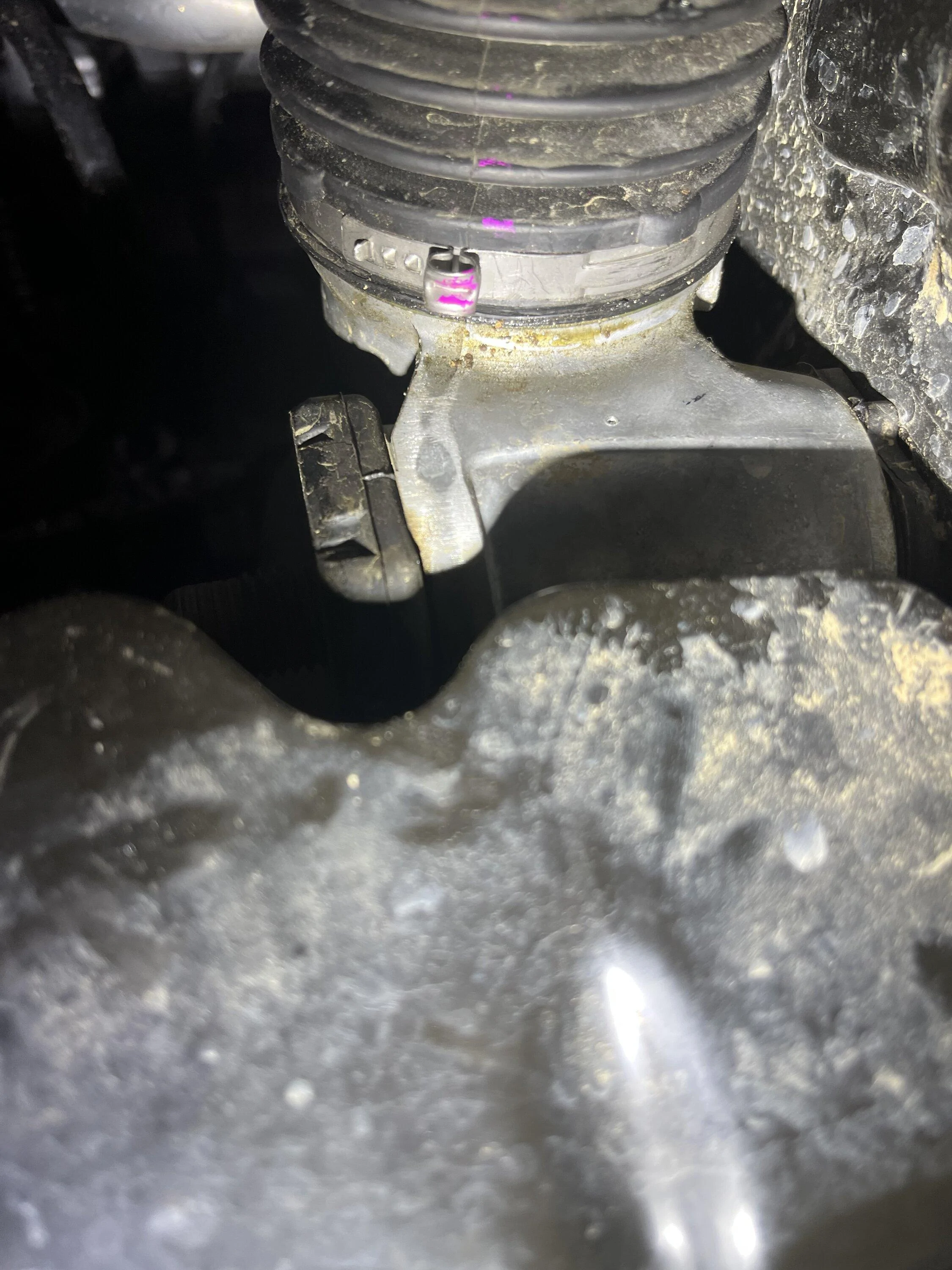

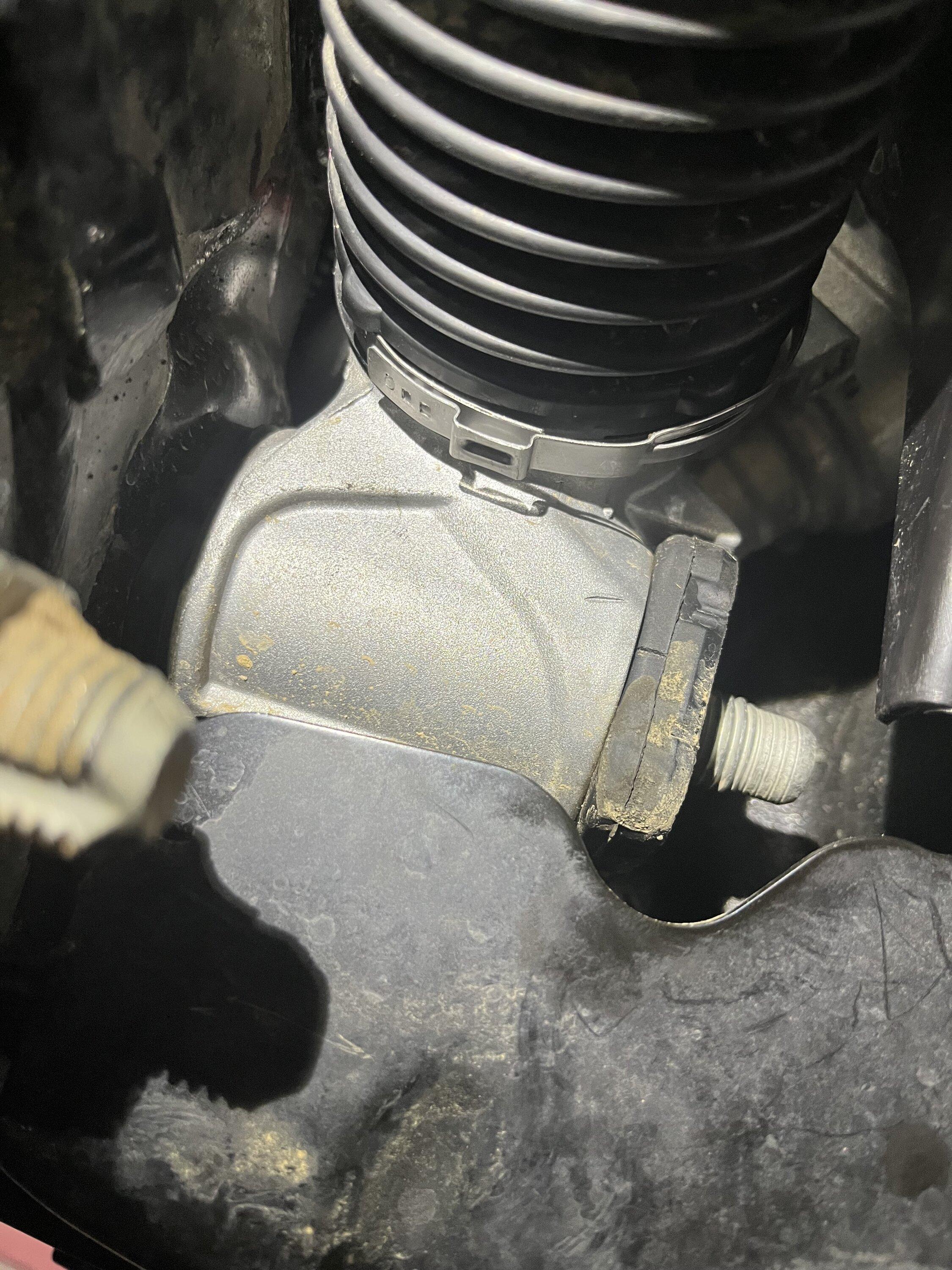

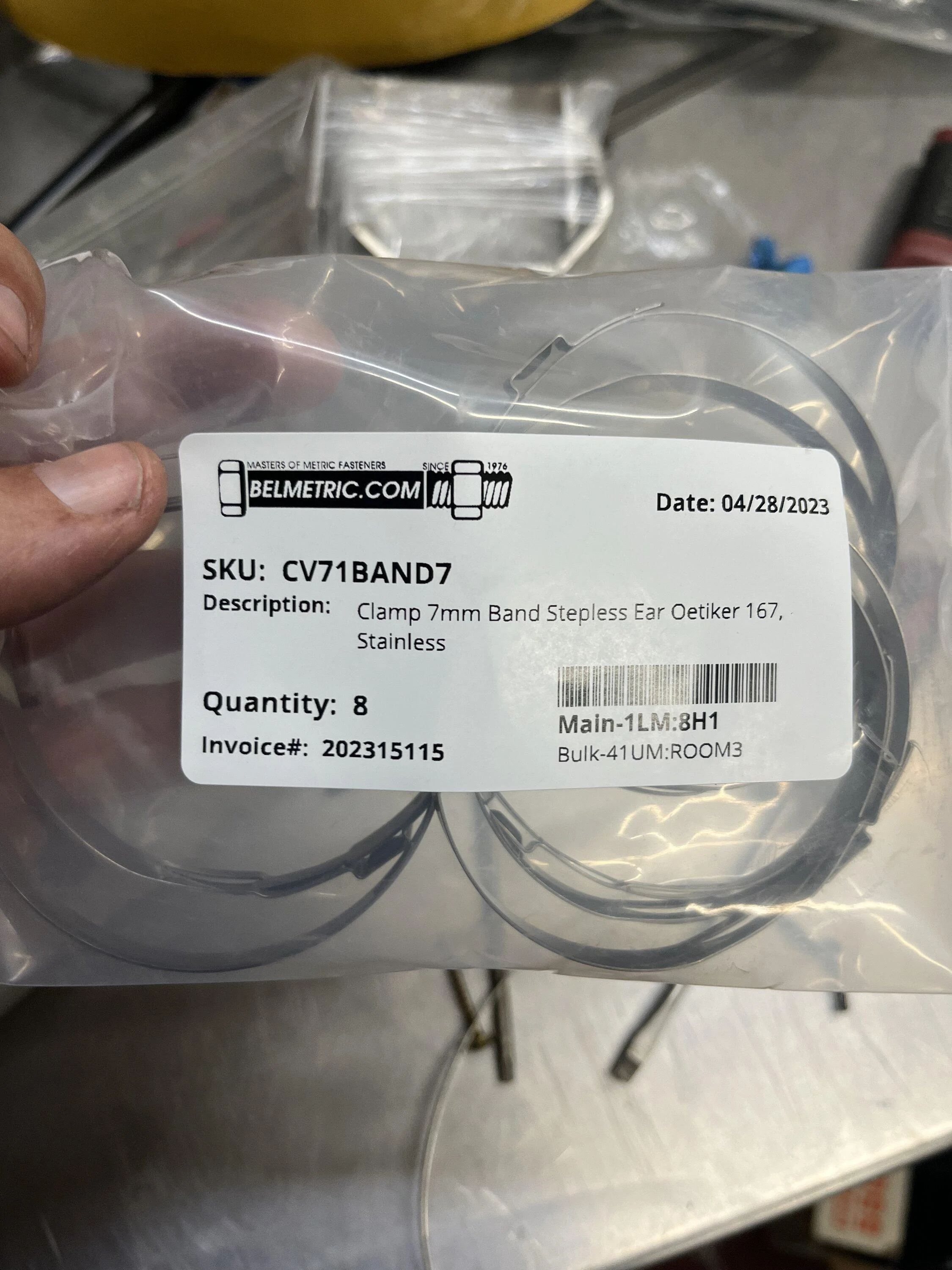

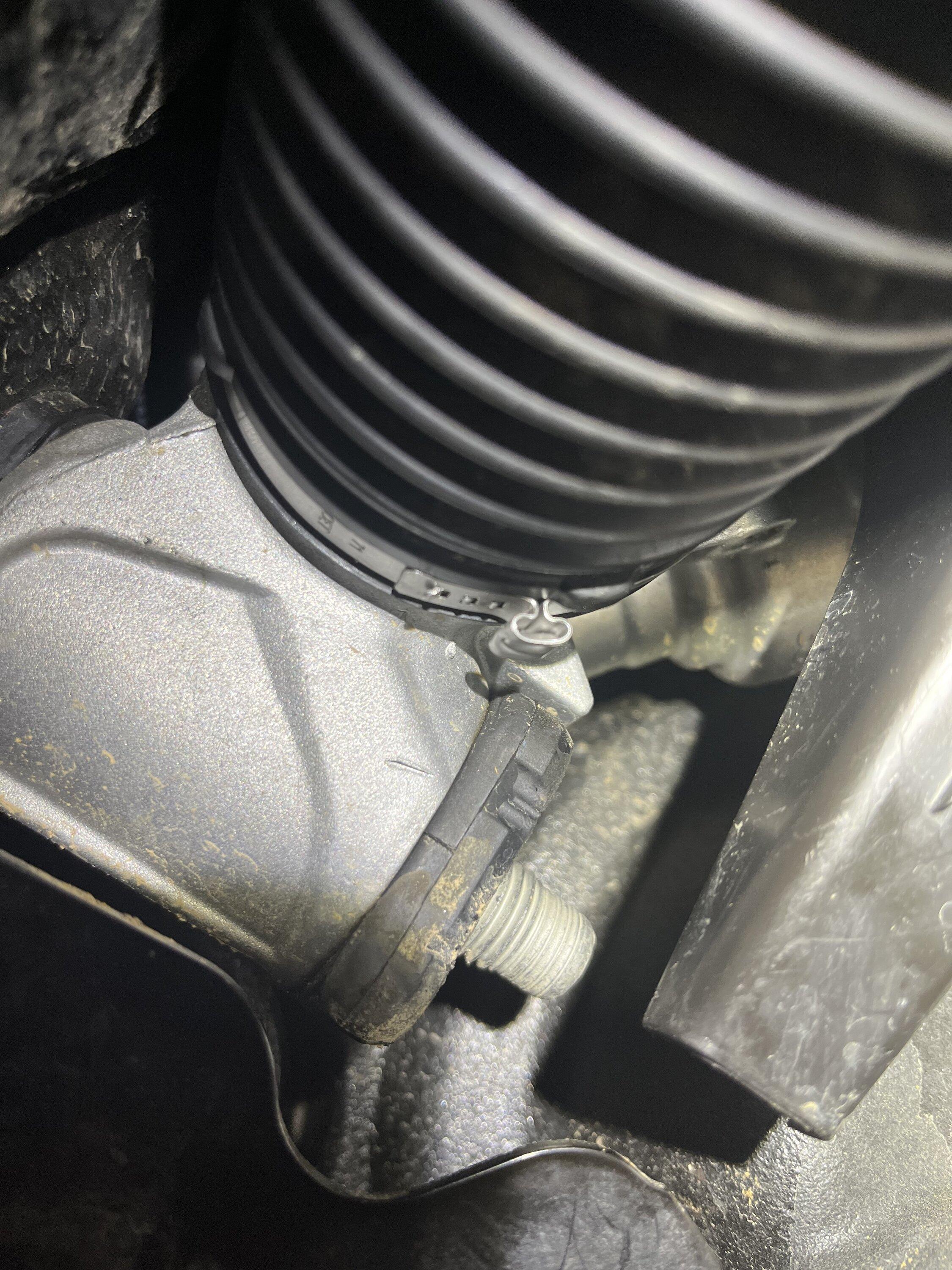

1 bel metric I posted earlier work fine
First three photos are the bag, pre and post crimp
Last photo is old one I took off and RECRIMPED
