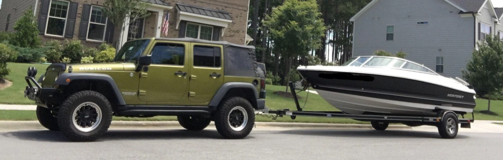

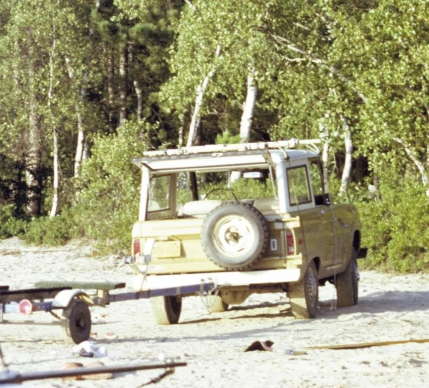

Example: My trailer has a GVWR of 5200 lbs with a max load of 4000 lbs. So assuming the trailer is 1200 lbs, plus the boat dry weight of 3100 lbs, throw in 36 gals of gas, a full yeti and miscellaneous life jackets and gear and it is probably 3500 lbs. So I am currently towing an estimated 4700 lbs with a measured 470 lbs tongue weight on a vehicle rated for 3500/350. Since the "braked capacity" of the same vehicle in Australia is 2300kg (or 5070 lbs) and the trailer has surge brakes, I figure I am fine. Especially if it is just me and the dog in the Jeep as the Max GCWR is 9200 and the '08 JKUR is 4180. To over compensate, I did:
- put heavy ARB OME springs in back, and Air Lift helpers
- put on bigger brake discs front and rear
- convert the trailer surge drums to discs
(I could swap out the factory class II hitch for a class III rated at 4500/675. Since it bolts into the same 4 holes, I am not sure there is a real material difference though.)
Sure, I'd rather have a Yukon or Gladiator for long trips, but the rig trails pretty well, and stops fine to and from the lake. Yet my ground clearance is 14" when the Rubi is 10.5" stock.
So yes - early Broncos were used for towing, Jeeps are now, AND offroad recreation other time.
Ford Bronco Tow capacity will keep me from switching... Boats_038
Ford Bronco Tow capacity will keep me from switching... IMG_6143
Some of us (as our nest empties) want a smaller / enclosed swiss army knife of a vehicle.And so, I am really hoping for 5000 for piece of mind, but I will probably tow it anyway at 3500.

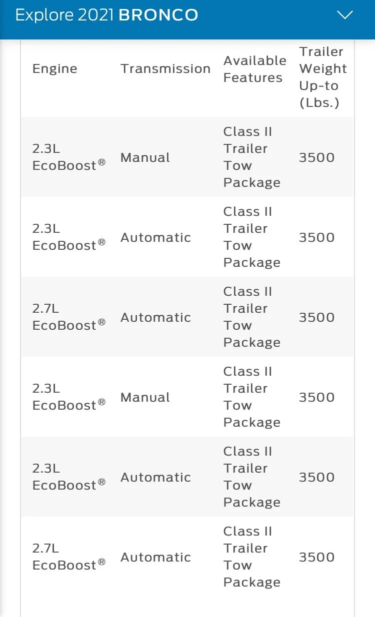

I find it weird no matter 2-door or 4-door, engine size, and auto or manual its rated to 3500 lbs. It sounds like Ford really limited the rating on the class II hitch receiver. I really hope these are just place holders and they do further testing since they offer a tow capability package.

I have been doing some soul searching and after talking with a friend, he said that there’s no way it will only tow 3500lbs in V6/auto/4 door. Or if it’s only rated for that, there may just be one specific criteria that it can’t pass past 3500 lbs. He said to buy it and if it needs bags or anything you can always add that to tow more, but honestly I’m going to be towing my crawler maybe 5 or 6 times a year. Will probably just end up doing that, but honestly I still don’t believe the 3500 tow rating. Makes no sense that it’s the same regardless of wheelbase/engine/trans.
Not nearly as well. Half the articulation rating. 60% the suspension travel. Heavier longer wheelbase. All those add up pretty quick to help rating.
I’ve also heard that the removable top is the reason why the lower toe rating. Due to some stupid NHTSA rule about convertibles
