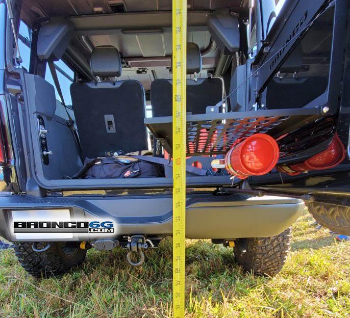

The photo that HobGoblin took looks like the hitch is right around 24” on a badland with 33s.

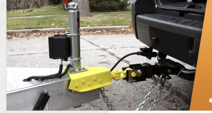

You could also consider using a lock an roll hitch, it’s better for off road anyway.
Thanks for the pics. The pic showing the 24" hitch height - on the right you see the spare on the swingout tailgate. I would not be able to hook up with the tailgate closed and the spare on with the 6" rise hitch needed for my trailer.
Rise hitch is needed because the rear WILL squat no matter how much I try to strengthen the rear suspension. 400lb tongue weight does that. Have to get proper balance between trailer and tow vehicle for offroading with a 4000lb trailer.
I'm probably expecting too much. I guess there is a good reason why trucks with spare tires mounted on the tailgate don't tow.

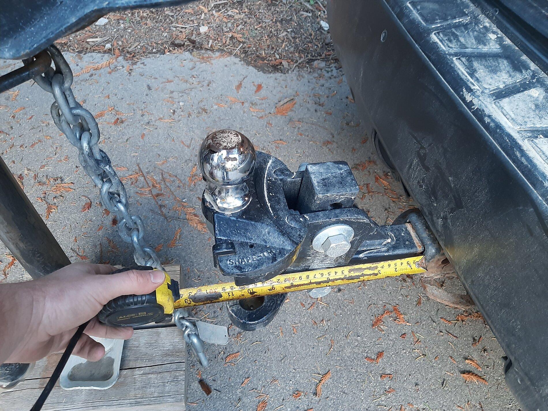

Our WDH sticks out about 11" from the back of the receiver to the middle of the ball and rises a similar amount. It sure looks like a long way but a 285mm tire is a little thicker so yeah this would be a problem.
Yea my current one sits even closer than that I think, almost no shank shows between the hitch and the bumper , that’s why I said depends on the brand. But it’s still usually a bit further than a standard hitch. Not sure what brands my 2 brother-in-laws have, but they both stick out a whole lot more than mine, one enough that I hit by shin on the hitch with the tailgate down before. Pretty certain that one would clear a tire.
Also, think yours might actually be closer to clearing than you think. It’s 11in past the bumper, the spare sits a couple inches inside the bumper since it’s attached to the tailgate. But the receiver looks to be very slightly in from the bumper on the bronco too so idk. Be close still, but might have the hitch past the spare. Course that could be a wash anyways if the bit before the actual hitch sticks up too far and hits the spare, but looks like enough gap there so maybe. Who knows, might just have to take the spare off in the end if you do need a rise.
