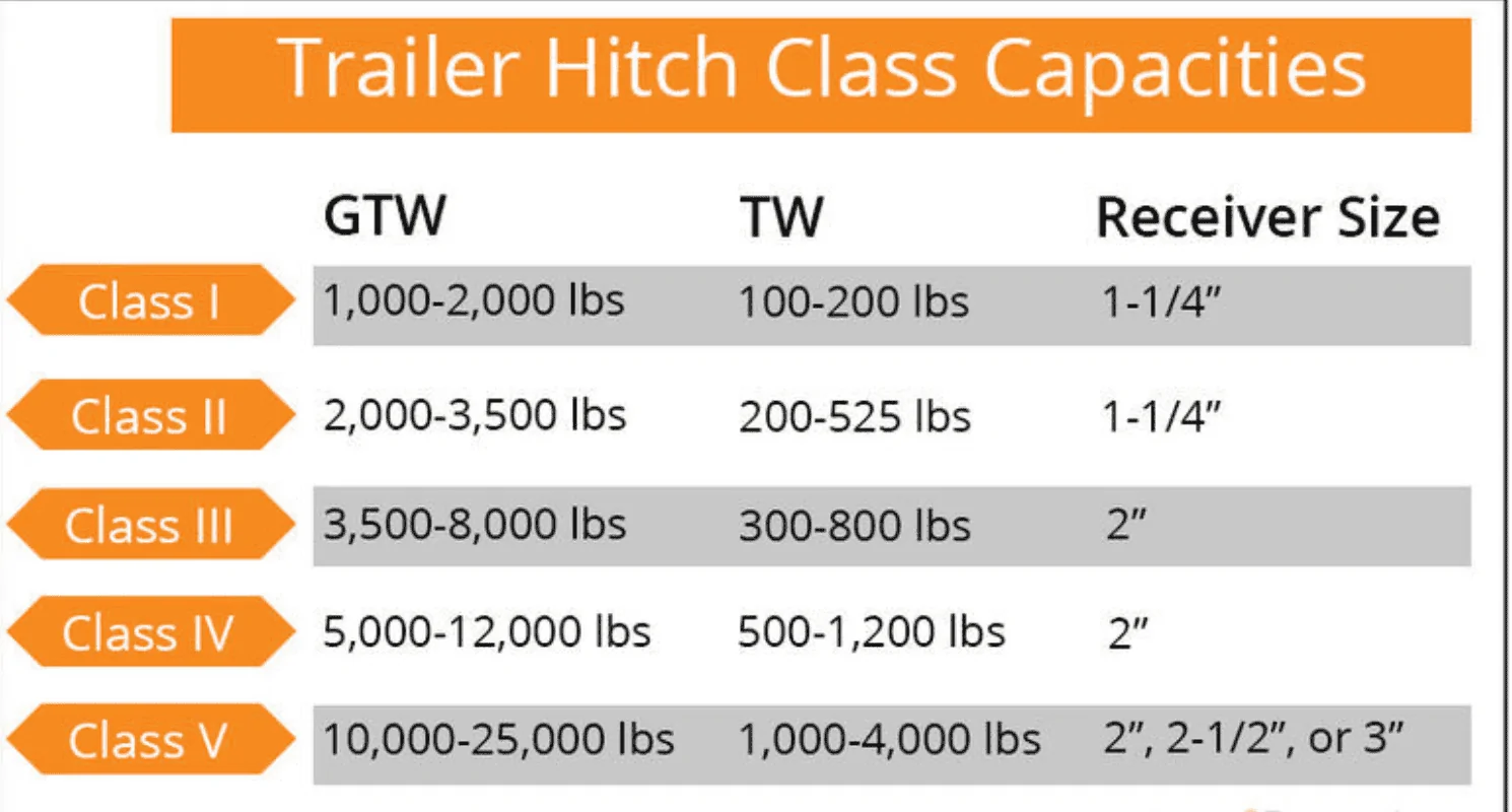

1. In Ford’s specs (go to one of the trim’s “explore this model” pages, expand the specifications sub-menu, scroll to “Towing”) you’ll see “class II” explicitly typed.
https://www.ford.com/suvs/bronco/2021/models/bronco-badlands/
2. On curt’s website, a class II hitch gets a 1-¼” receiver, a class III gets a 2”. Apparently people are finding class II’s with 2” receivers but i’m not finding those.
https://www.curtmfg.com/types-trailer-hitches
Also worth noting, a class III can be capped at 3500lbs:
https://www.etrailer.com/Trailer-Hitch/Toyota/RAV4/2012/e98864.html?VehicleID=201269753
It’s funny, because they sell a class II hitch with the same rating, only real difference is the smaller receiver size.
3. Class II’s are capped at 3500lbs which conveniently adds to the case for it being a class II.
4. there could be an error on the b&p, the hitch could be more stout than we think... but at the end of the day... we have this info as fact: you have 3500lbs to work with and the receiver is 2”.
End of argument.
now to the OP: just get the tow package. You pay extra on the front end. But you have it from day 1 and the wiring is well-protected (huge deal if you live in a crappy climate or actually plan to wheel this thing).
if you do decide that you really want to save that $300 on your $50k toy, then make sure you bolt your hitch on with the right torque. I’ve installed 3 different hitches on 3 different vehicles (class 2, 3, and 4) and I’ll be buying the factory option every time it’s available.

The Bronco specification is Class II. Class II is
Class II200-350 lbs2,000 - 3,500 lbs
Maybe Ford specs a class III hitch, but it seems more likely to me it is a Class II. I can find lots of examples of class II 2” receivers. I am suggesting, based on the OP question, that you may be able to get a known class III hitch in the aftermarket for a similar or less expensive price. Personally, I would be cautious on using a winch, which would likely need to be rated at 6k minimum to safely recover the Bronco, using a class II rated receiver. Probably fine. To say all recovery points or all 2” receivers are able to support recovery of the entire weight of the vehicle, seems naive. But I was just adding my perception of value to aftermarket vs. factory price. Personally, I am adding my own, I felt the price was too high and knowing I have a class III is a benefit in my mind. It’s$95 more than the Ranger for some reason 😧
