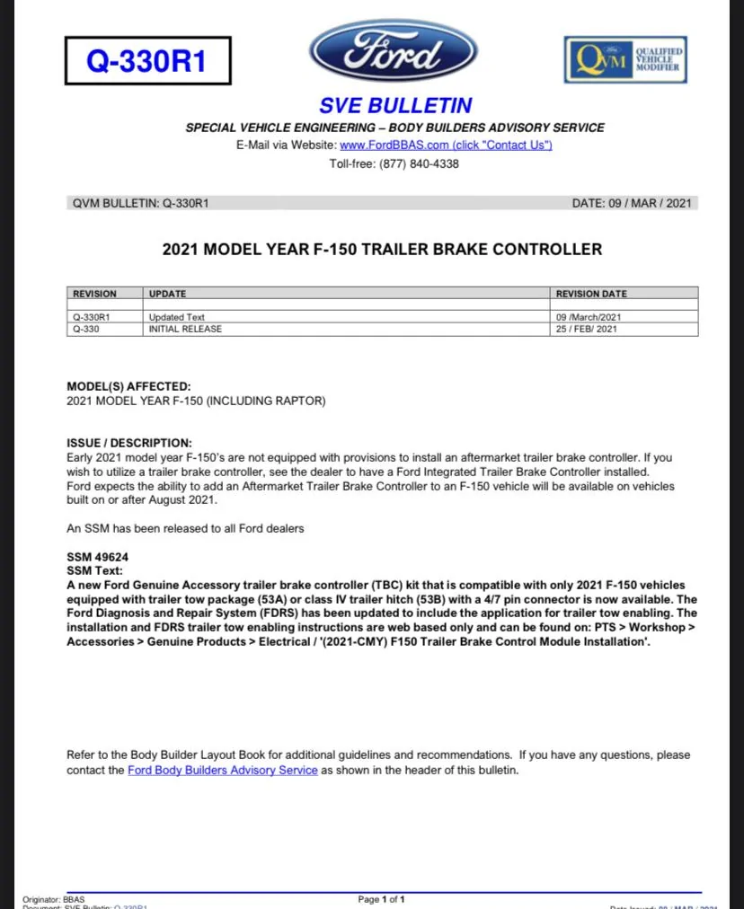

If I’ve learned anything about Ford, they punish you later for not checking the box for the factory option. Look at those who don’t order a factory hardtop and want to add one later. No defrost and washer fluid connections. There was a bulletin about 2021 F150s ordered without factory brake controllers are not able to add an aftermarket brake controller. They’re working to fix it, but those who already bought and thought they could add one later are only able to buy the OEM controller.

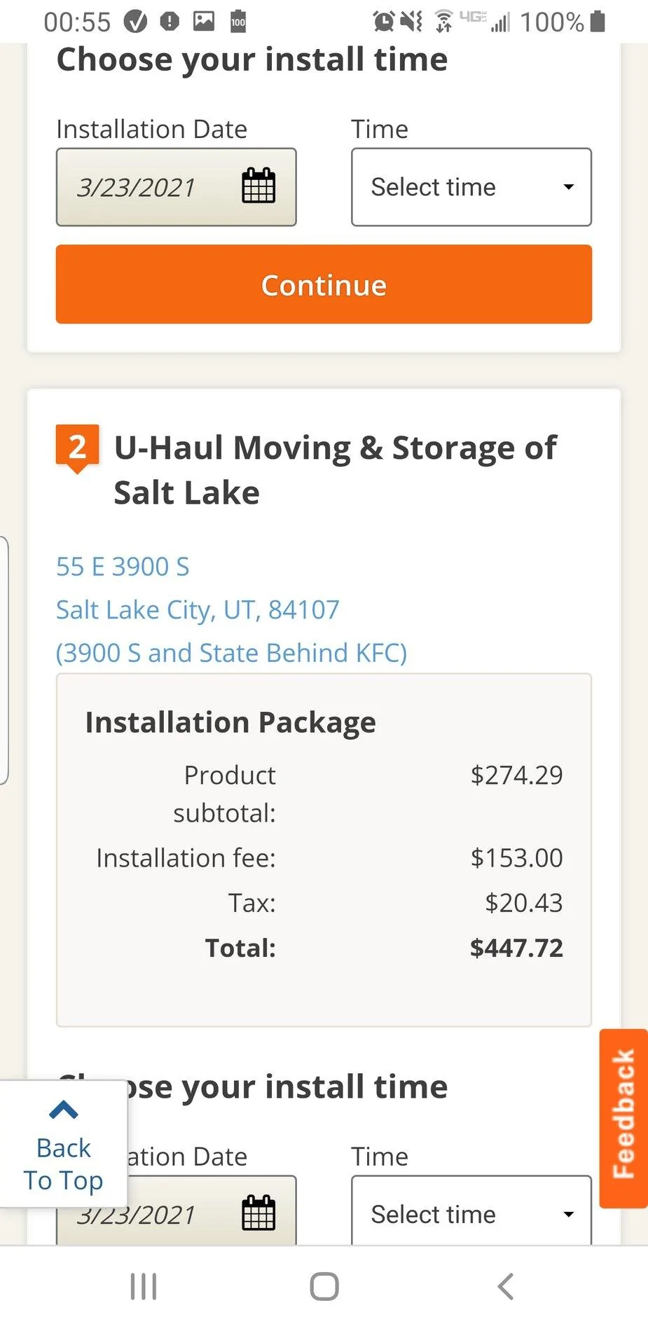

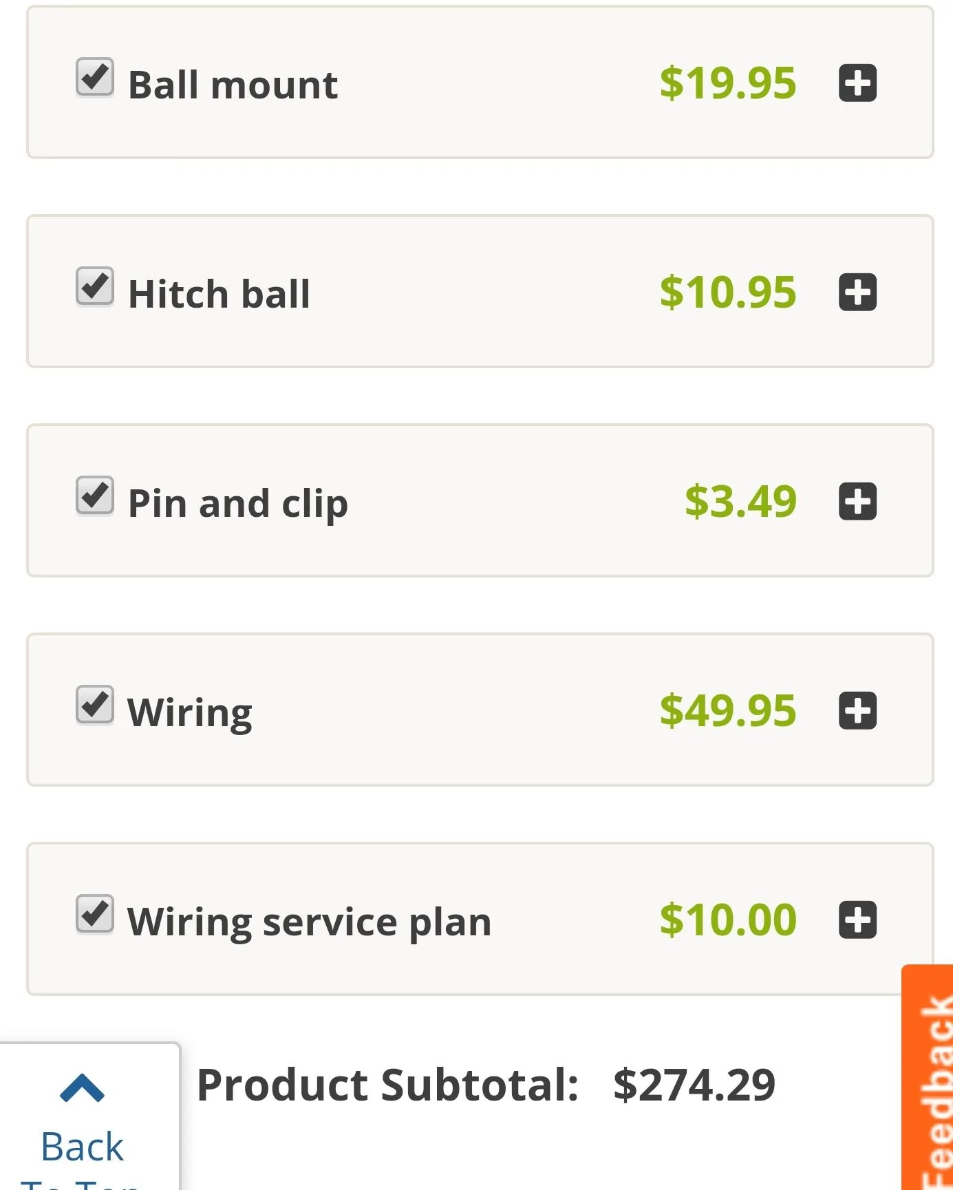

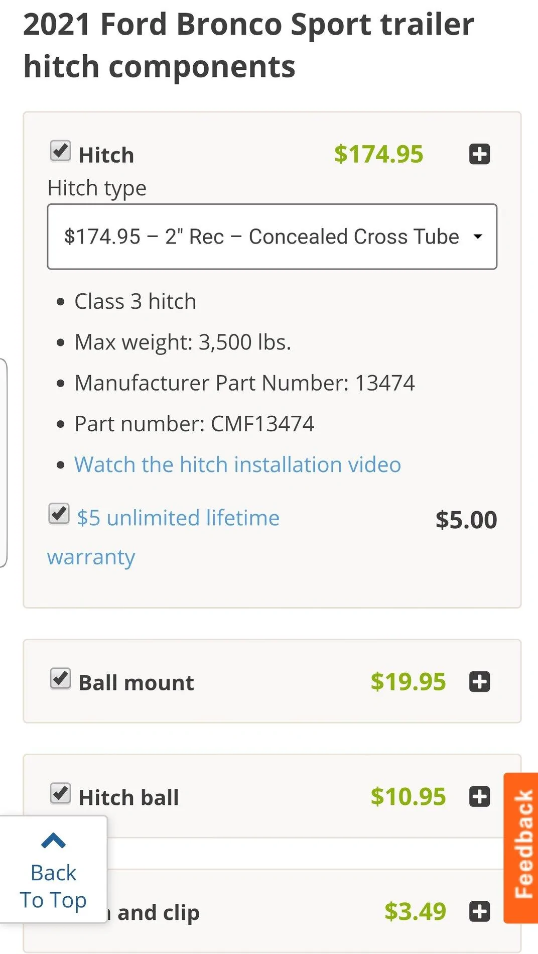

I just priced out installing a hitch at UHAUL in Salt Lake City.
on a 2021 Bronco sport. The on line quote is for a "Class III" hitch with. 2inch reciever. Parts total is $274. Install with UHAUL warranty is $447. Savings of about 150 from Ford.
That being said, I am getting the factory tow package from ford. Their warranty, already complete day 1, no headache and time needed from me.
