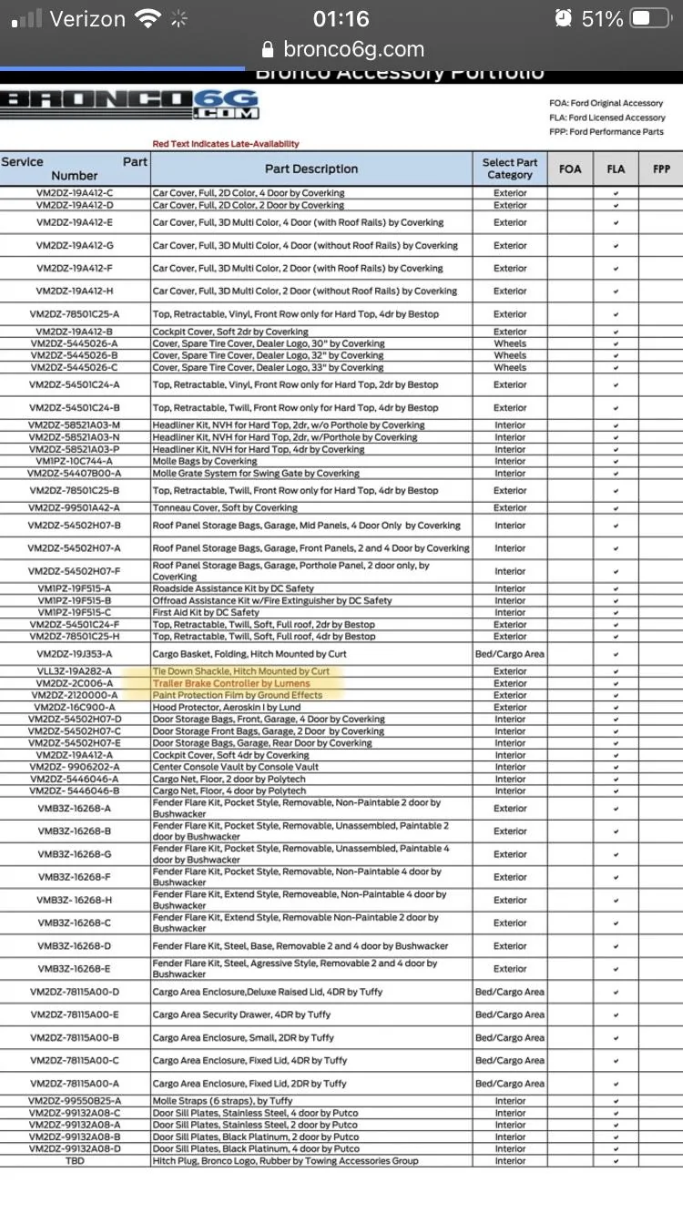

600 bucks seems kinda cheap compared to the accessories involved afterwards.

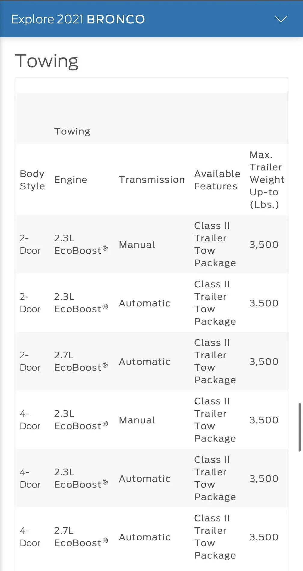

It's a 2" receiver so it's a class III hitch. There's a lot more that goes into a vehicles tow rating than the hitch strength. A class III will take up to 8000lbs towing weight. I'd venture an occasional recovery from it would be fine at 10k.
Can you provide a reference for that? That would be an extreme departure from pretty standardized class system for hitches.
There's a big difference between the hitch rating and the vehicle tow rating. But I really don't care enough to convince you of that so feel free to believe whatever you like. ✌
Legit question.
Is your position that because it’s a 2”, the Ford equipped receiver on the Bronco is a Class III?
And there’s no way it’s just a Class II receiver with a 2” like is found on the Wrangler?
Because that’s a bold and significant claim.

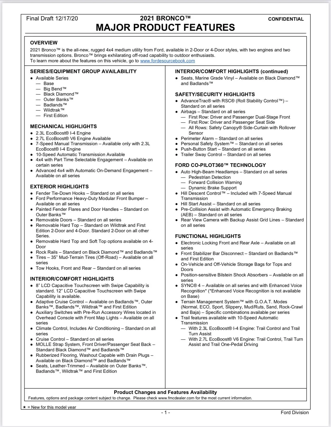

The question is do we get trailer sway control with the tow package. If yes it’s well worth it.
I ordered it because wired from the factory and ready to roll is what I want. For reference went after market for the wife’s suv, they did a great job but it still wasn’t factory.
Congratulations on ordering, it’s a great feeling when you get the email from Ford acknowledging the order.
Trailer Sway Control is standard on all trims. Not tied to tow package.
Even Base has it (which can’t even be optioned with tow from the factory).

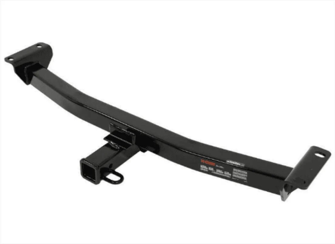

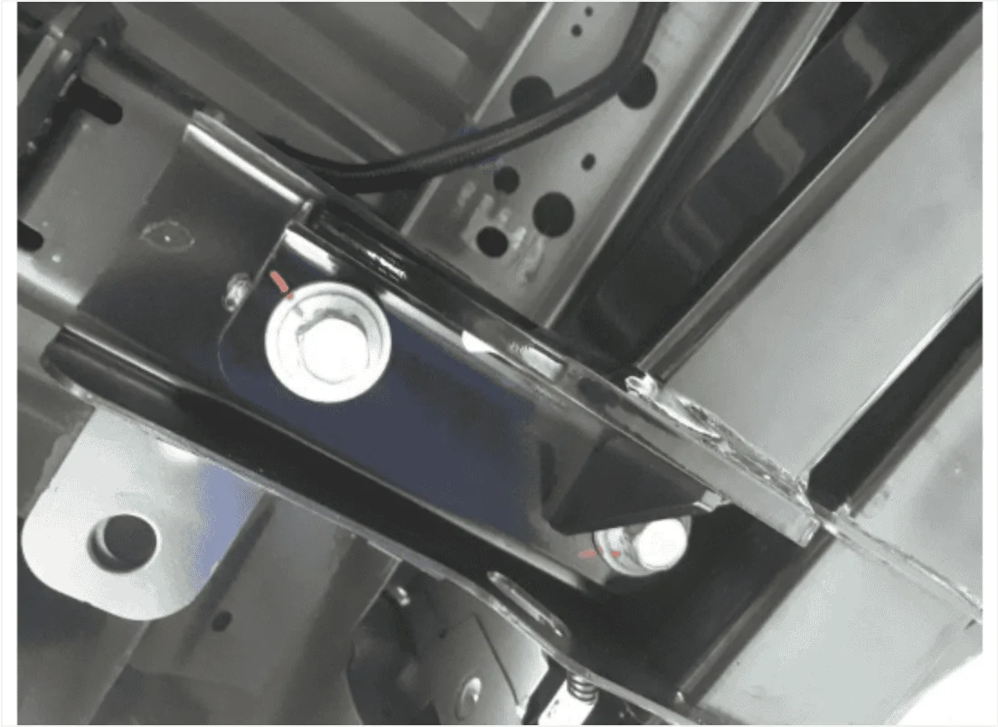

Interestingly, that is where some Ranger Class III hitches bolt on.
Seems like that combination could, maybe, possibly, support a 5,000 lbs tow rating [INSERT LEGAL DISCLAIMER HERE]. The structural stress on the frame rails vs the crossmember should be much better.
Coming soon, the all new, upgraded tow rating for the 2022 Bronco. :ROFLMAO:
