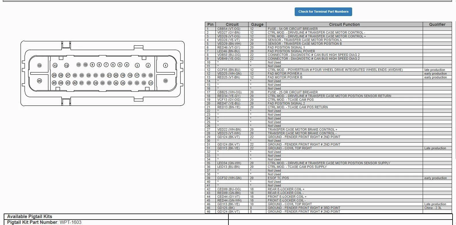

@mpeugeot do you happened to have the wiring pin out for the all-wheel drive control module on the 2.7 with the advanced transfer case?
I do but I am currently traveling, I won't be back until 20 April or so to get a copy out. Just landed in Manila again.

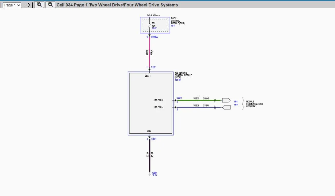

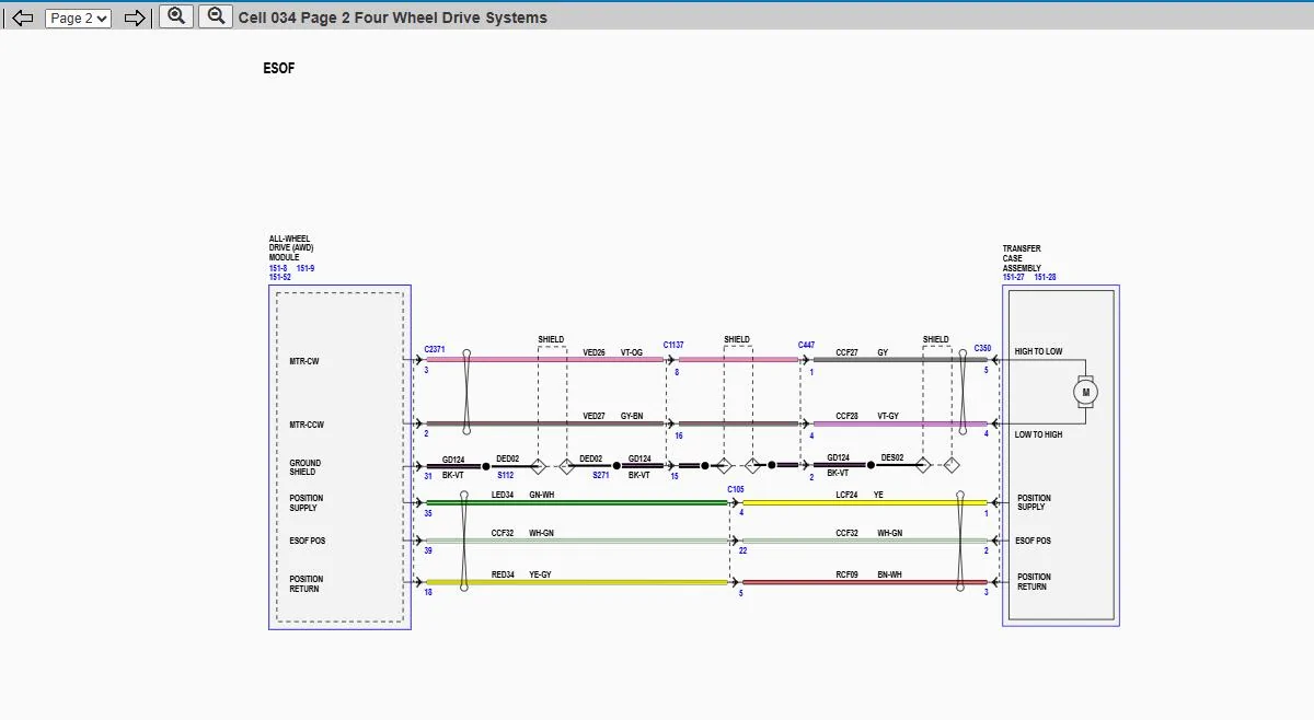

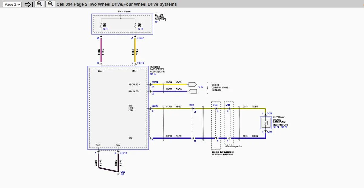

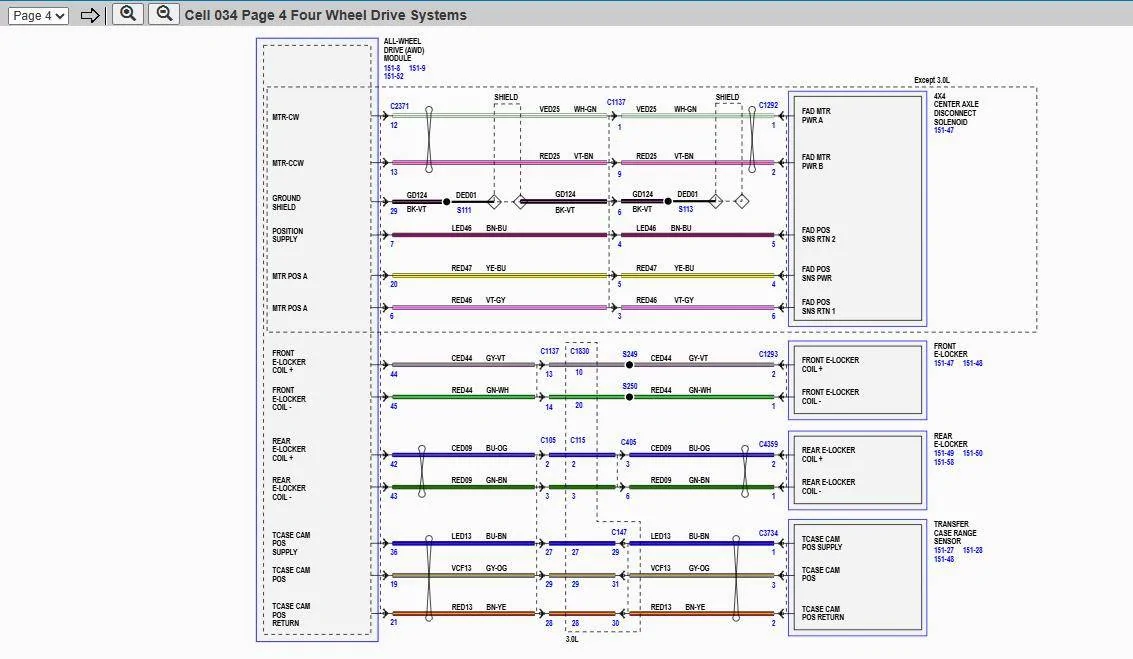

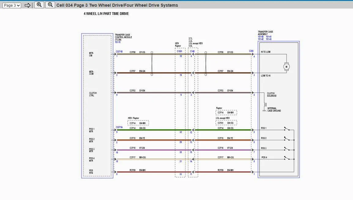

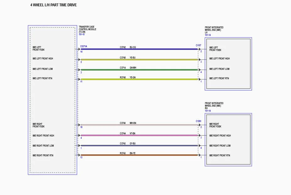

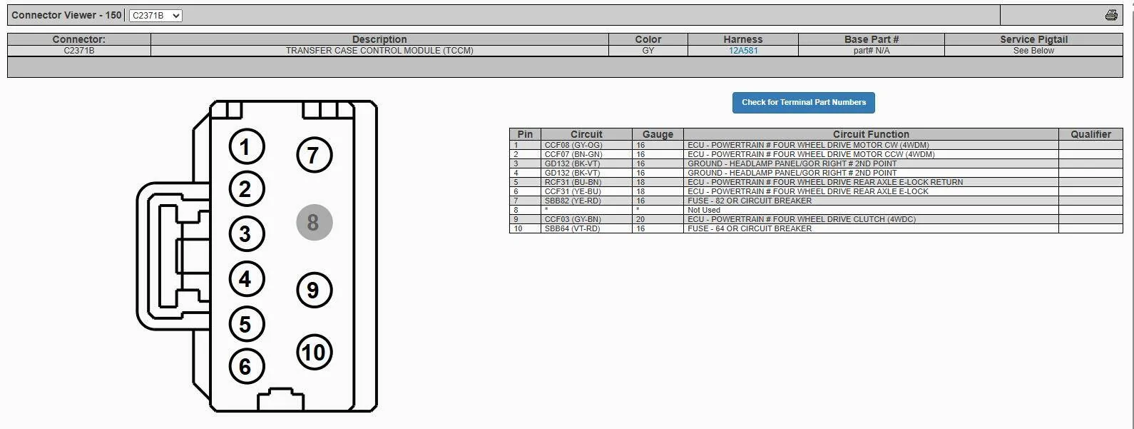

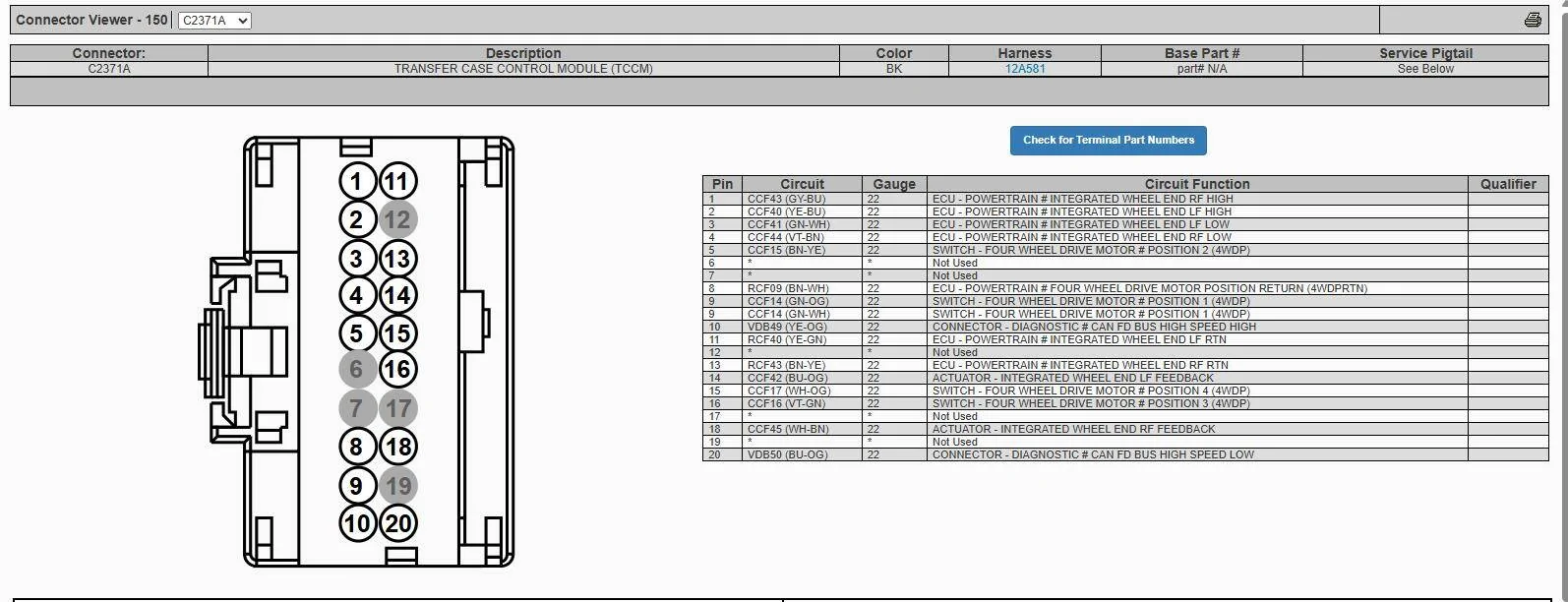

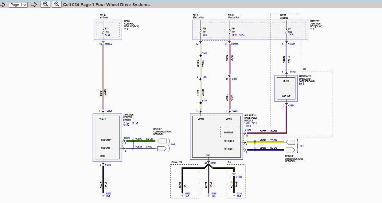

There are only 4 pages using that VIN.
Ford Bronco Transfer Case Technical Discussion 1743089663722-v
Ford Bronco Transfer Case Technical Discussion 1743089693873-2o
Ford Bronco Transfer Case Technical Discussion 1743089723975-73
Ford Bronco Transfer Case Technical Discussion 1743089762810-44
Ford Bronco Transfer Case Technical Discussion 1743090101254-l9
Ford Bronco Transfer Case Technical Discussion 1743090151728-m
BigMeatsBronco
Allan
Nov 25, 2021
52
3,418
10,570
97301
2021 FE 2 door
No worries

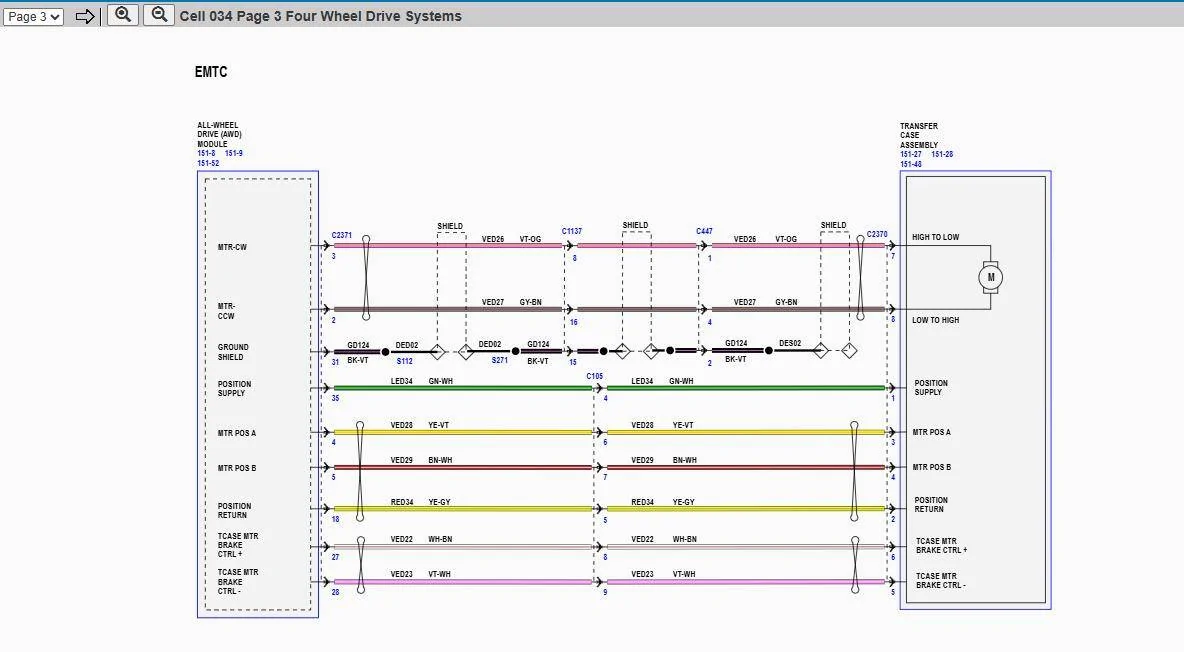

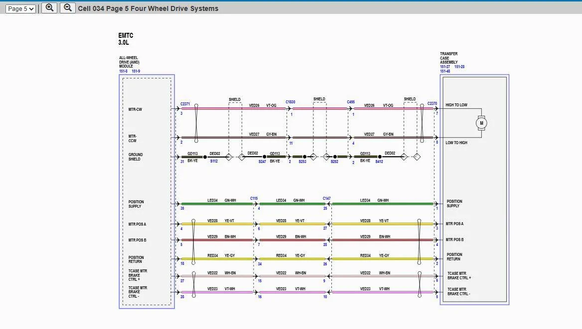

Well this is a bummer the two transfer cases don't operate exactly the same and the control wires are different. Obviously This only affects people that are doing swaps like myself but right now it is definitely an issue for my 5.2 swap as I'm using the Everest case. I see several options available obviously I could try using the F-150 all-wheel drive control module, and that's probably what I'll do. It may be possible to change some lines on for scan but I doubt it as this is more likely a configuration issue.
mpeugeot
May 14, 2021
9,147
18,927
Just spitballing some ideas. I would actually have to sit down and think this through.
This doesn't mean that the two different awd modules can't be used for the same vehicle.
It very much depends on the CAN messages to each AWD module. Also, it could be possible to use the Bronco AWD (or F-150) to control the transfer case from the Everest, but that would require you to figure out the controls somewhat with regards to the position sensors. You may only need some of the outputs from the t-case to achieve the desired operation with the Bronco AWD (or F-150) module.
Naturally, Ford won't provide the level of information needed to actually make this easy. The first order of business is to understand the inputs and the outputs of each of these transfer cases. I am not sure I fully understand everything looking at the schematics with my jetlagged brain.
