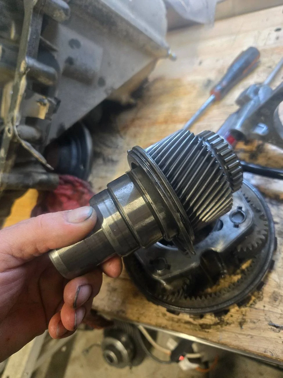

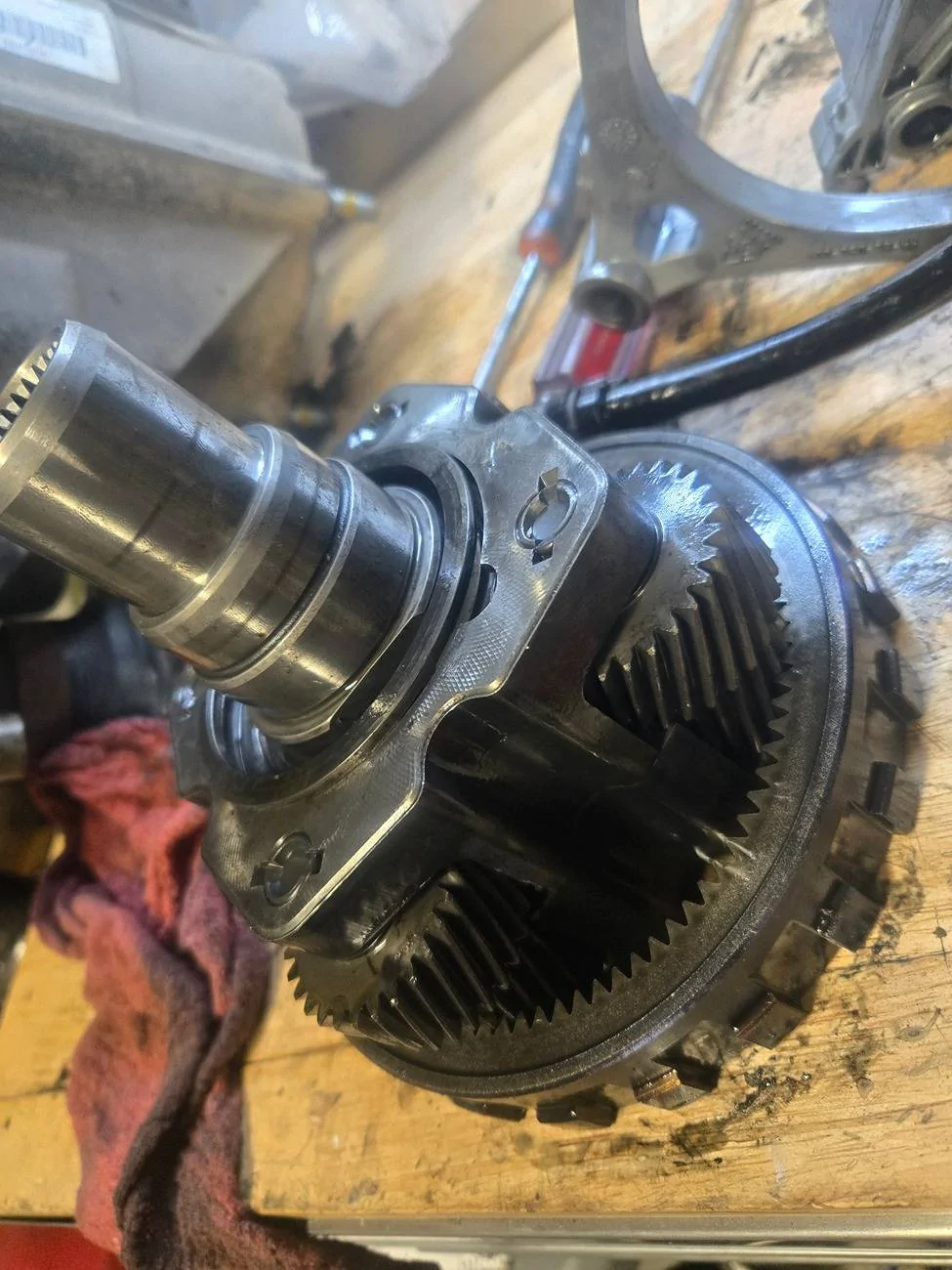

Okay so I got the Hummer H3 transfer case out and disassembled today. The input shaft on the 4:1 gears is definitely different than the heavy duty 10r80.

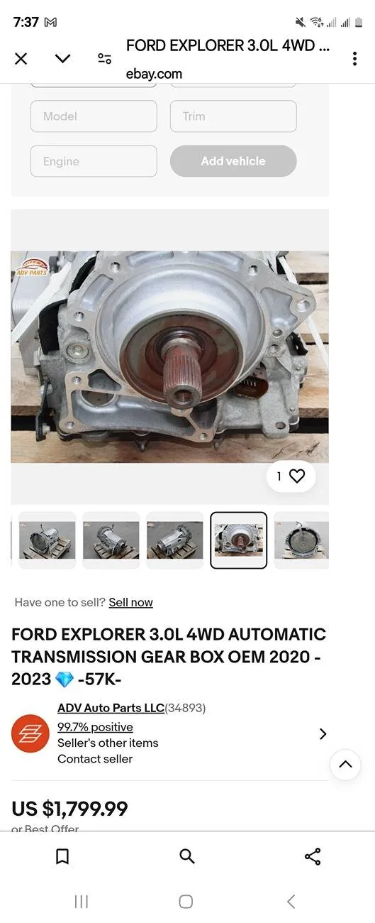

Which led me to do some research and lo and behold for those folks who want a 10R80 transmission, The Explorer 3.0 has a 10R80 with the rear transmission flange/ T-case bolt pattern is the exact same as the Bronco.!!!🤩🤩🤩
While this doesn't help my situation out exactly it does give Bronco owners in general an upgrade possibility for the transmission itself. Anybody with the 2.7 or the 3.0 could easily just bolt in a Explorer transmission from a 3.0 and it looks to me like it would 100% bolt right up to the transfer case that exists on the Bronco now. This could be helpful information in the future for some folks that have transmission problems or are doubtful that the 10R60 is up to the task. Or are running big HP numbers like @Ducati1098
I'm doing more research right now to see if the 10r60 output is smaller than the 10r80...
Edit they are the same ...31 spline.
This also confirms the 10r80 has two available transfer case patterns, the smaller bronco/ Explorer, and the bigger f150 pattern

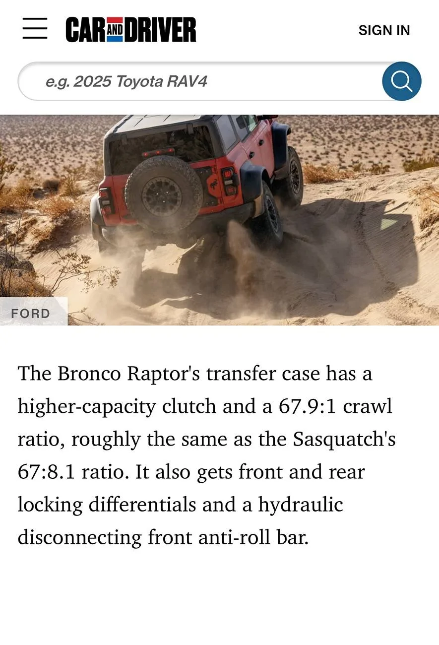

Hey @Ducati1098 or @flip - could either of you look up the part number for the bronco raptor tcase clutch? Curious if it’s different than normal advanced case based on this article
It is indeed different.
NB3Z-7C108-A

Additionally for reference, The Everest and F150 AND Bronco output splines on BOTH Tranny are 31 spl...H3 is 27 spline. So this H3 4:1 gearset is NOT "drop in", however a few parts could be customized to make it a feasible upgrade 🤔
here's pics of 4:1 gearset
Ford Bronco Transfer Case Technical Discussion 20250329_200757
Ford Bronco Transfer Case Technical Discussion 20250329_200806
Machine shop time?
