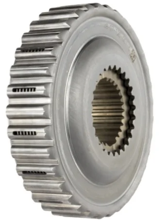

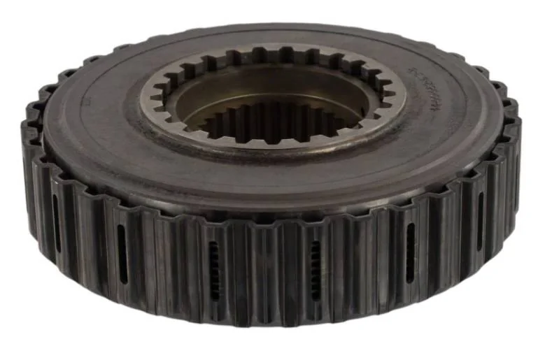

Makes me wonder what changes are made and what “higher capacity” means
Hard to tell for sure, but looking at the catalog pictures, it almost looks like the Braptor has an additional clutch plate maybe…?
Braptor one on top
Braptor one on top
And of course Ford has no consistency in orientation for the parts displayed 🤣
Suncoast mentioned trying to fit another plate in there but never did confirm if it would be possible when they received the clutch.

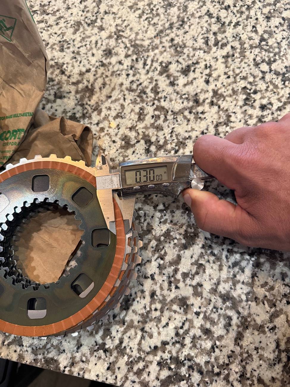

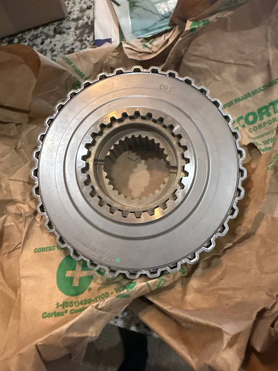

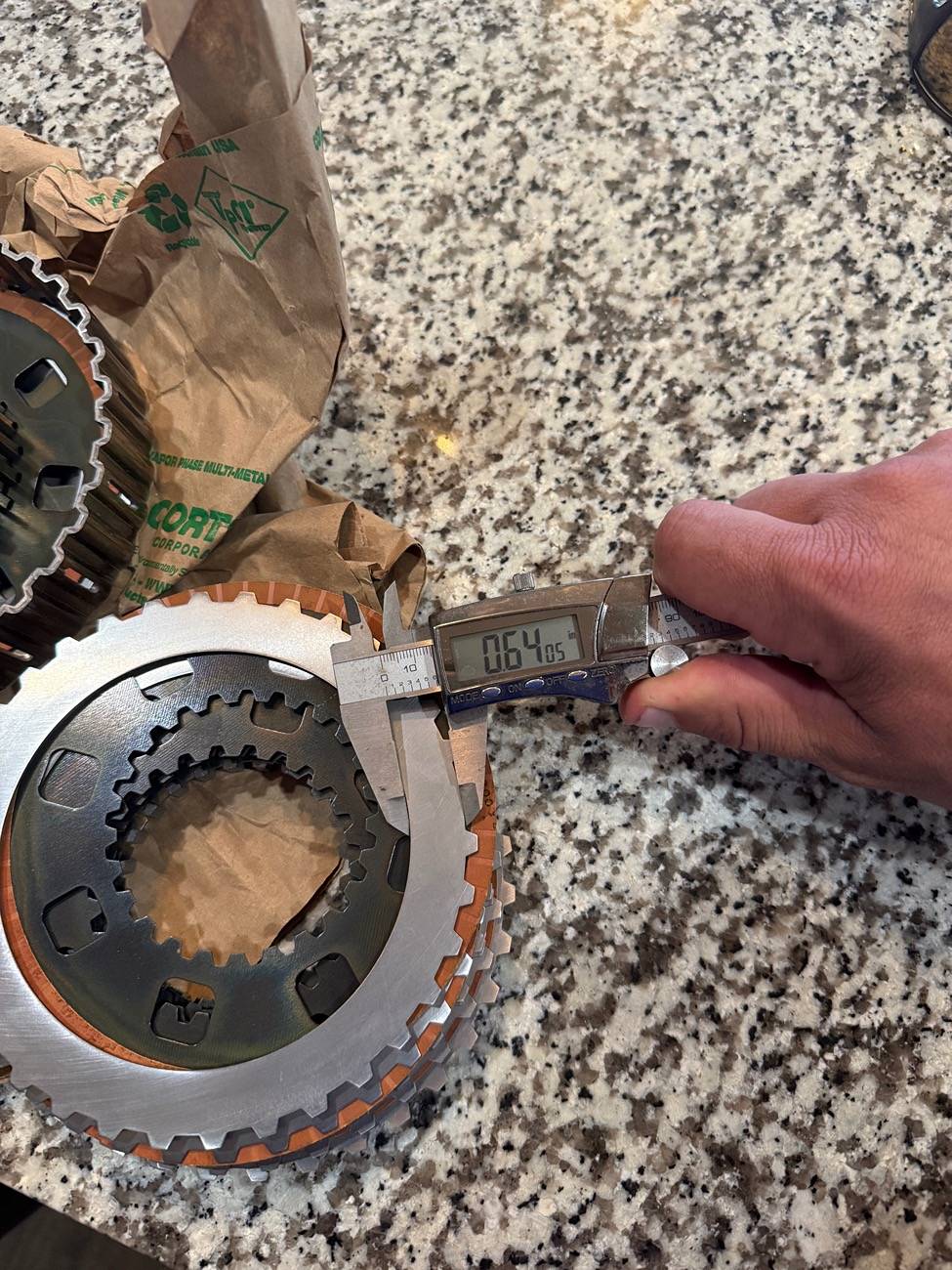

Clutch showed up today that we’ll install without any modification. This will maybe give us an opportunity to see if there’s a noticeable difference between oem and modded clutch.
The friction paper coverage on each plate is pretty thin compared to what we could have on there. Talked to Suncoast and when the new plates are coated they’ll maximize the contact area. That is, if we use the OEM plates. After looking at the setup they’re going to ask a third party their thoughts on making all new friction plates and we’ll go with whatever setup is going to have the most grip/strength.
There is some space available but without having the case apart and looking at how the clutch engages with the system I’m not certain we’ll be able to get any additional plates in there.

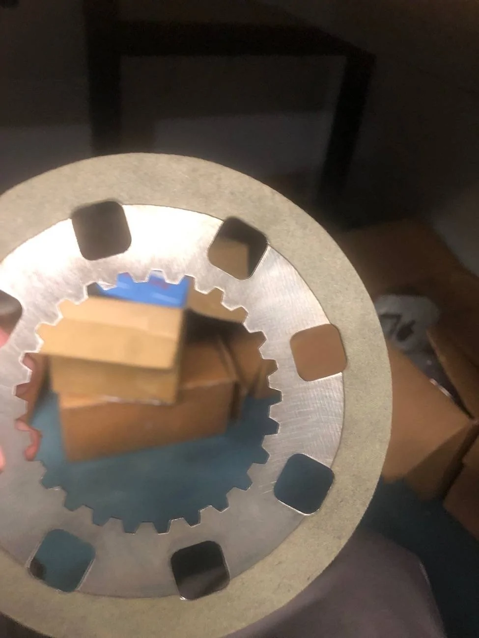

Clutch people decided a carbon friction paper would be the best material for our use. I didn’t get an opportunity to ask why.
Unfortunately it won’t show up in time to get installed so we have a few months before getting it in there.
Brand new friction plate with OEM coating-
Ford Bronco Transfer Case Technical Discussion IMG_6160
New coating applied to maximize available contact-
Ford Bronco Transfer Case Technical Discussion IMG_2828
We’ll see if it makes a difference!

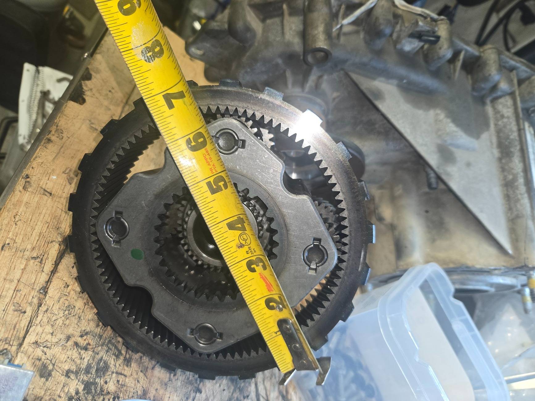

While you got the case apart can you measure the diameter of the planet gear on the low range portion? Here is a H3 4:1 for comparison...also tooth count on big ring?
Ford Bronco Transfer Case Technical Discussion 20250419_094936
SierraBronco
Mar 27, 2024
43
5,353
14,521
It will be awhile before we have it apart but I’ll try. At least two months.
