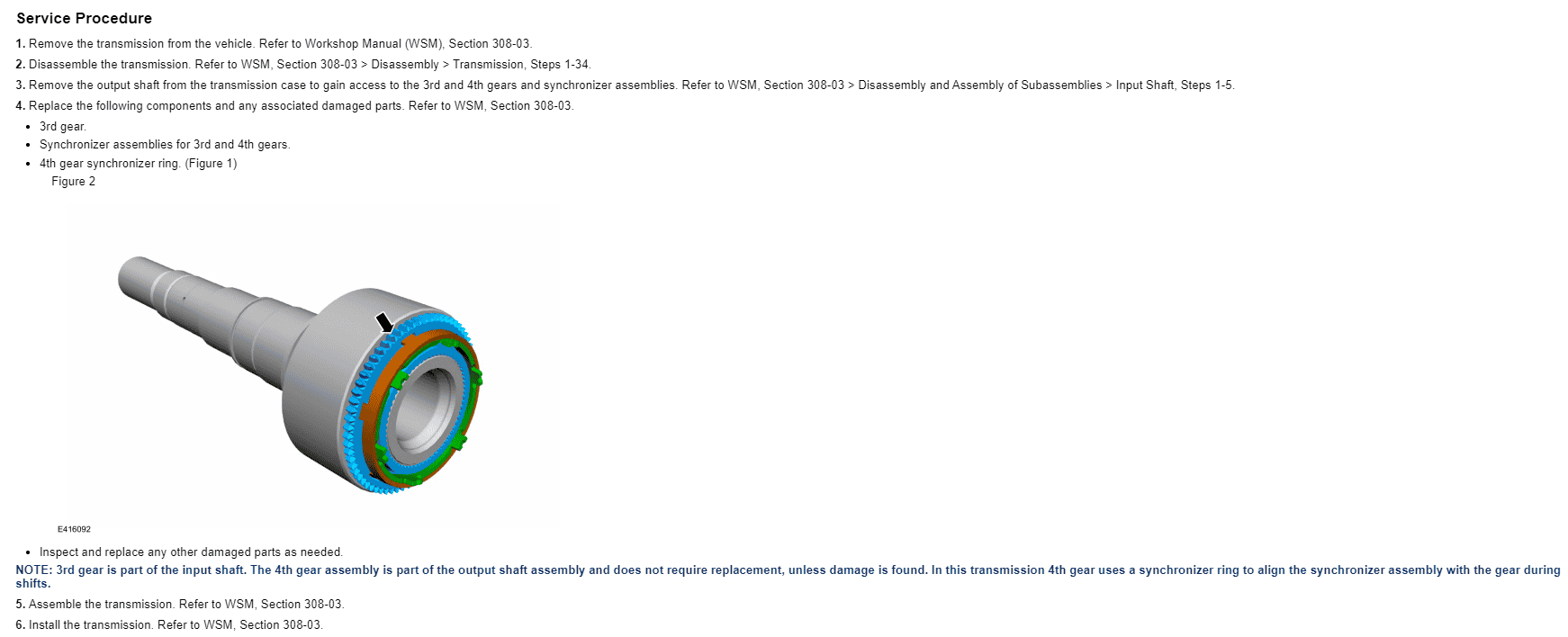

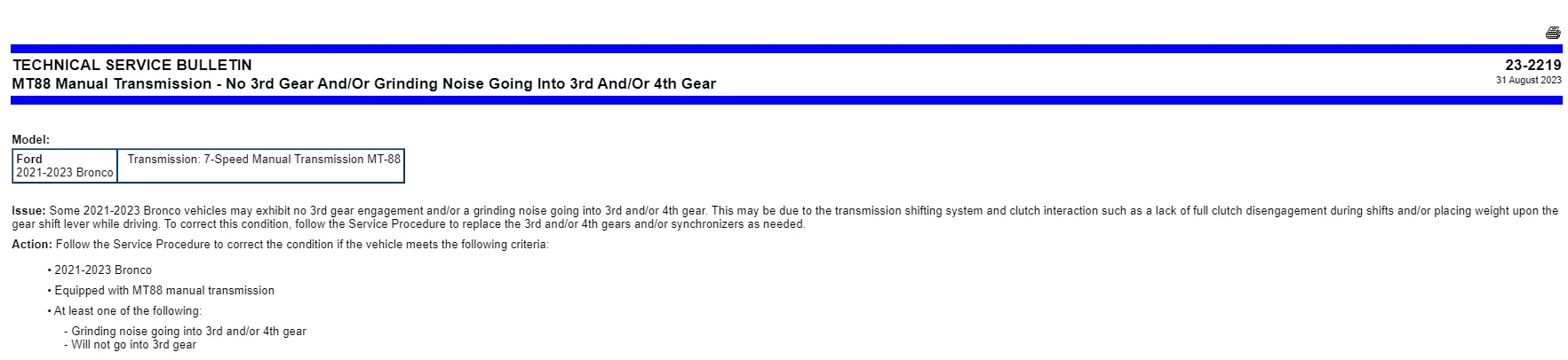

This TSB came out about a month ago, but here is the information for anyone interested or that has this concern.
While similar, this is a separate issue from the other 5th/6th gear synchronizer TSB and doesn't appear to cause grinding/noise except for the specific gear engagement listed.
Ford Bronco TSB 23-2219 - MT88 Manual Transmission - No 3rd Gear And/Or Grinding Noise Going Into 3rd And/Or 4th Gear 1696277339286
Ford Bronco TSB 23-2219 - MT88 Manual Transmission - No 3rd Gear And/Or Grinding Noise Going Into 3rd And/Or 4th Gear 1696277358243

Whoohoo, a problem I don't have!
Are these bad synchros only present in AA revisions or AB as well?
I'm not sure yet. But that is something I'll look into

Wait, third gear part of the input shaft?? So you have to replace the entire input shaft?
EDIT—
Never mind, didn't read far enough.
Ducati1098
Ducati1098
3,726
7,432
Midwest
2022 Bronco Wildtrak, 2012 Ford Fusion
Wait, isn't third gear part of the input shaft?? So you have to replace the entire input shaft?
EDIT—
I was confused by “3rd gear is part of the input shaft” at first also.
Because 3rd gear is removed from the input shaft for the other TSB to replace the 5th/6th synchronizer rings.
Just a poor choice of words on their part. 3rd gear is on the input shaft, not necessarily a part of it.
I do believe AB transmissions may have bad synchros as well. TSB 23-2019 covers the issue for MY23 and my dealer service rep confirmed for me that my 2023 7MT Badlands with an AB rev transmission is included in that TSB.
Some MY23 Broncos were built with the old AA transmissions. So this could only be for those only.
I’ll look at the parts in the morning and see if I can determine if the revised transmission will have this issue or not.
