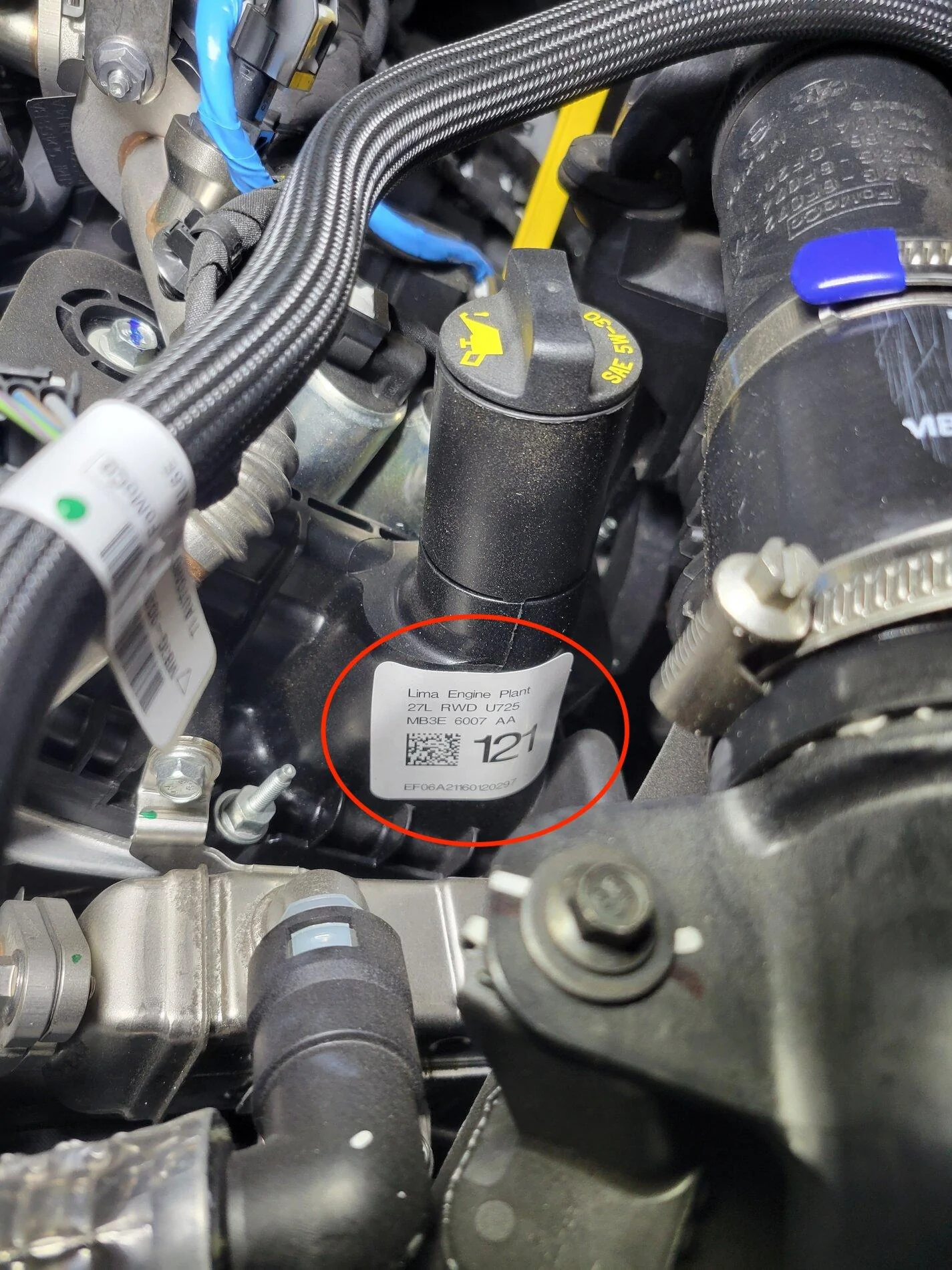

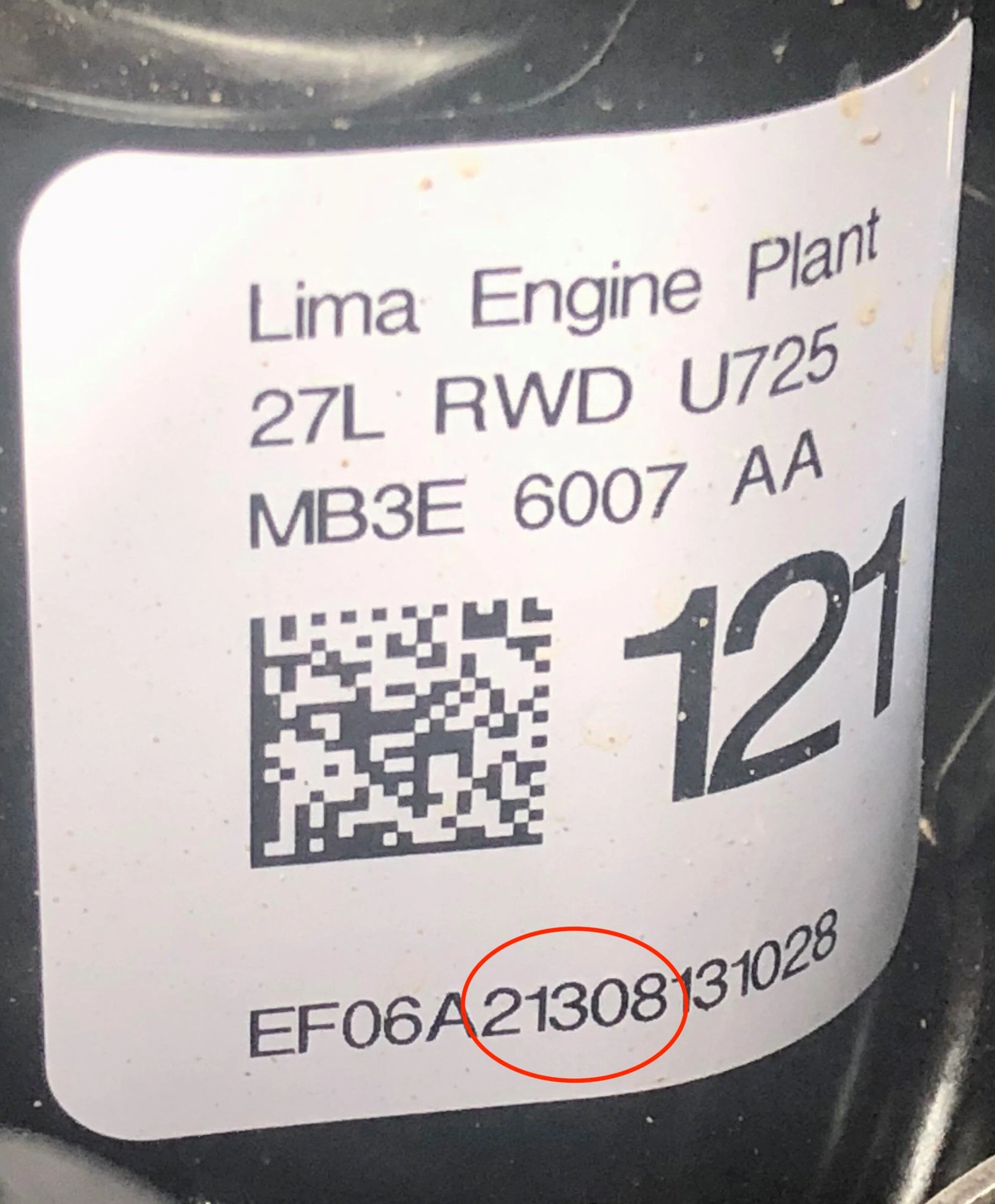

bkfit
BK
452
1,151
Spaceship
Man, at least no accident - but what an ordeal
- maybe ask dealer for loaner - save rental reimb hassle
- in opening post see repair threads ** - lots of good advice
- here in B6g we're tracking engine build-dates to see what's happening - see table & graphs in OP
- when time permits we appreciate engine label info - has engine ser# - photos below
- maybe Service Dept can take a look and provide it to you
