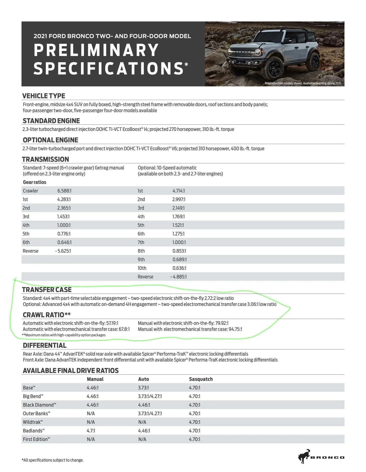

My build is a Black Diamond, MT/2.3. It will be towed a lot behind our Motorhome and will carry us into to town and sightseeing areas away from crowds. I see it used for some off roading but as I have gotten smarter over the years I don’t see me looking for huge mud holes to prove I can cross.
With that being said, should I upgrade to the ”Advanced 4x4 transfer case”? Could this prove beneficial in the long term?
Thanks

In Texas or other warm weather states, I’m not sure the advanced transfer case will make much of a difference to you. I see it as being the most useful when there is snow and ice on the ground so four wheel drive is needed, but not all the time. You could put it in 4A and then let the Bronco shift in and out of four wheel drive whenever it detects the tires slipping.
I’m sure there are other situations this would be beneficial, but, being from Michigan, this is the first thing that comes to my mind.
Gear ratio as well.
