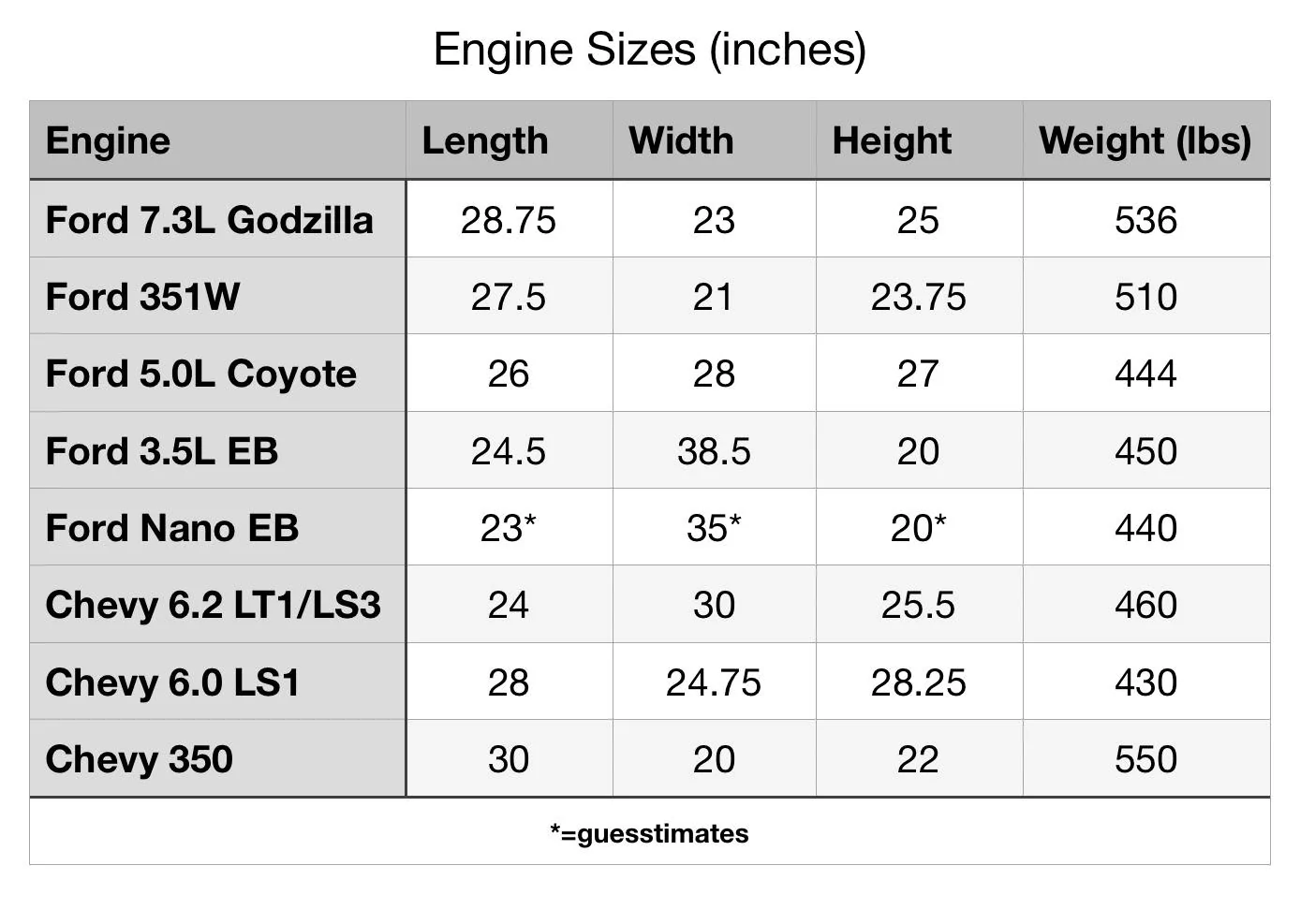

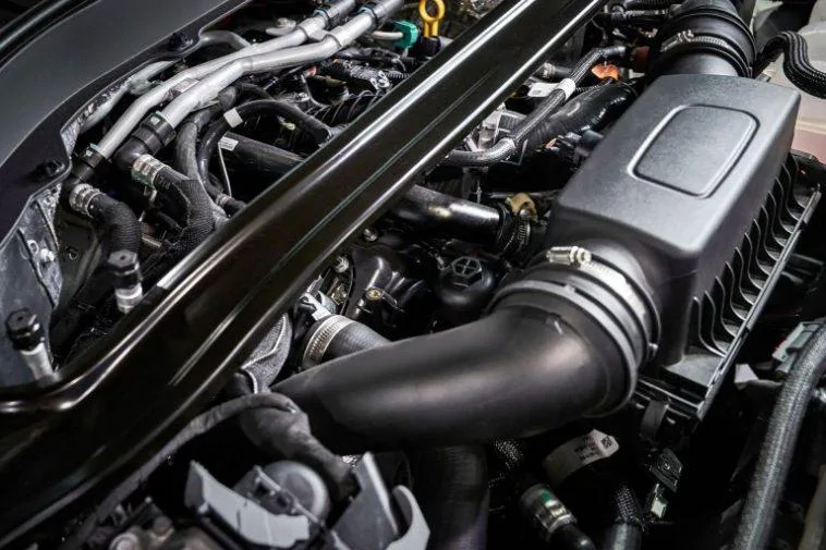

I was going to try to see if you can tell by the fuel rails but um... good luck finding those in this mess >.<
Dear lord and you know the bronco is only going to be Tighter.
yea a 5.0 AINT gonna fit.

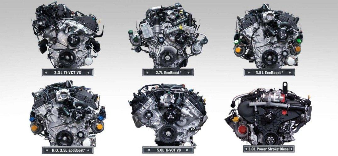

Yeah I'd have to see a long block outside of the vehicle to be sure.
Also, I wouldn't be so sure about your last statement:
definitely not to scale here
If I can get a DOHC in there ...…….. then I can make a pushrod fit ;)
Need a Windsor motor in there for a compare-o.
