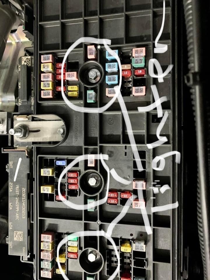

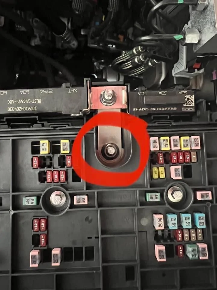

I sure would hope your dealer checked this as itā€™s a well known issue, but check your fuse block connections. Many have been loose and exhibited these exact errors.
