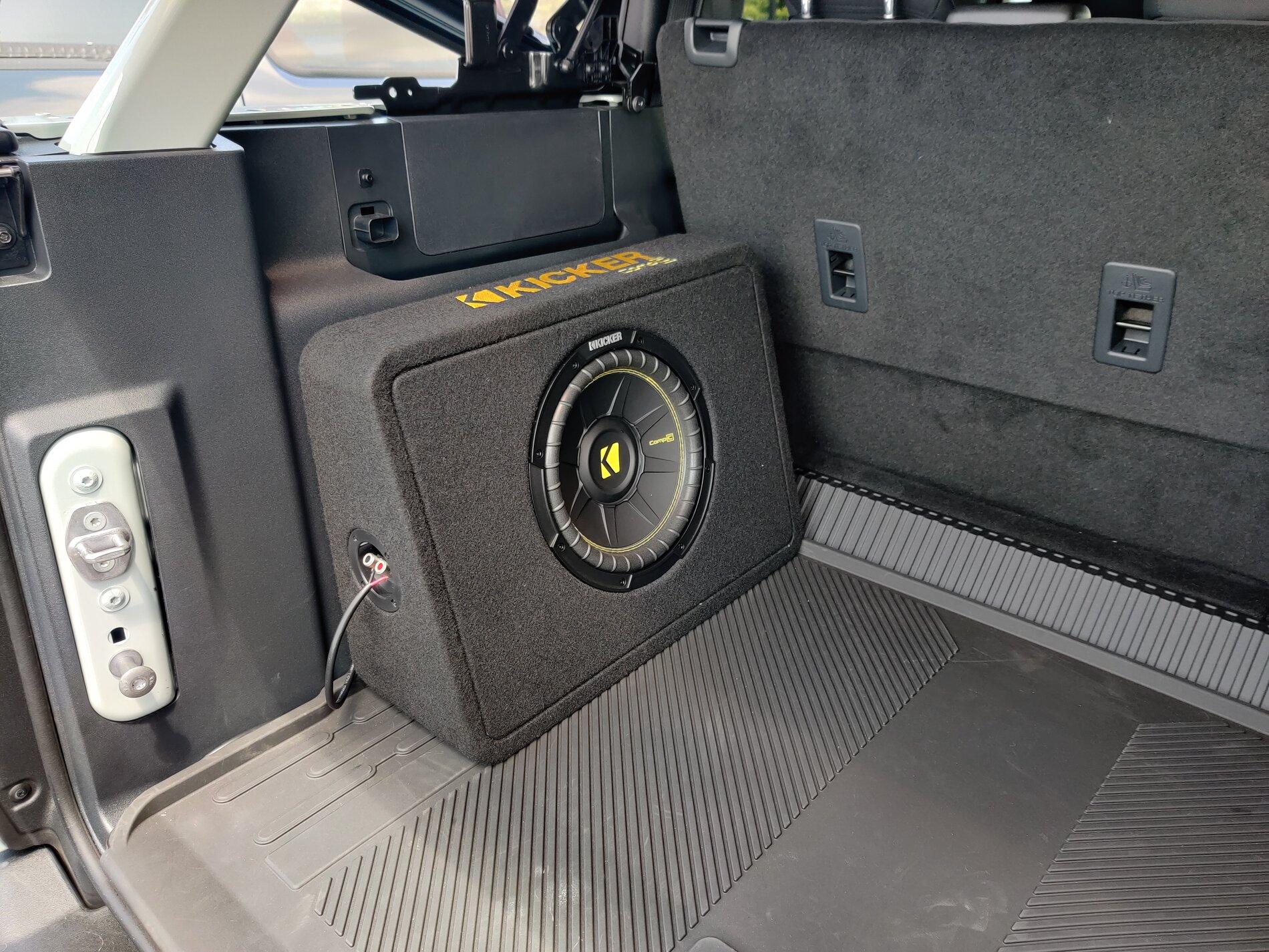

So one 4 channel amp for the front 4 speakers, then another 4 channel for the rear pods, and then the mono amp for the sub which I forgot to mention in the updated build! It's a 10" ported kicker that is nice and compact but still puts out a great low end performance, even with the top down!
where did you place that 10" sub?
It's to the left of the cargo area right now, trying it on both sides to see if I can hear a difference in the low frequency response from the driver seat!
Not a big fan of all the yellow on the box, but it's not something I have to look at often, and can always black it out with some fabric dye!
Hmmmmm, I'm not too keen on losing cargo space .... i wonder if two forward facing 6x9's could somehow be mounted on the C-column, and if so, whether a subwoofer is even needed in an open air car?
what do you think? I mean at this point we're all just experimenting right?
It's definitely possible! I enjoy a decent amount of bass in my music, but it still sounded good with the sub not wired up. Also for my specific use case if I ever do need the extra cargo space the sub comes out really easily!
