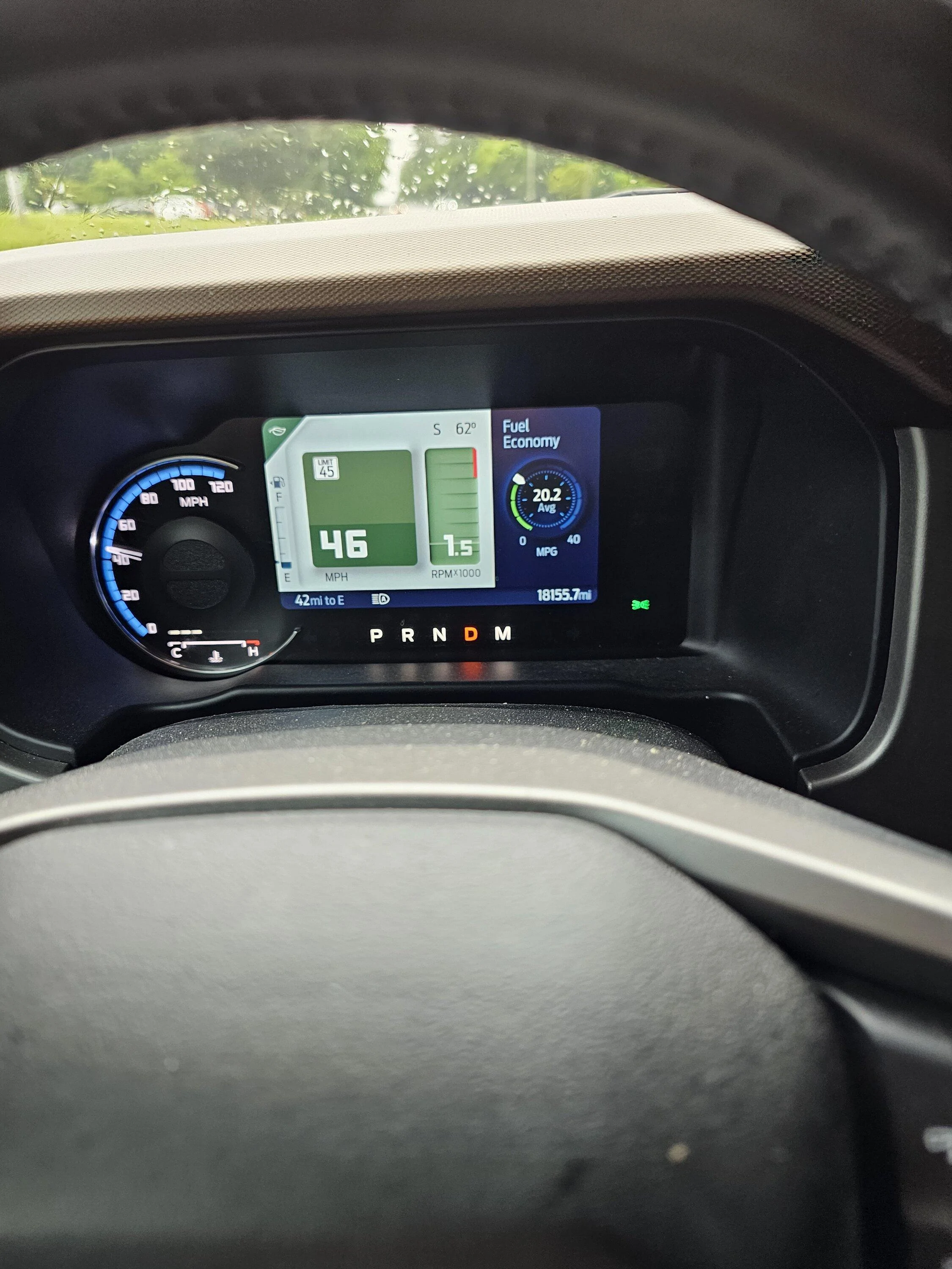

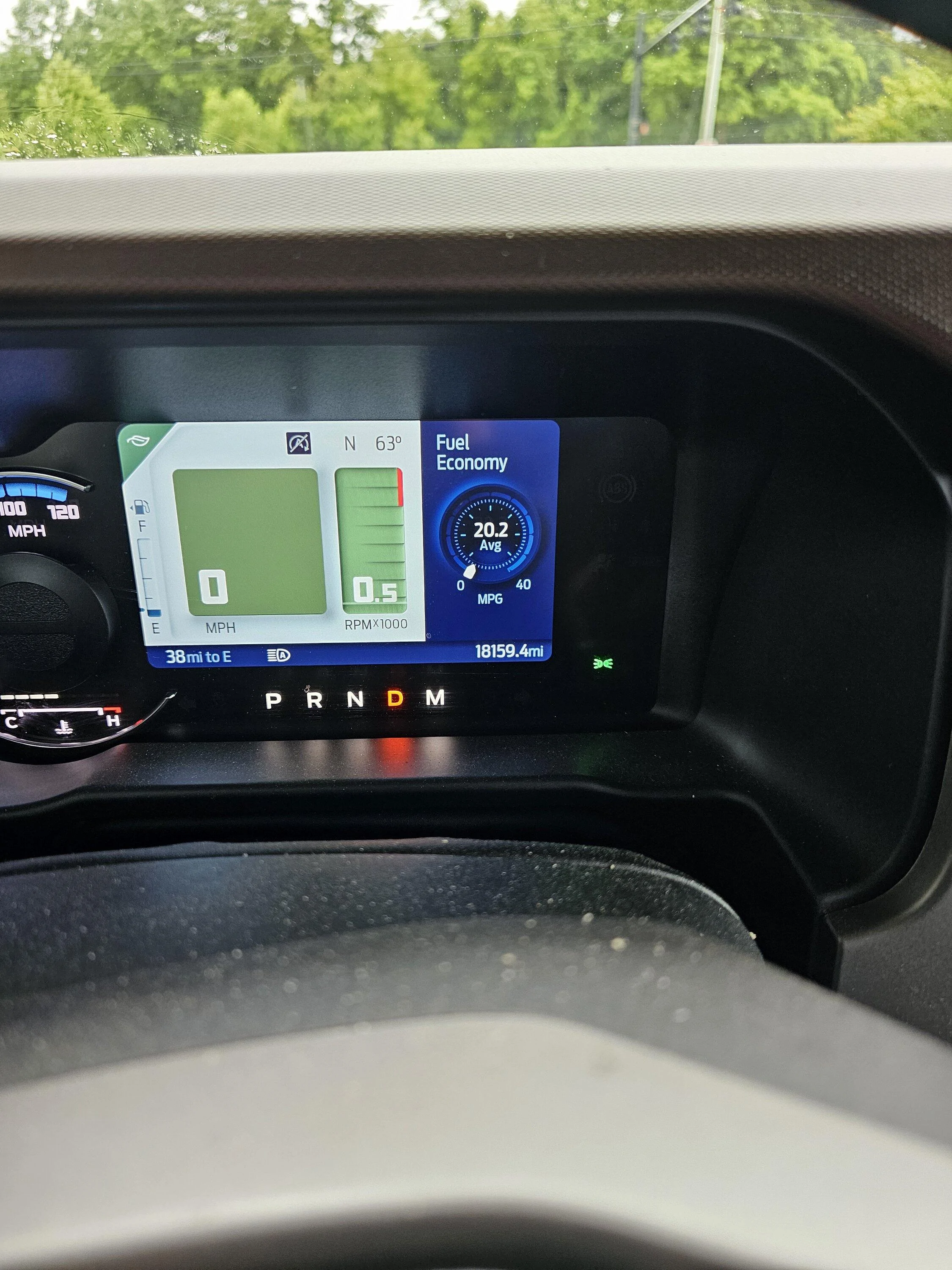

My 2.7 on premium fuel Eco 2wd is (by dash computer) delivering 22 mpg highway only. My daily drive has me at 20.1 mpg combined.
My dash showing me my mpg is generous. I use Road Trip to record my fuel-ups and it is calculated at about 17..5 average around town in that app.
Yes... makes you wonder about what else the on board computer is wrong about.
lets see a picture. I do the same and get 17.0.....do you have the goodyear MT and SAS?
