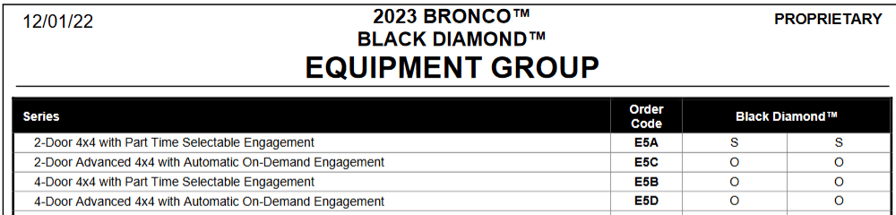

If I'm reading the order guide correctly,
4A is standard on the Badlands, Raptor and HEL or any other trim that has Squatch standard.
It is part of the Sasquatch pkg for any other trim.
IE, it is no longer available without Squatch on the lesser trims. (BB, BD, OBX )
https://www.bronco6g.com/forum/atta...d1c88382b394627600564d&force-system-browser=1
Thank you for posting this.....this is what my dealer pulled up.

If you are set on the 4A in a Black Diamond without the Sasquatch, I'm sure there are past model years available. If you expand your search, I would think you could find a new '23 on a dealer lot. Don't limit your search geographically. I have 2 Broncos and the closest was 1400 miles away. A plane ticket and a drive home or auto transport is cheaper than paying for the MY'24 price increase.
If you do search for a 2023, the 4A will be reflected in the vin.....E5C or E5D. This will make your search much easier.

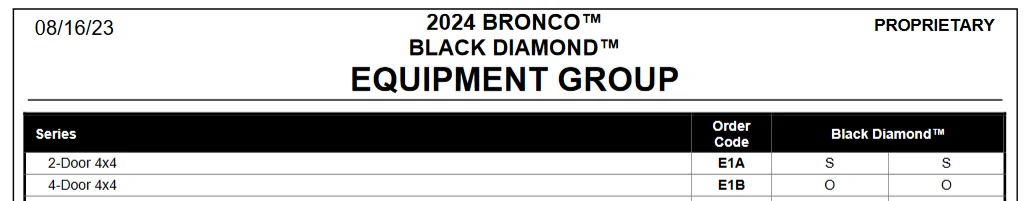

Ford Bronco Black Diamond 4A Automatic 4x4 Non-squatch BD 2024 1700754078414
Thank you for this....the code on the 24 is E1BO.....This is what wasn't clear on the order summary page but now I know.
Fly by Nite
Walt
Aug 6, 2020
1,495
2,965
Pa
2024 vin's don't seem to make a distinction between part time vs full time (4A) 4x4. Just 2dr vs 4dr. Must be new for 2024 vs the 21-23.
