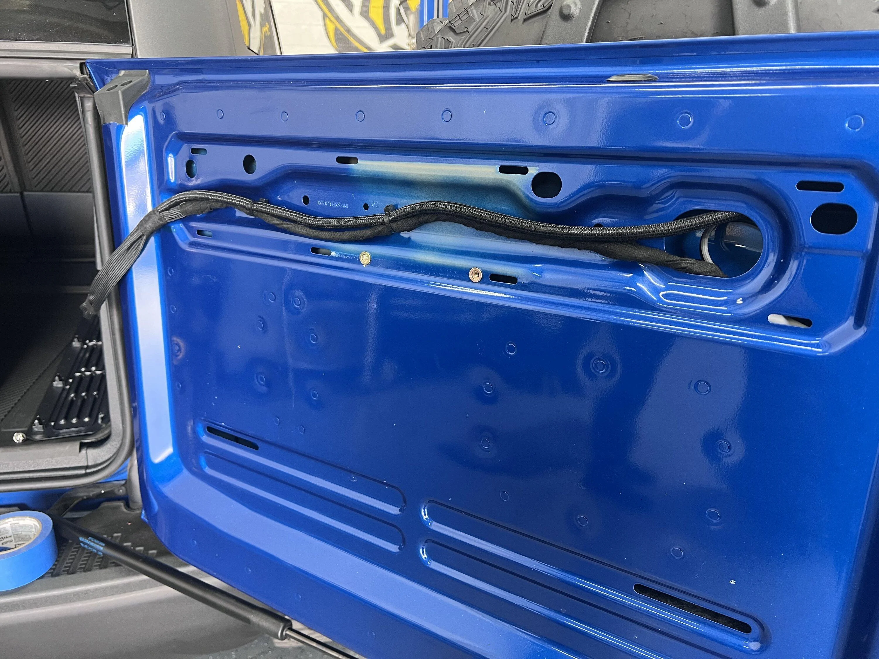

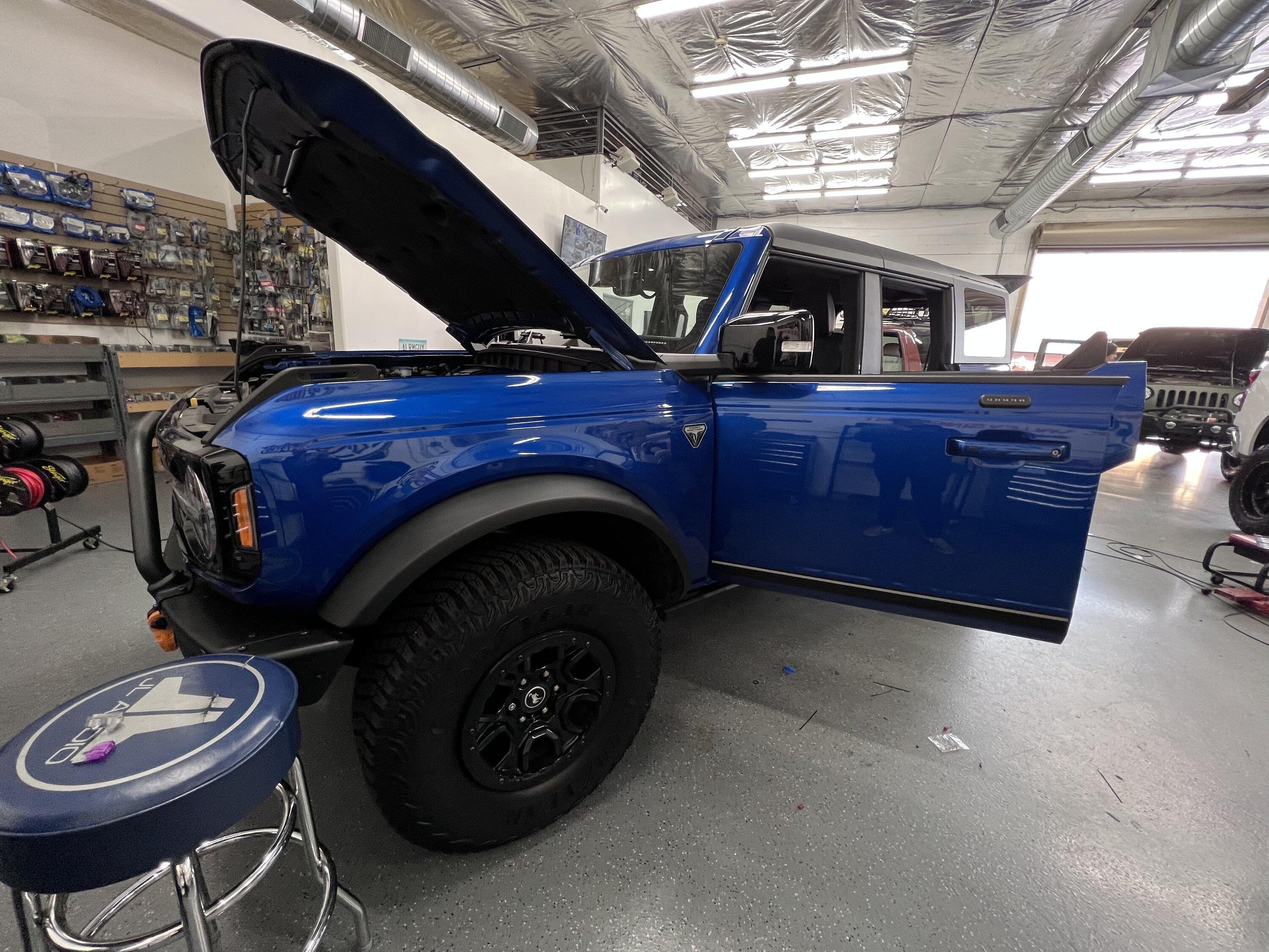

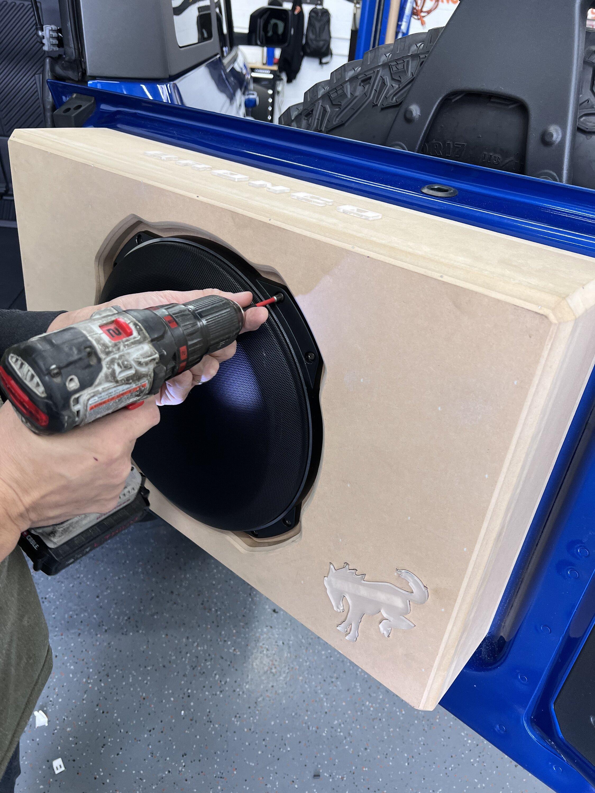

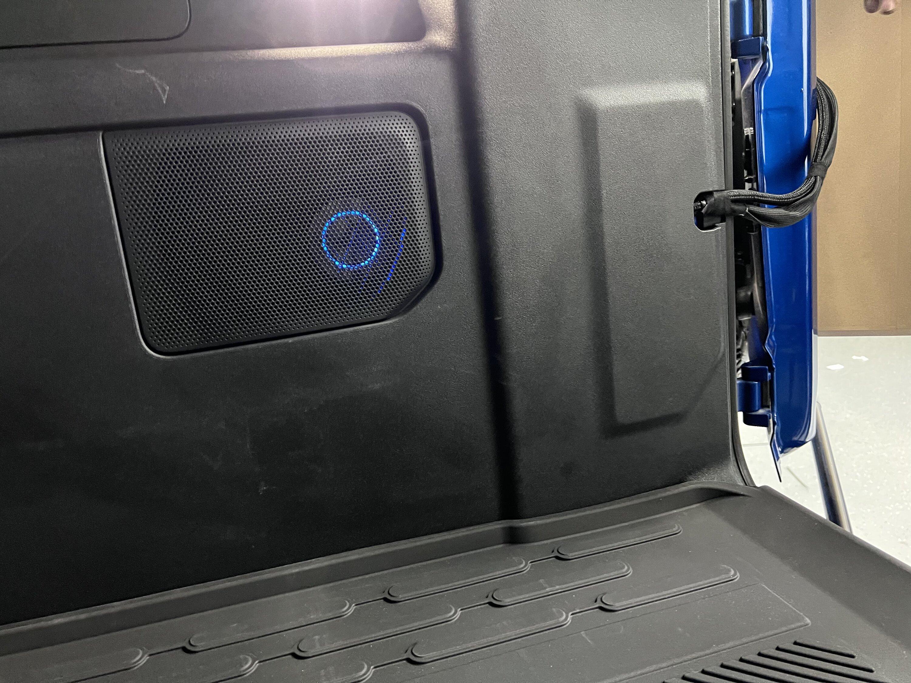

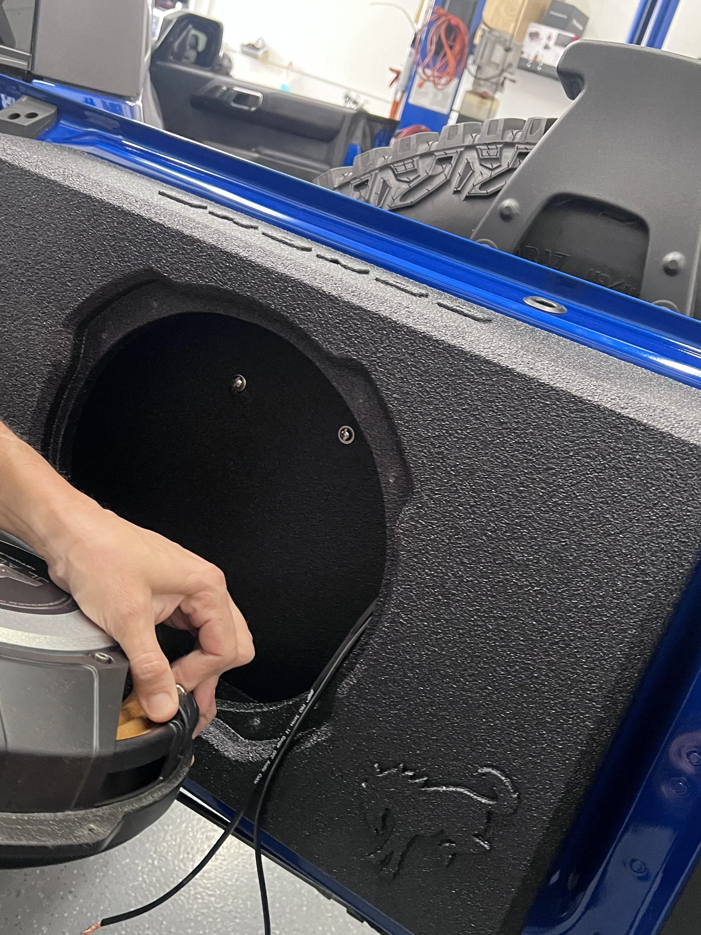

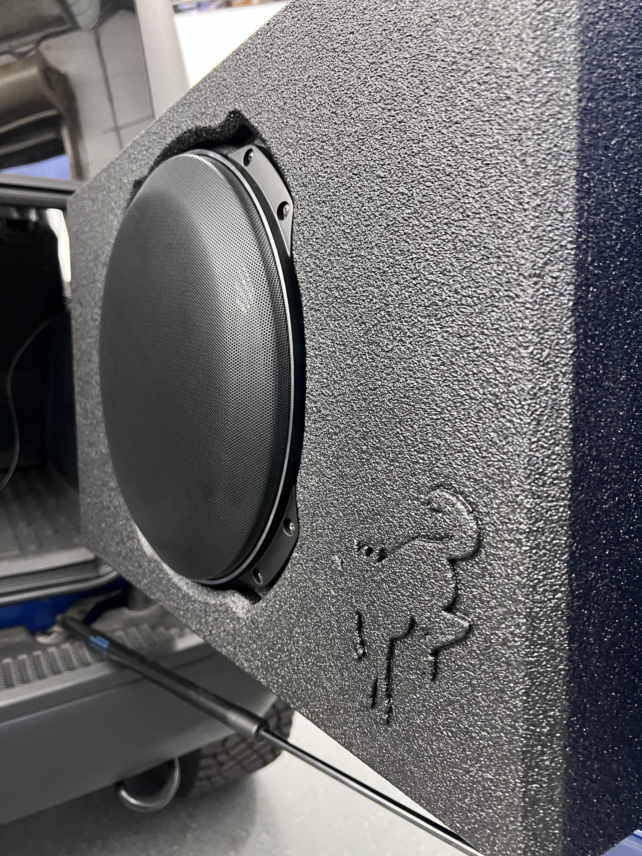

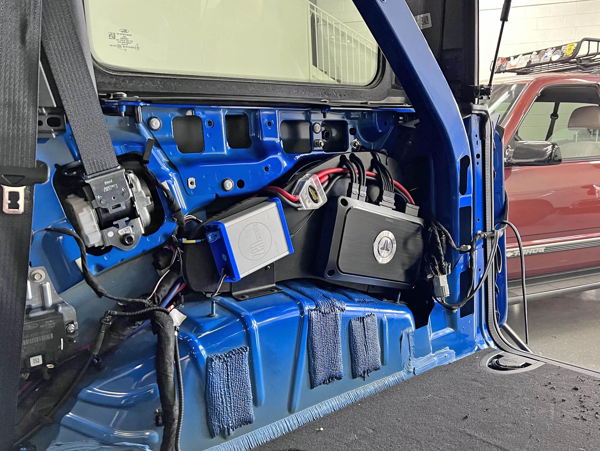

Hey guys I wanted to share a write up on this bronco I just did the audio swap on
2021 Ford #Bronco
The perfect way to integrate one of the lowest rated OEM Amplified sounds systems. The B&O killer
8 Speaker active designed sound system by Kartunes fine tuned by JL Audio MAX 5 microphone design unit. This design features the following units
VX800/8i

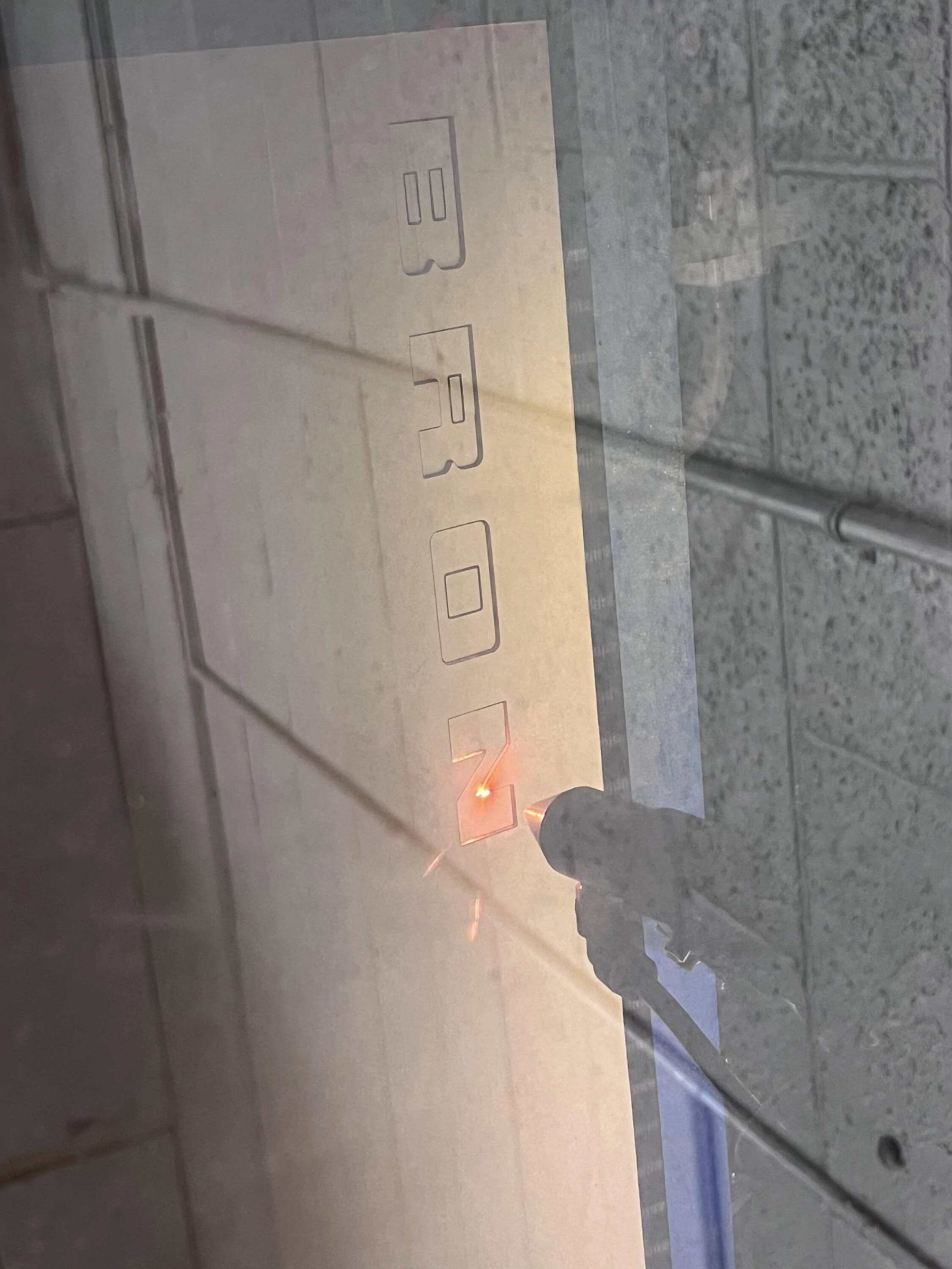

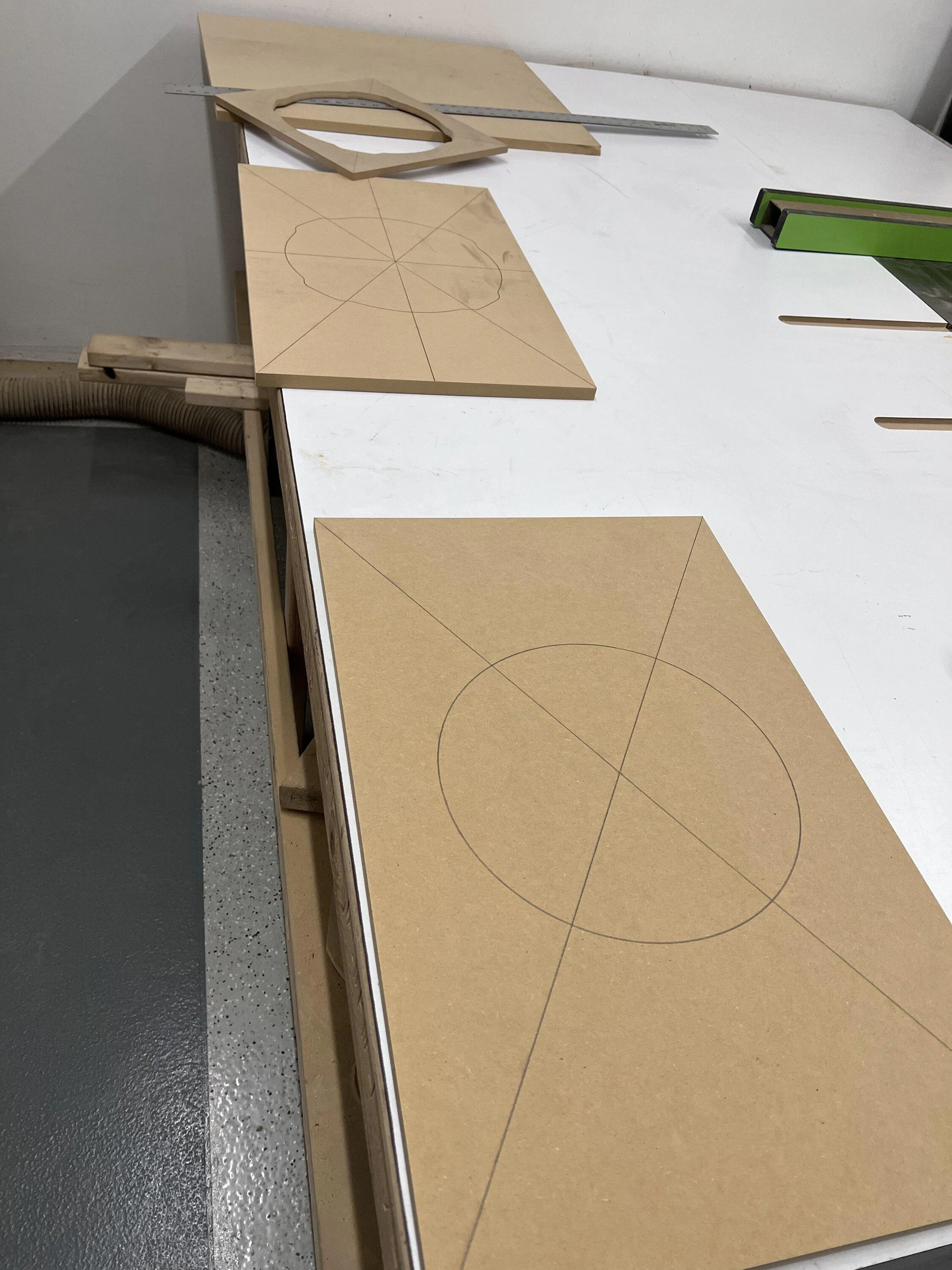

Channels 1-5 (front stage) : Audison APK 3way (2-Tweeters, 1-midrange driver, 2- midbass drivers) are installed in factory location dash and kick panels. All speaker replacements parts are laser cut and built in house.
Channels 6-7 (rear fill) Audison APX coaxial

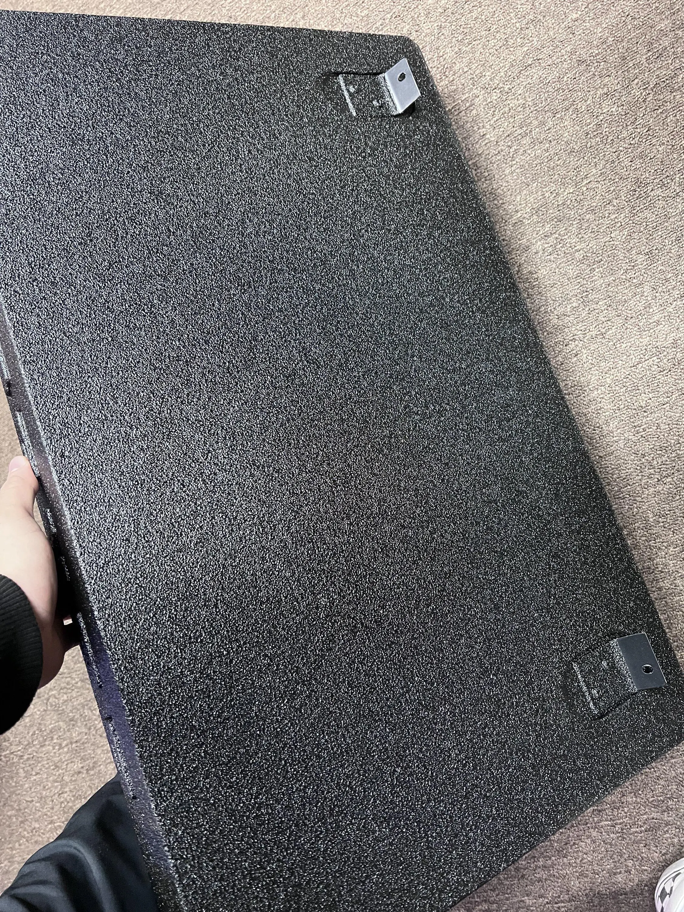

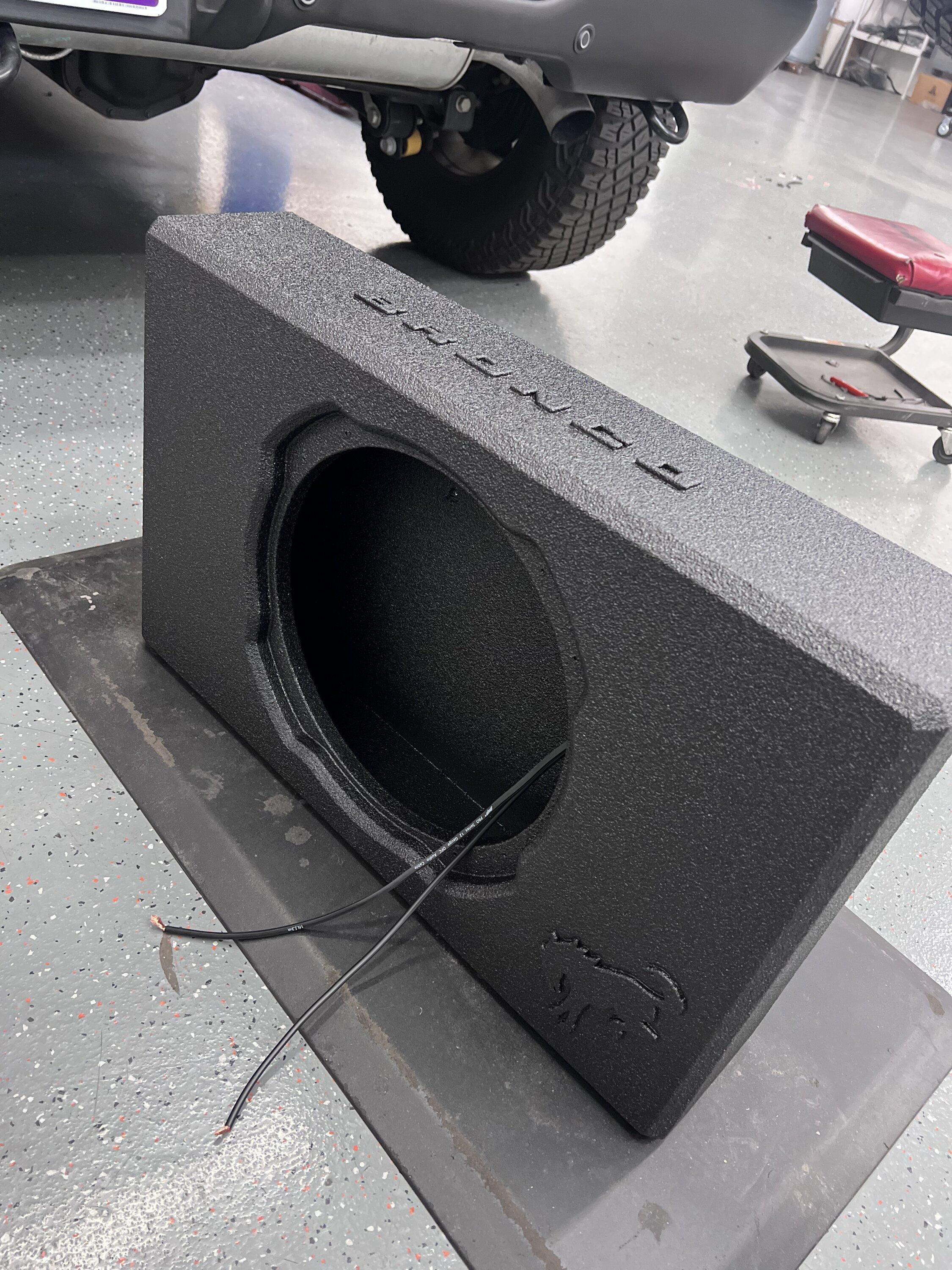

XD600/1 (Substage) JL Audio TW5 13.5” subwoofer. Bespoke Sealed enclosure built in house sprayed with weather resistant liner tagged with Bronco badging.

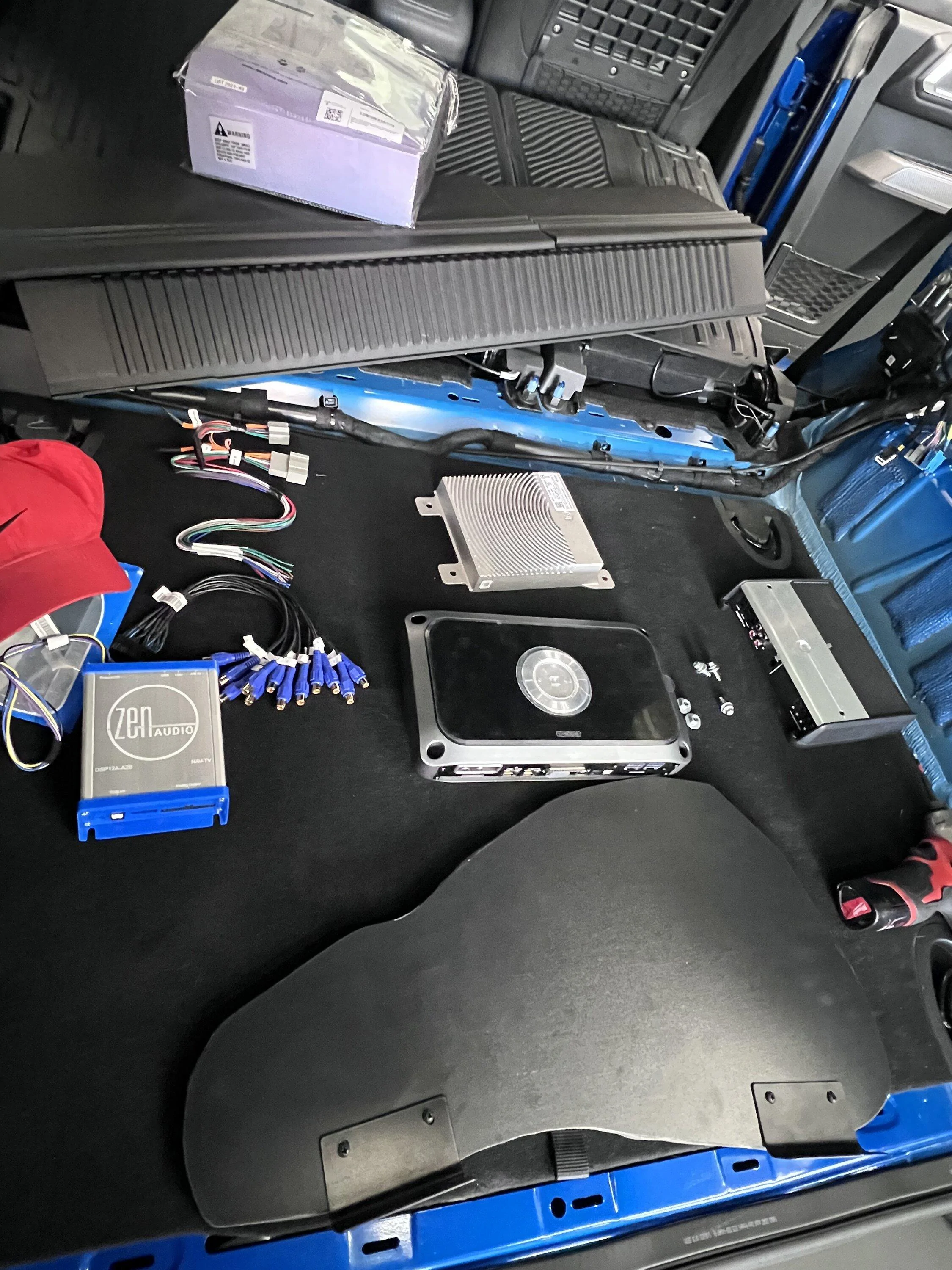

Integrating the factory signal into the aftermarket amplifiers via fiber optic signal from NAV-TV zen module lets you keep all oem features as far Bluetooth, Navigation voiceover, and parking sensors by playing through your new system with controllable volume.

Where did you mount the XD600/1?

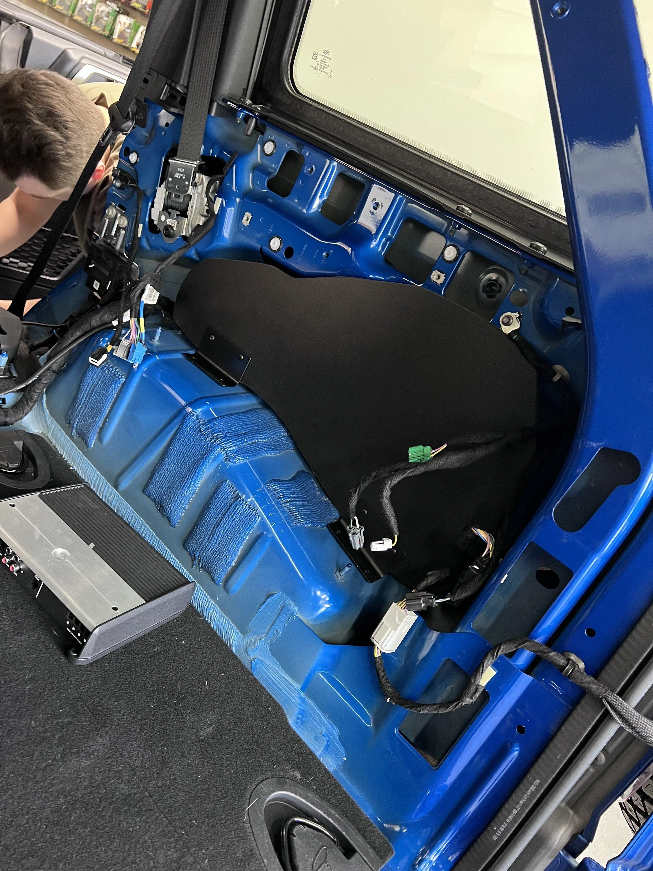

I mounted the xd on the opposite side of the amp board. At first I was stressed a little finding out I was limited to the space on the amp board. But I did see someone do something similar and I’m glad it worked out perfectly
