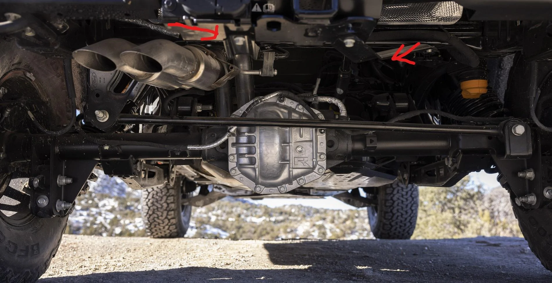

so what changed?
can we add capability to regular Bronco?
seems to have additional support bars maybe (see pic and arrows below)
Ford Bronco Bronco raptor towing 4500 ???? Inked2022 Ford Bronco Raptor_details_11_LI
I don't think it is engine or xsmn capabilities. What are your thoughts?

Every auto news outlet is pointing at the extra bracing thanks to the muffler not occupying the space. I can see an aftermarket exhaust and adding the bracing. The frame is the same except the strut tower mounts and some suspension goodies. The brakes are larger, but I feel the 37s extra rolling mass kind of wipes that benefit. There is a tow/haul mode which I don't see why Ford cannot add that to an over the air update or update at the dealer since it is just programming.

Different suspension. Different axle. Bracing on the frame. Lots of things changed.

so what changed?
I suspect that much of the difference is the Fox Live Valve shocks. It makes sense to me that if the towing capacity in the regular Bronco was limited by the suspension that these Fox shocks could help significantly while towing. The shocks can adjust on the fly to current conditions. So if things start to get wonky with a trailer, the shocks can stiffen the appropriate shocks to help stabilize things. Also, they have a towing mode which I assume also sets the shocks appropriately to add more stability while towing. I see this as a possible reason why the Bronco Raptor has an increased towing capacity.
