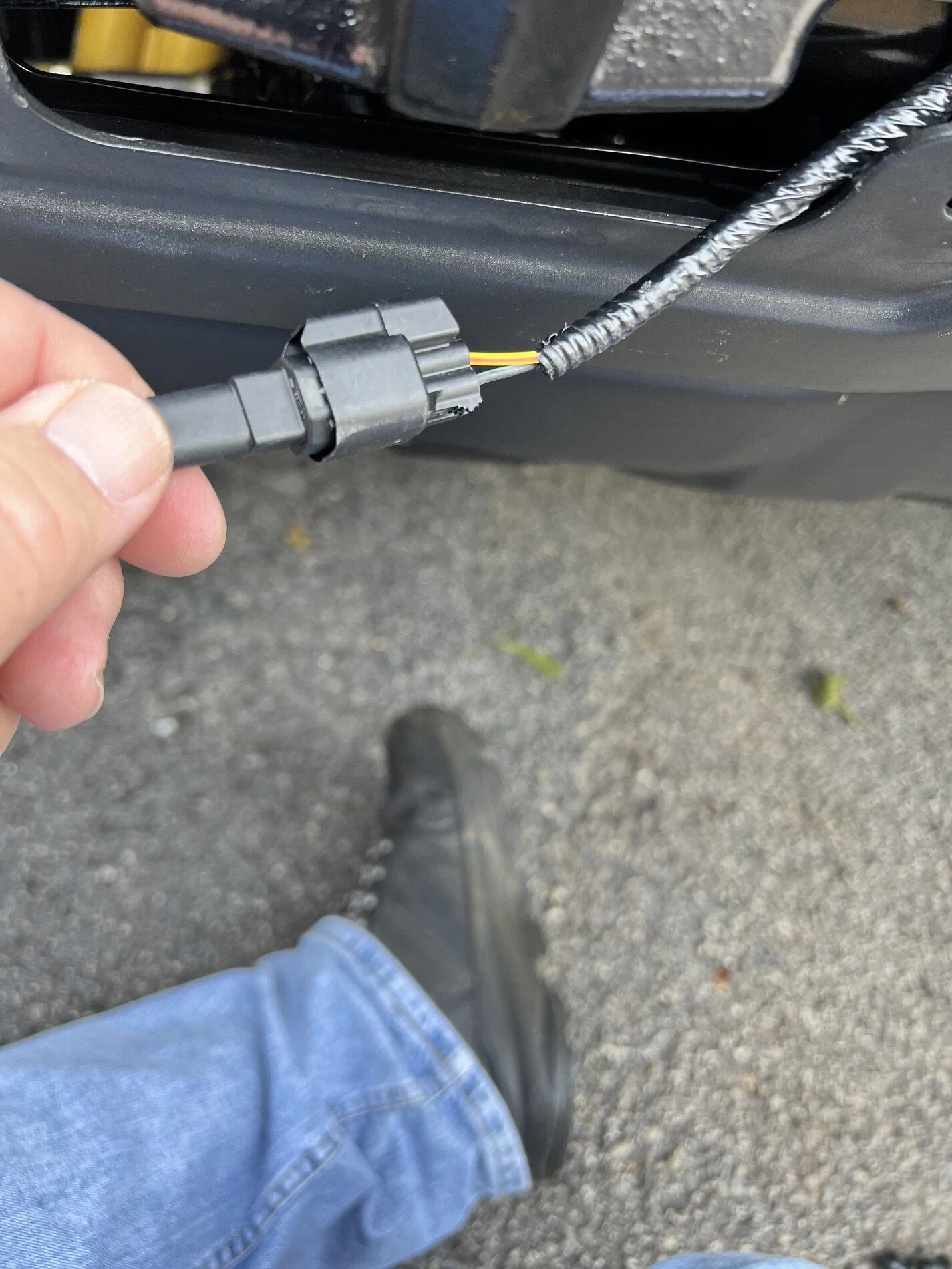

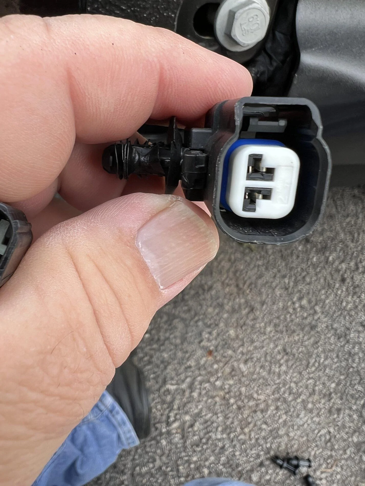

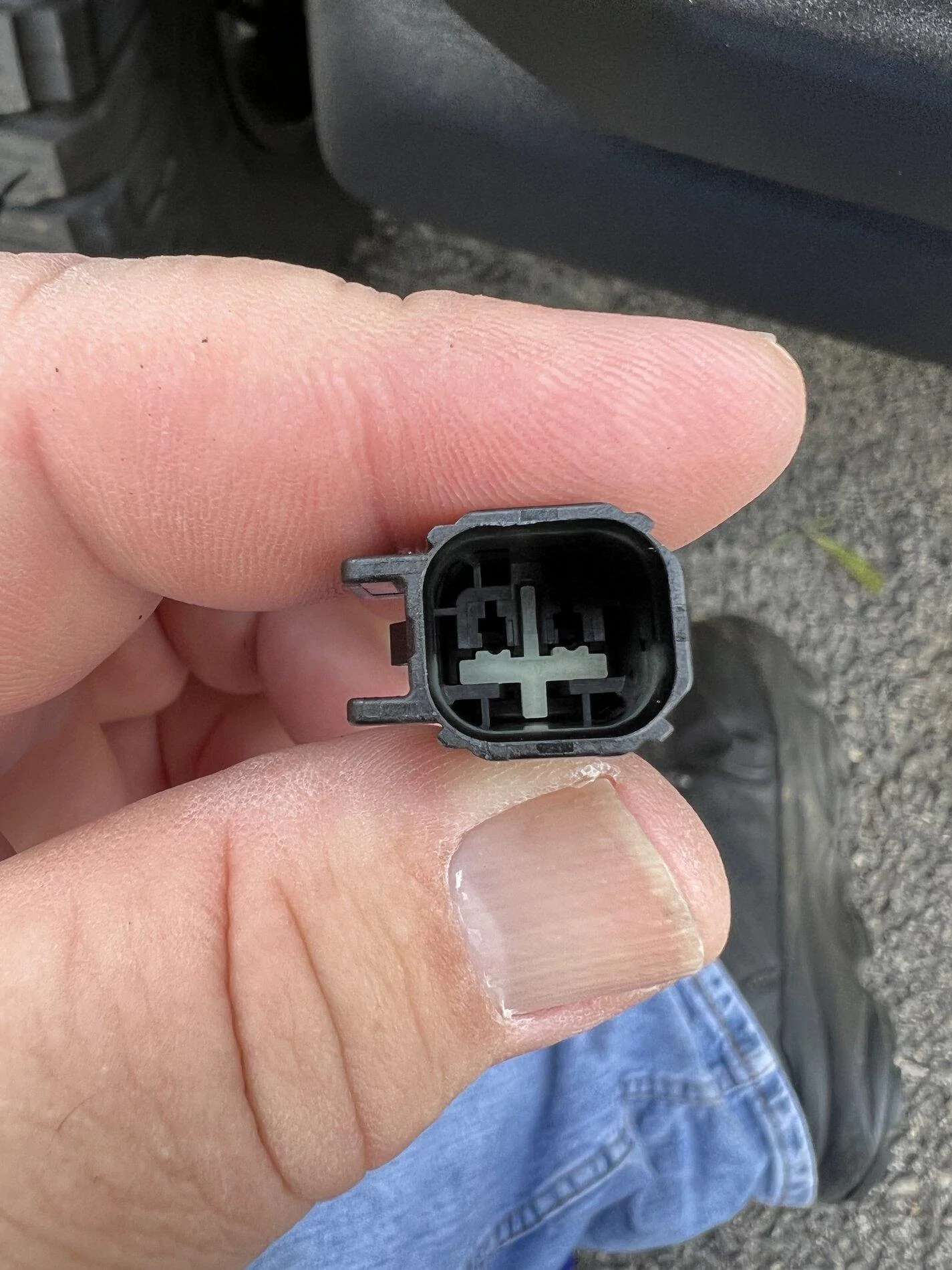

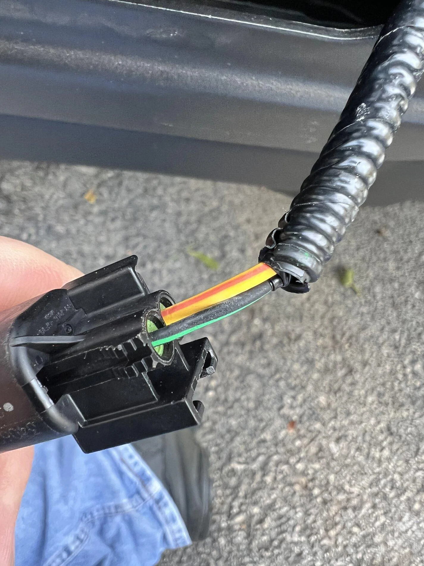

So, looking for any clarification anyone can provide. Apologies up front if the answer is obvious but I'm very much a novice at automotive wiring.
From this thread and my own work on my 2021 Bronco FE, I see i have the fog light wires on the passenger side (Yellow/orange(+) and black/green(ground?)). Driver's side is Brown(+) and black/green (ground?).
I'm trying to connect through the replacement light switch inside that now has the fog light button. Connecting a set of Rigid Scene lights from SPV.
All the forscan was changed based on the helpful info in this and other threads.
What I can't figure out is how to connect the wiring behind the tow hooks. The harness that came with the rigid has the 6 lights bundled in three sets of two and I'm going to control one set with the fog light button. So, the harness collects what will be the hot wire for that one set of lights in one connector.
The question is, what do I connect to that one + wire that goes to that set of fogs? Do i need to connect both the positives (yellow/orange and brown) to that one hot wire to the fog set? Also, what do I do with the black/green ground wires?
Again, sorry if the answers are obvious, but they are totally eluding me.
Thanks for any help!

There's a matching connector on the other side in the same place! smile. I DM'd you with my cell number if you want to get a walk through. You can buy a pigtail to match the factory harness end, Next , you can buy an adapter harness to get the back light power without tapping a wire if you want a simple plug in . All can be done really inexpensive if you want to use butt splices. If you spend a little money you don't have to do anything to your existing harness.
Using an aux switch or switches is straight forward and no more dollars. I bought a replacement headlight switch and made the Forescan changes to enable the Fogs on the headlight switch. If you add other items you have to decide what's your path for saving aux switch locations for later. I ran both spot and flood pocket lights on one aux switch as the amp draw on the ones I purchased were all in "11 amps." I used aux position number 2 , ( green with a brown stripe) that is rated at 15 amps so no issue.

Thanks! Just figured it out about 20 minutes after I posted. Sat down and thought it out and realized I wasn’t accounting for the ground wire. That was keeping the whole thing from functioning.
Got the fog set running through the replacement switch on the dash and it works perfectly. The two other pair are on switches 5 and 4 (I have ditch lights on 6).
I appreciate you taking the time to apply. Was racking my brain on what I was missing and then wanting to kick myself when I figured it out 🤦🏻
In the end, all good. Learned a LOT and now have some very cool likes on this amazing rig!
Thanks for all the info and assistance from all my Bronco brothers and sisters out there! This is a great community to be a part of.

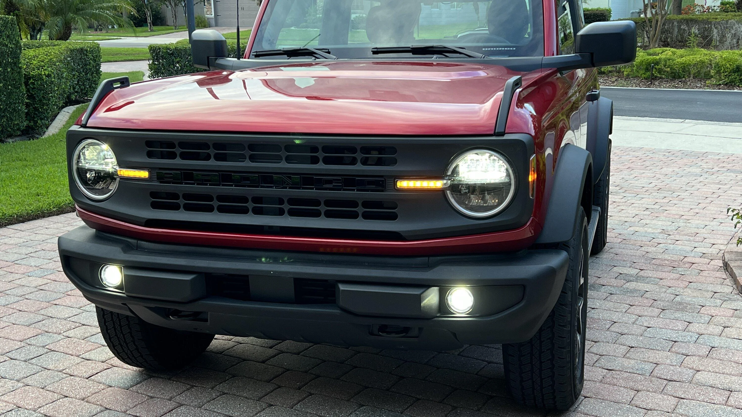

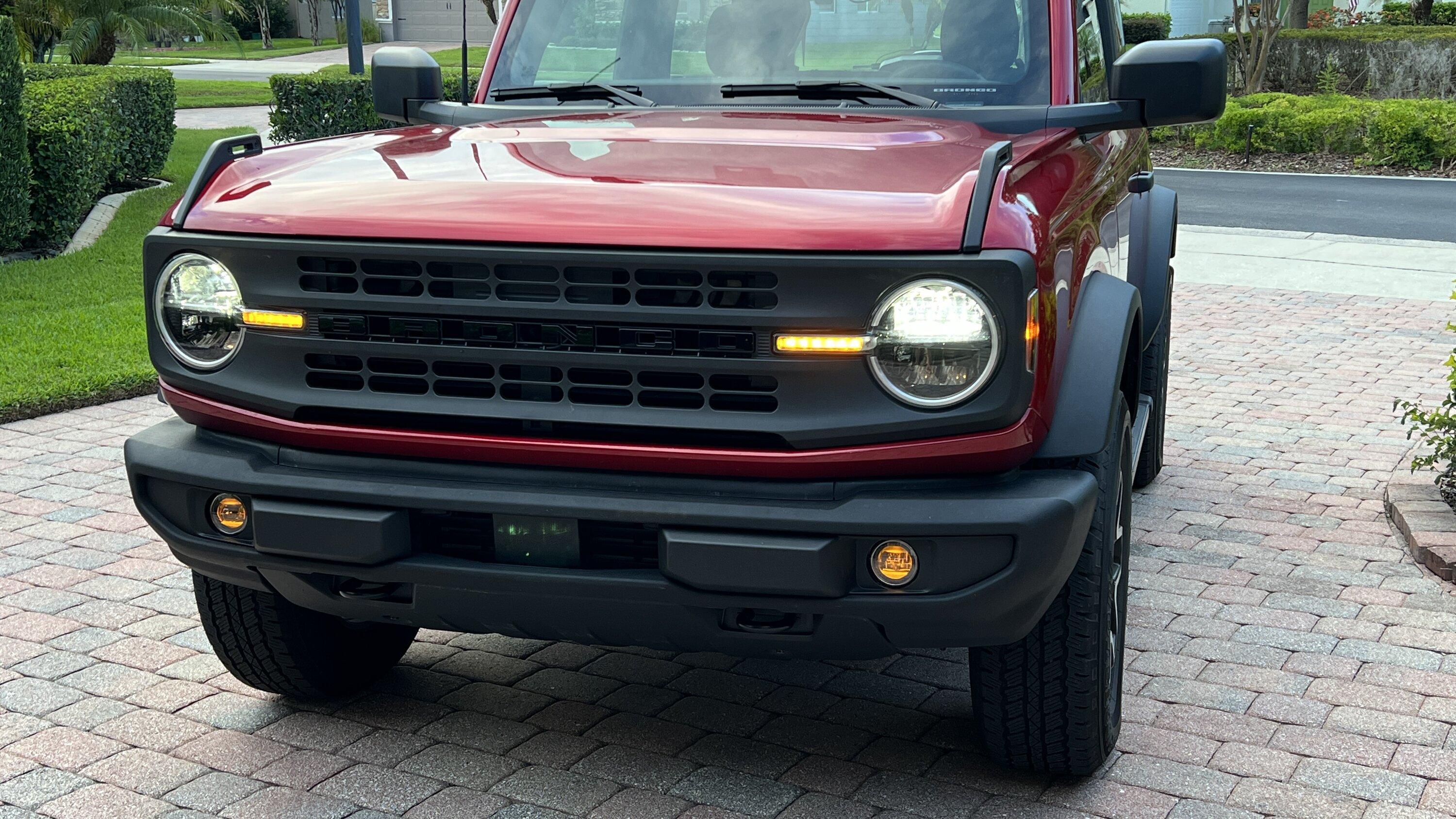

Finished installing the Diode Dynamics Elite Series fog Lamps this weekend on my 2021 Base. I replaced the factory headlight switch with the front fog enabled one and made the necessary changes in FORScan. I am very pleased with the build quality and the amber backlight capability.
Did you set them up as cornering lights? Probably my favorite thing about adding fogs.
