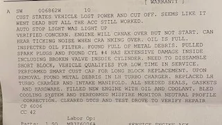

If its any help to anyone, here is the write-up from the service writer on my engine failure when I got the repaired bronco back. I will also add to my original thread. Should be attached as an image / I only chopped off my personal info at the top.
@flip @j_marinelli
Ford Bronco 2.7 engine failure tracking thread - Ford Please! Bronco Service Write U
