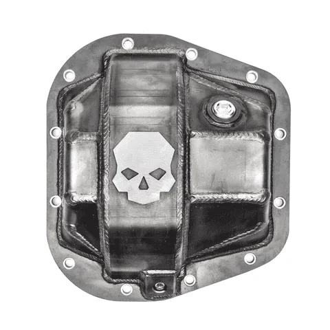

Please correct me if I am wrong .... the difference between an aluminum and iron diff is only the diff cover itself so if you have an aluminum cover can't you just swap it out with a more durable cover?
I run this rear diff cover on my Raptor
No, it's not just the cover. Even if the housing was steel though, it would still have the small ring gear which is the weak point. As the ring gear gets bigger, it also gets stronger. Breaking an axle or CV on the trail sucks, but can be fixed. Grenading a ring gear on the trail is catastrophic. The M190 is a weaker option all the way around. Might still be strong enough for 99% of the uses, but I like to plan for that other 1%.

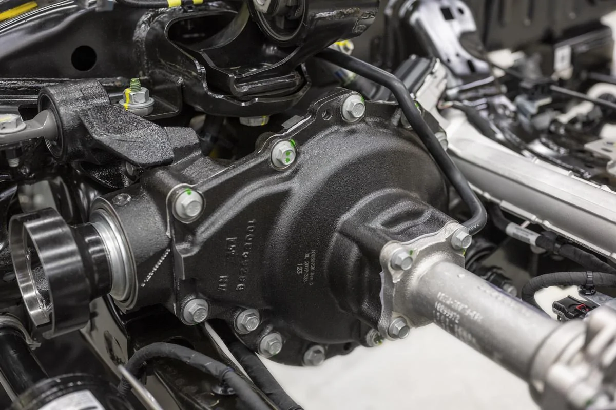

Front diff on Bronco/ranger doesn't have a cover...its a dropout

Thats what the dropout looks like. Makes me wana puke every time I look at it...but that's what we are getting. I dunno about U but I dont ever wana have to F##k w/that thing!
