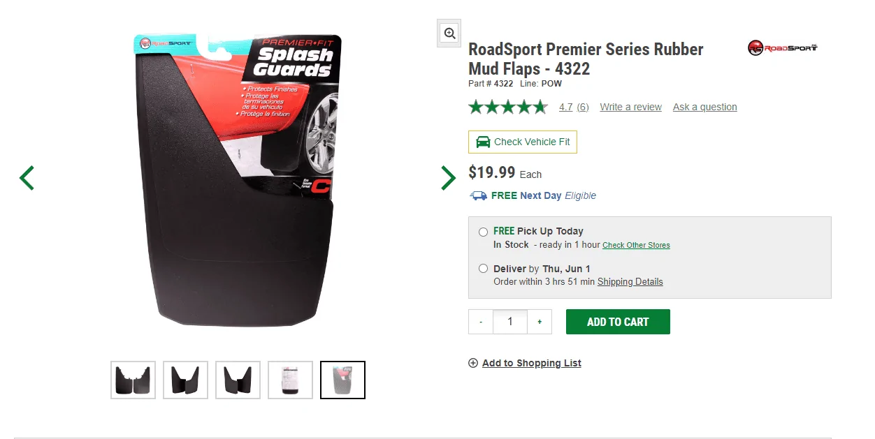

I put a rock through those and they are now cracked.
Was it freezing cold or something? I've had no issues at all, and because I only installed them on the fronts, I have an entire spare set since you get 4 for $20

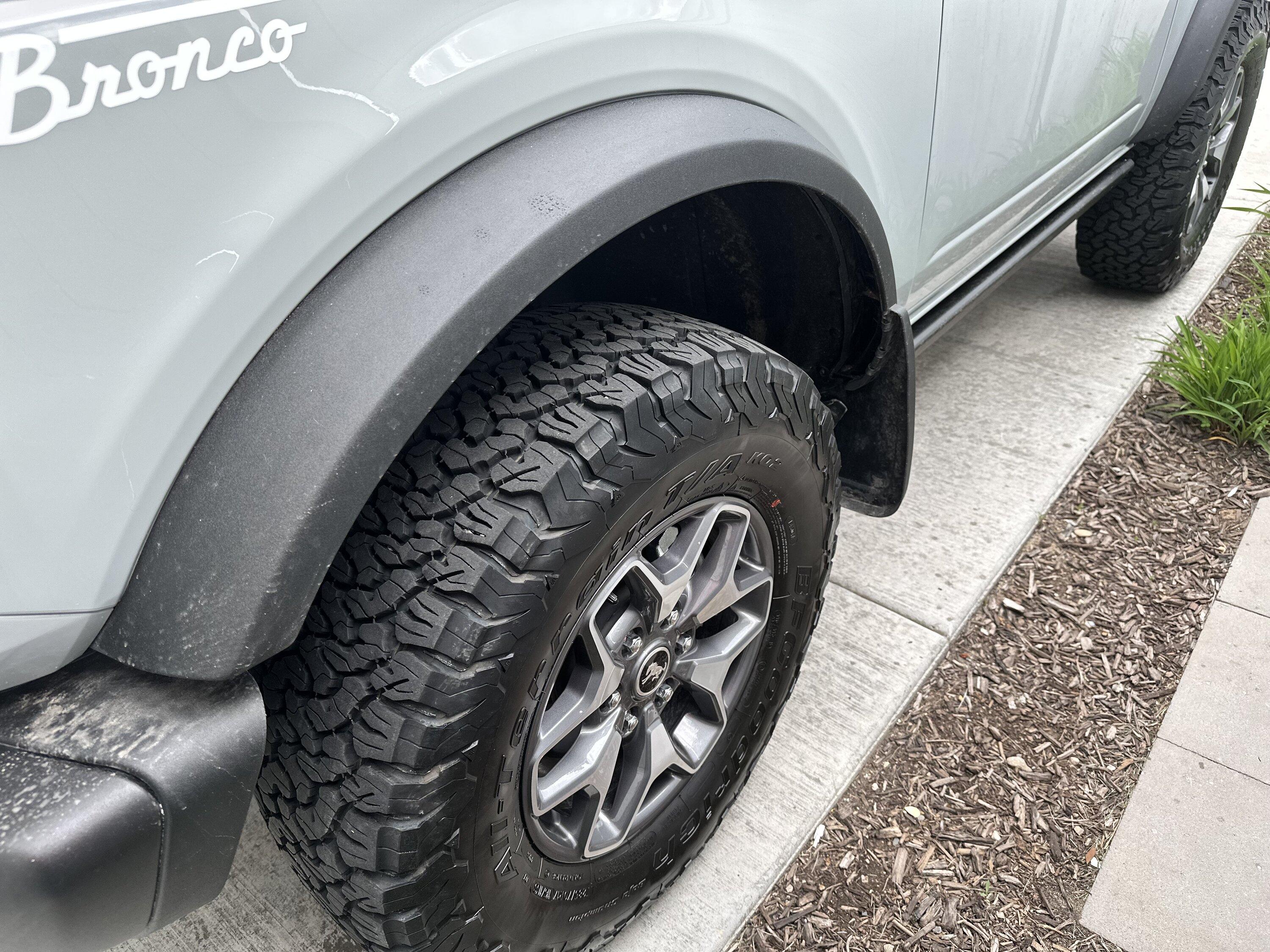

I bought rockblock and iag and installed both to see what they looked like. I kept the iag as I feel they look more stock.
Ford Bronco I need mud flaps, whats everyone using? IMG_0109

What's the (honest) feedback on these front IAG minis after a few weeks? I like that they're inconspicuous - wondering if they actually provide any significant rock/splash coverage?
So far they are better than nothing for splash protection. All road driving since installing. I really do like the way that they look and have gotten a few compliments on them. I think more of a minimal addition and If they don't work out I'll upgrade later but so far so good. I do have a set of AR Magnum side steps coming so I'm hoping that those compensate for anything that the small mud flaps miss. Only thing, I think they could have been about an inch or so wider to cover the tire width.

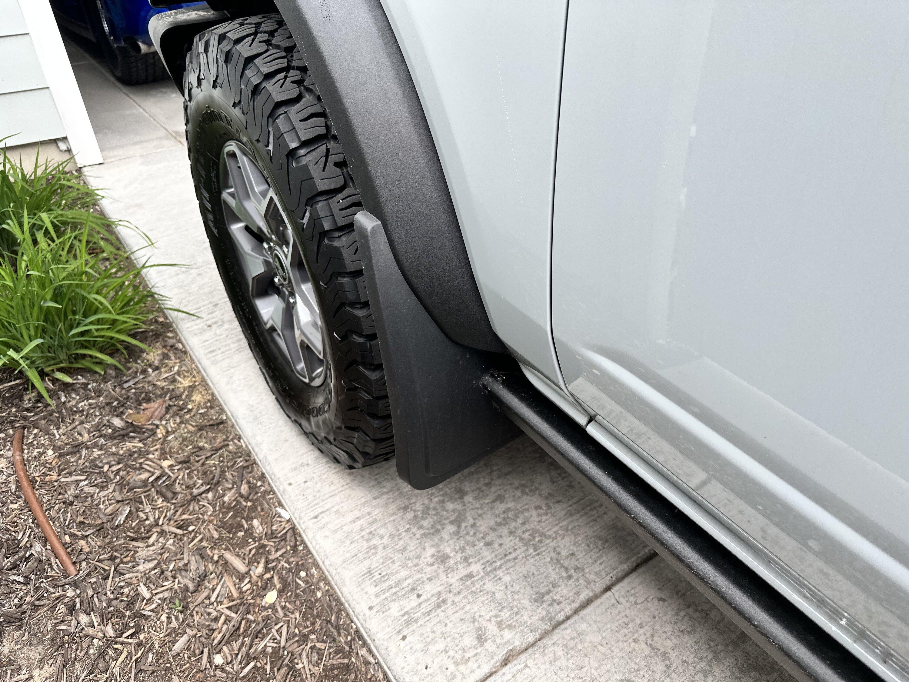

I went ahead and cut the OEM splash guards to fit around the rock rails. I had purchased them, not realizing they didn’t fit, and by the time I got around to installing them, the return window was closed. So, I figured I didn’t have much to lose. I ended up not even drilling a hole through the flares because the three C-clips I got for each flap hold them tightly to the flare, and the other two screws hold them to the Bronco.
A follow-up, one month later: I've been off-roading a few times since installing the OEM mud flaps in the front. Each time, we experienced rain for at least part of the day. There was enough dirt and mud in the undercarriage that it took at least twice as long to wash underneath, and I still didn't get everything out. The mud flaps prevented all but the slightest amount of mud from getting on the body. There was no appreciable mud aft of the rear tires, so I don't see the need to add those.
I think the OEM flaps have the best look, and the price is equal to or better than most after-market options. Installation is pretty easy, and you can even forego drilling holes in the fender flare, as the 3 clips provided securely attach the flaps to the fender flare without using the additional screws to attach to the flares. So, installation consists of removing two screws, adding a C-clip where one screw goes, and installing the flaps with the new screws. Then, use three clips to attach the upper part of the flap to the fender flare.
For those without the rock rail, the choice is easy. If you have rock rails like I do, installation is a little more time-consuming, as you need to line up the flap with the rock rail and trace a pencil outline of where the rock rail meets the flap. Then you use an X-Acto, utility knife, or similar to cut that area out. I might not have bothered if I wasn't past the return period, but I'm glad, because the end result is clean, looks good, and performs well.
Ford Bronco I need mud flaps, whats everyone using? tempImage8CLIHO
