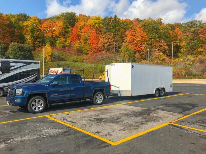

I rented an 8x20 ft enclosed trailer recently. It weighed just a touch over 3,000 lb empty. I towed it empty, on a windy day with my 1500. It was fine, but I certainly felt it. Later on, my dad towed it loaded, and unloaded with his 2500. As expected, you felt much less (little to none) input from the trailer in the 2500.
My point? It's not always just about weight, but surface area as well. Bigger, heavier vehicles feel more planted when towing.

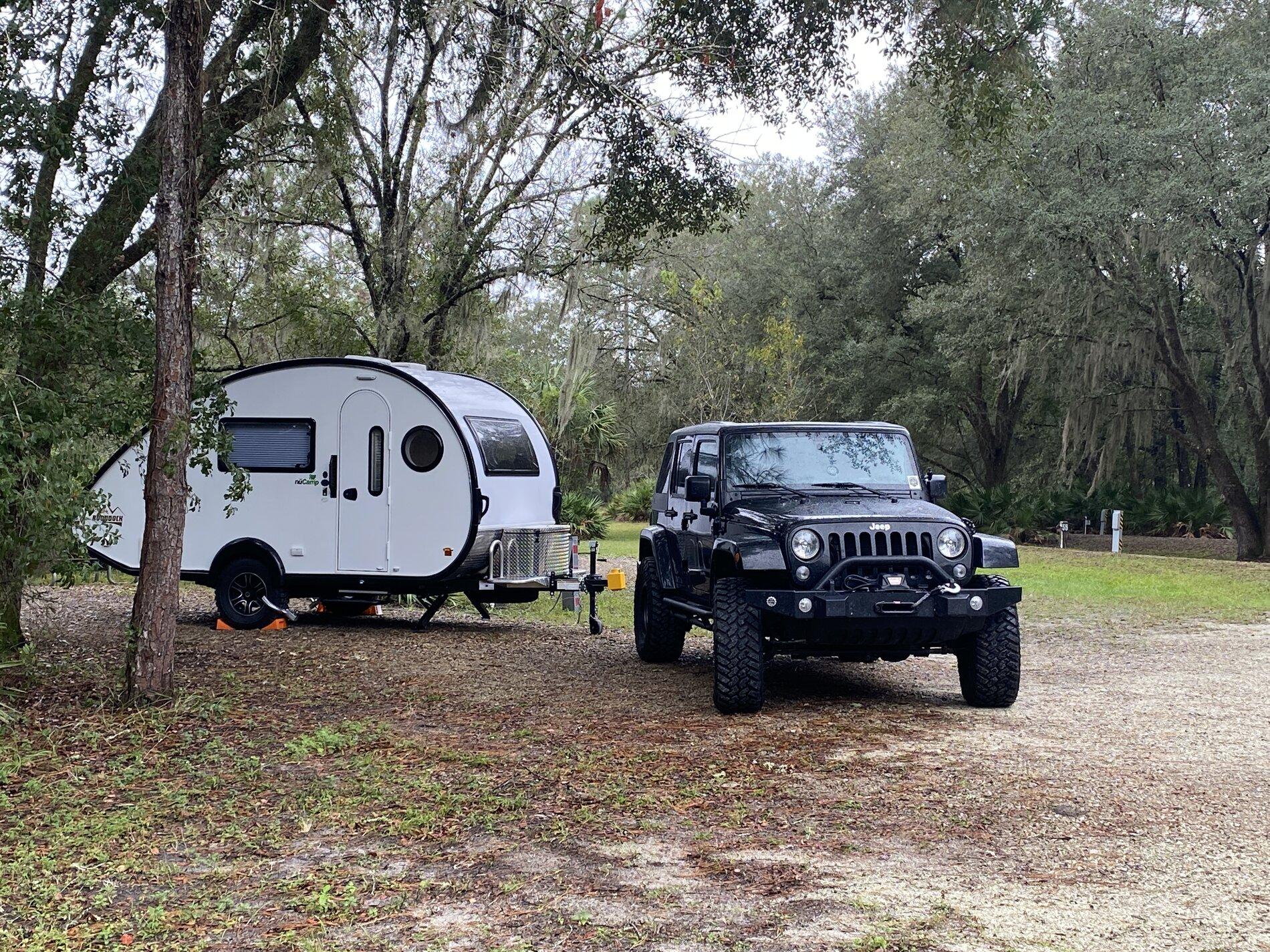

This is our camper. It fits under the 3500 lb limit. Hitch weight is at the limit. GCVWR is close to max as well. Weight distribution hitch and anti-sway bars keep it under control and the Jeep level.
So you can tow a pretty decent size camper with a 3500 lb limit. Just have to load it carefully and drive at slower speeds.

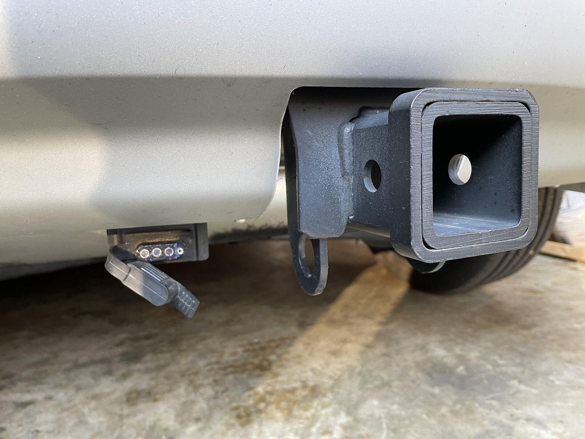

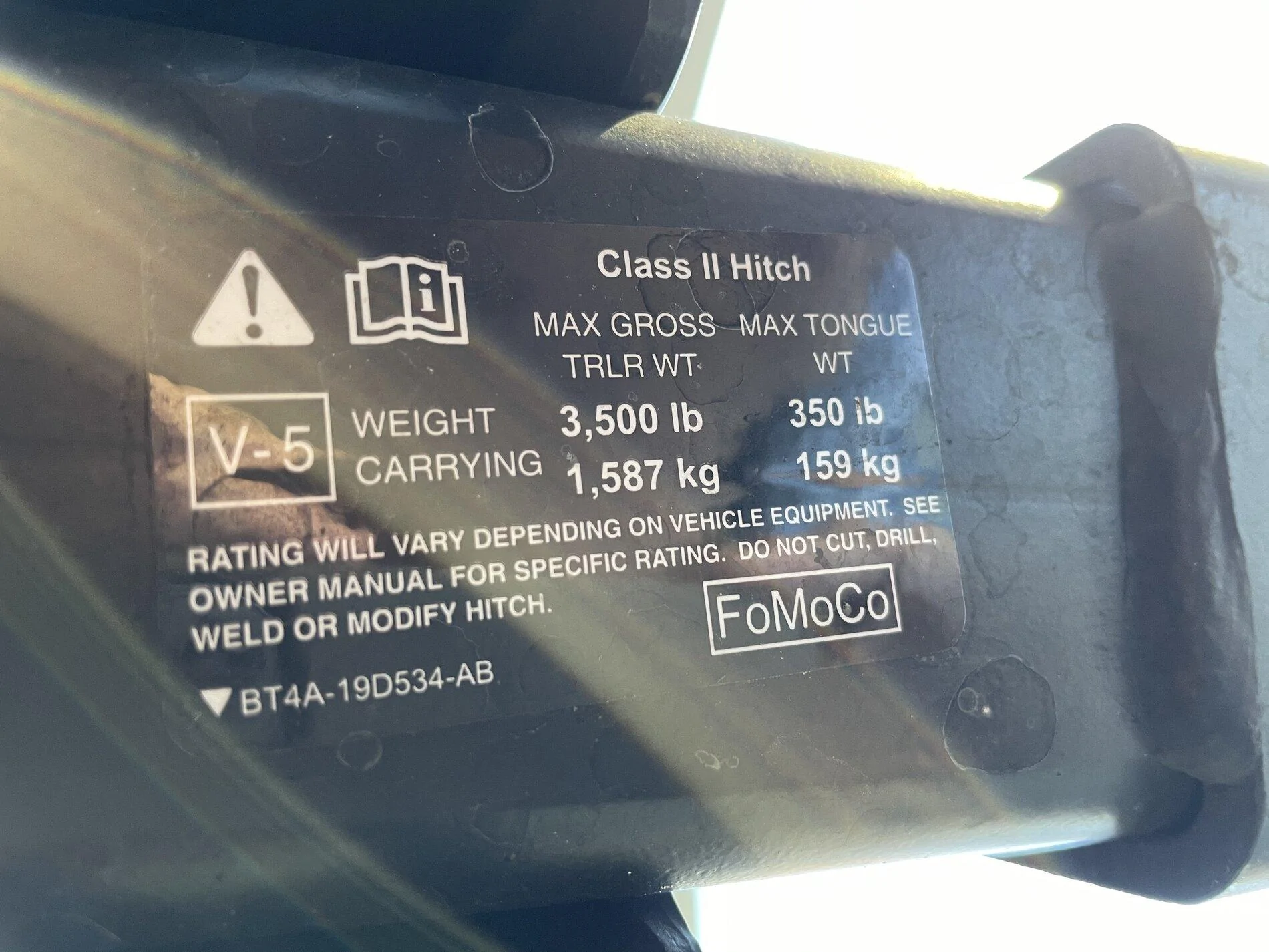

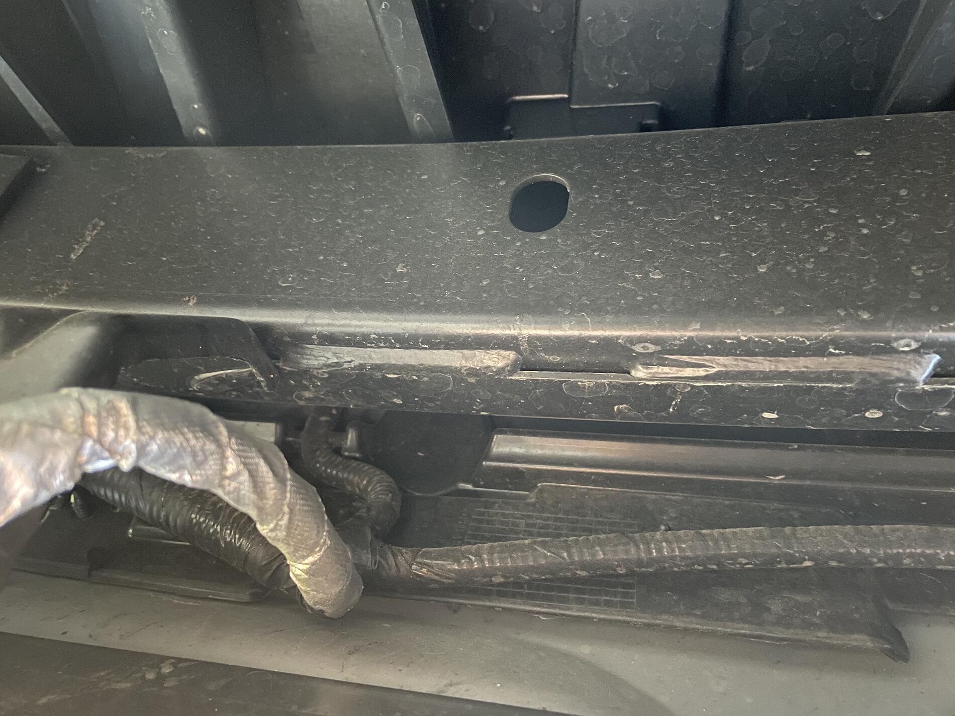

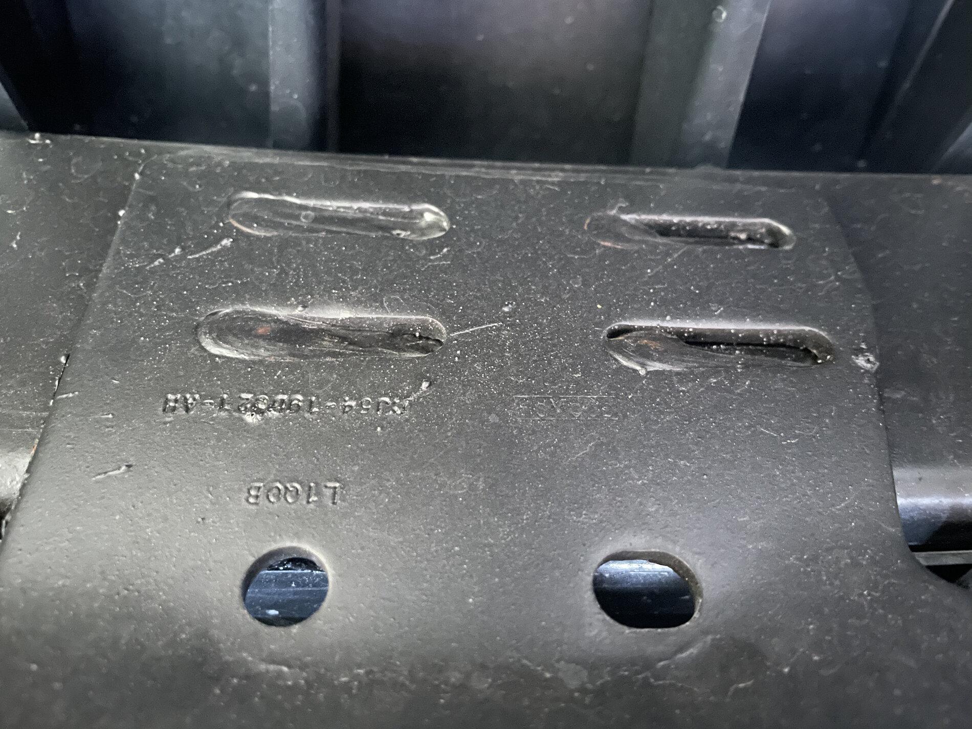

I have a 2019 Escape which has a 3500# w/350# pound tow/tongue weight limit. I took a few pics to just give an idea of what it looks like. It only has the flat trailer plug while the Bronco has a 7 pin plug also. The pic with the wiring is the wire loom running from the passenger side. The silver tape wrapped wiring is going to the plug and consists of four wires. You can see it is welded to the frame with weld through four slots. I believe the tow hitch is bolted to the frame on the Bronco.
Edit: It has the 2.0 Ecoboost. The 2.0-liter EcoBoost four-cylinder engine uses a quick spooling and durable BorgWarner K03 turbocharger to achieve full boost by 2000rpm. On 87 octane this equates to 270 pound-feet of torque at 3,000 rpm and 237 horsepower at 5,500 rpm.
