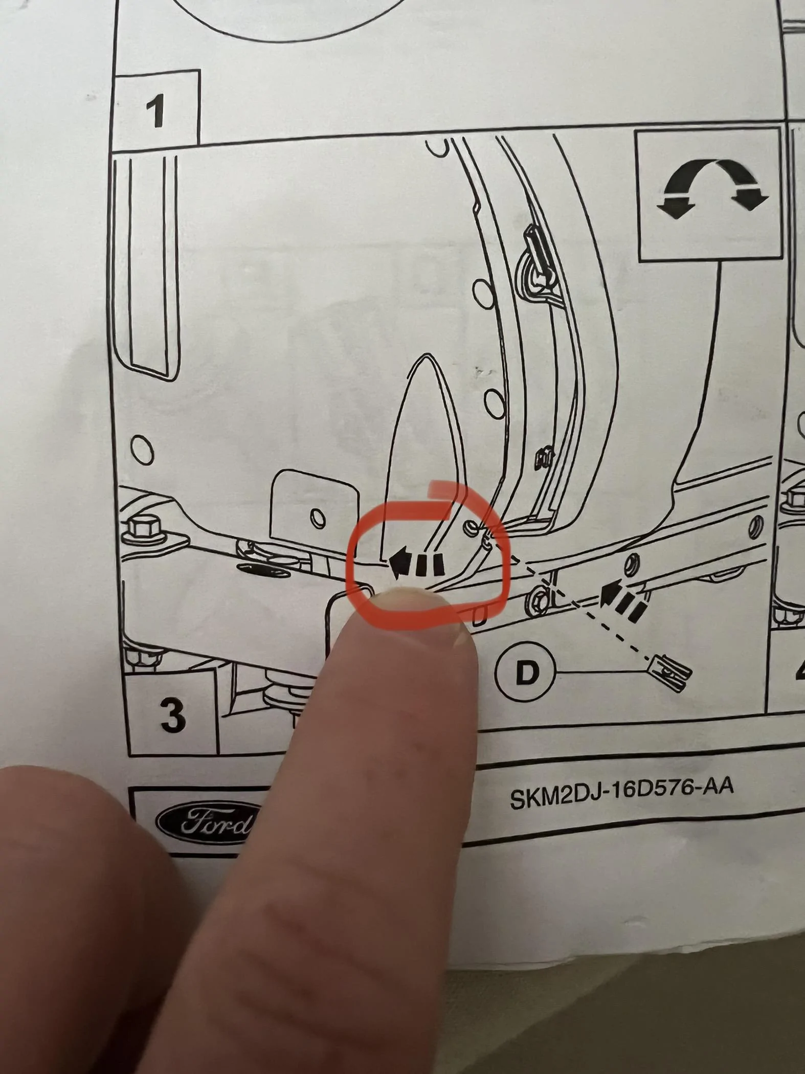

I responded on the other thread but actually I disagree….
yes, the directions are HORRIBLE..
BUT…this step makes clear you pull back the felt for clip “D”….(see the arrow)
D goes over the hole to create a place for the screw but not over the felt too.
now the C clip at the bottom DOES go over the felt, but NOT the D clip
So what holds C clip up in place? The thickness of the felt liner and the thickness of the felt liner? Or is there a slot in the fender flare lip?
Does the crash bar get in the way when installing it?
which One?
each flap has 3 C clips
on the side of the mud flap you can see kind of two slots where the c clips go on the side
when you push them onto the flap and fender it’s very tight

which One?
The third black clip, behind the crash bar.

which One?
I've had mine on for about 15k and yesterday I noticed the clips that hold it to the flares have come off.
Anyone have a part number for just the clips?
