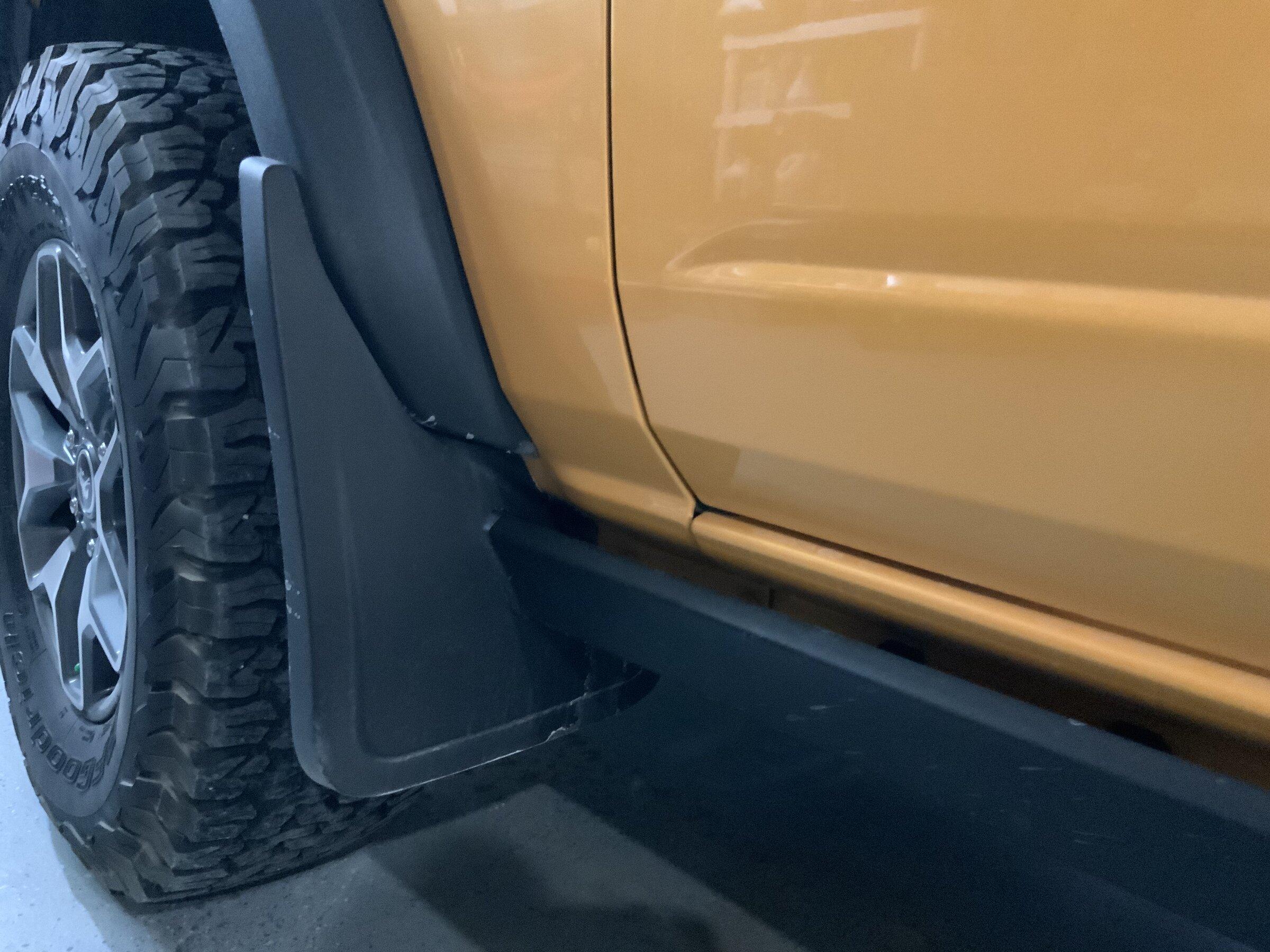

didn't some people just switch the side steps left to right which then made it possible to use the cheap flaps from Ford w/o mods? I might remember that wrong, I have the rails and Gatorback flaps (but not from Ford) so never really paid that much attention, but I believe at least some kind of side step works if you just flip them around and to the other side. Might be worth a search here.
I think others just cut the steps a bit short and put the plastic end cap back on, not sure that's what I'd do, could have done the same with my rails, but getting the fitting flaps seemed a bit safer than starting to cut off pieces.

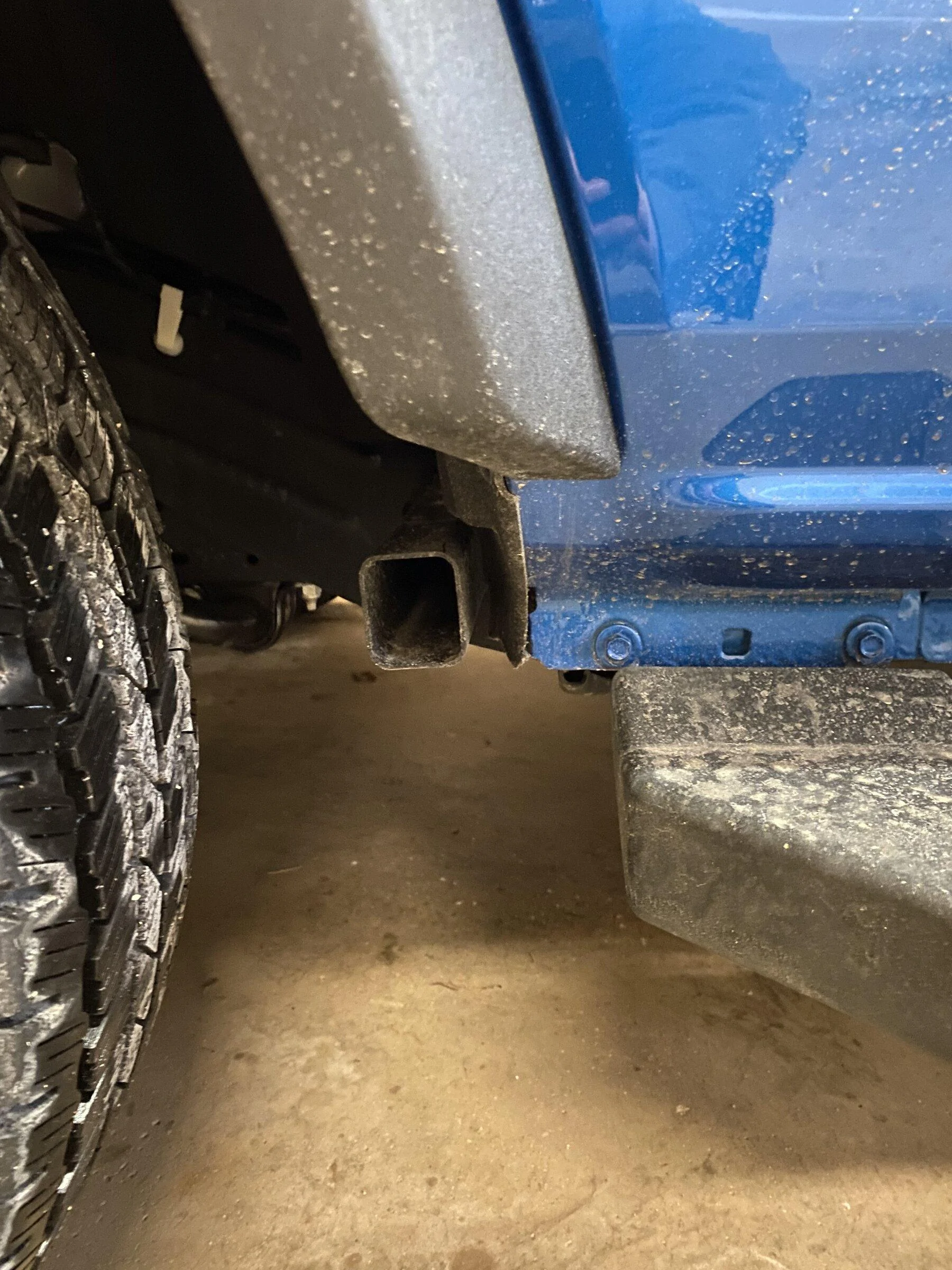

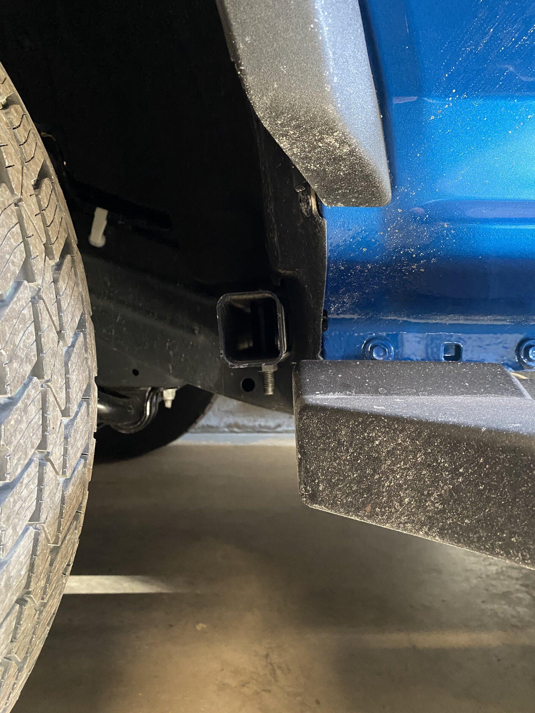

I repositioned my side steps about 2-plus inches back per the pics. I removed the steps, drilled 9mm holes, inserted M6 rivet nuts and then remounted them using the same mounting bolts. Pretty easy. A forum member had posted pics and instructions, which I followed! Now the rear of the side steps are close to the rear tires, like real close! I have the OEM mud flaps, but the directions are terrible! I asked someone else on another thread about inserting a metal clip between the felt liner and the metal body flare, which I thought would scratch it up! I'm thinking of using a rubber washer between the metal clip and felt liner. Still waiting for an answer. Good luck!

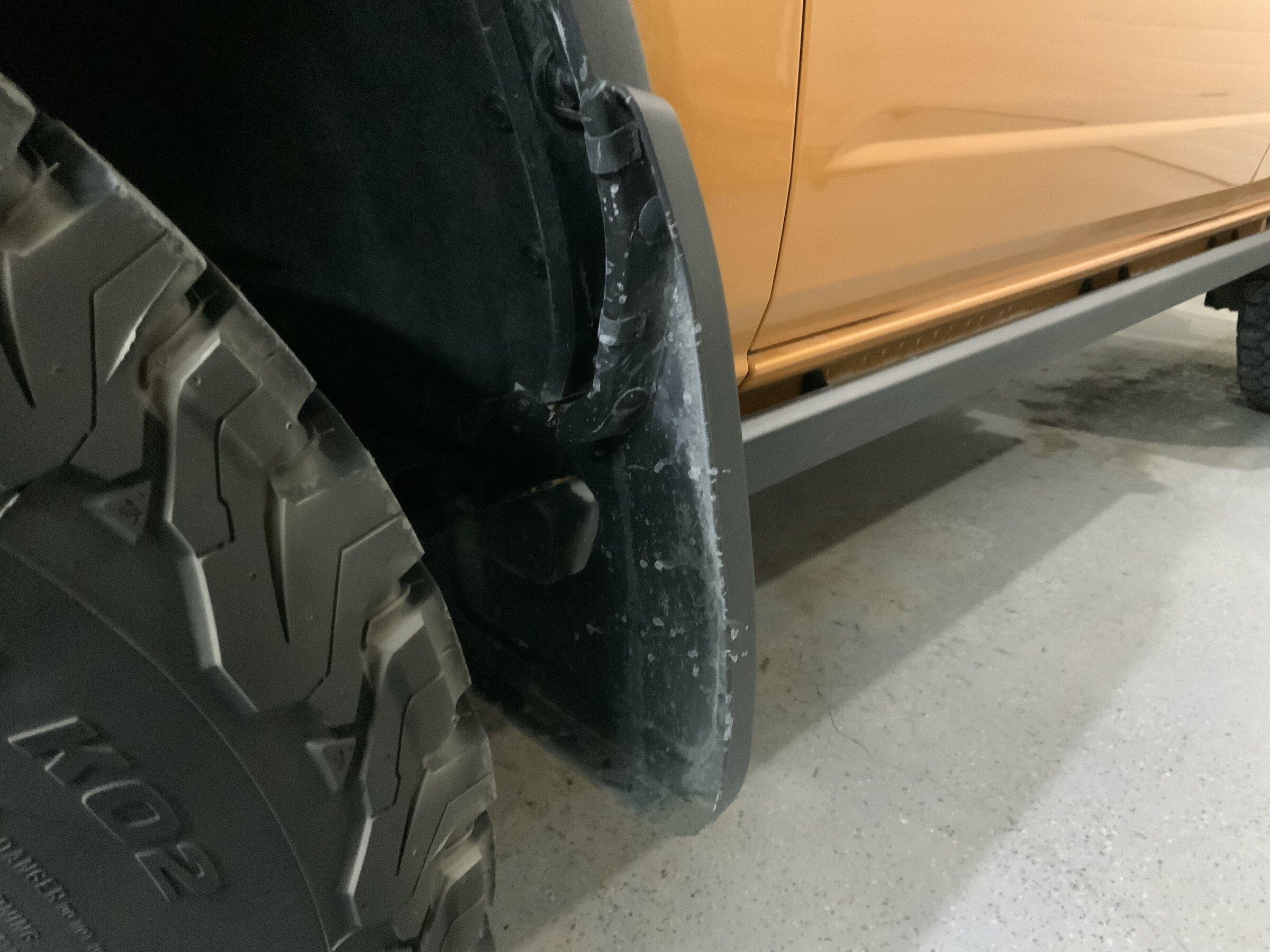

OEM Ford ones. Front fit well after I cut hole for rock rails on my Black Diamond but rear didn't fit too well so if I had to do it again I would have just bought fronts as it did definitely keep the rocks away.
