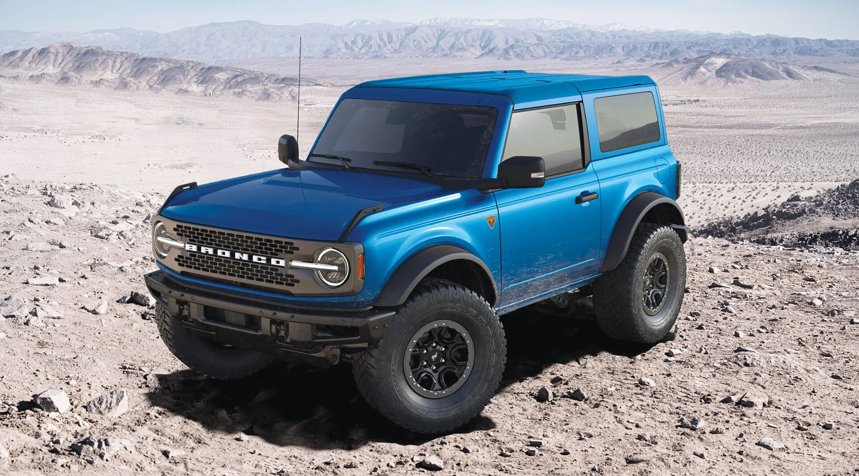

It's stunning. Nice work! Much better than my crappy Photoshop. :LOL:
Ford Bronco Look what I did - painted MIC hardtop, fender flares, side mirrors [updated with doors-on photos] Exterior-Left-Front-RGB-VB-MIC-To
