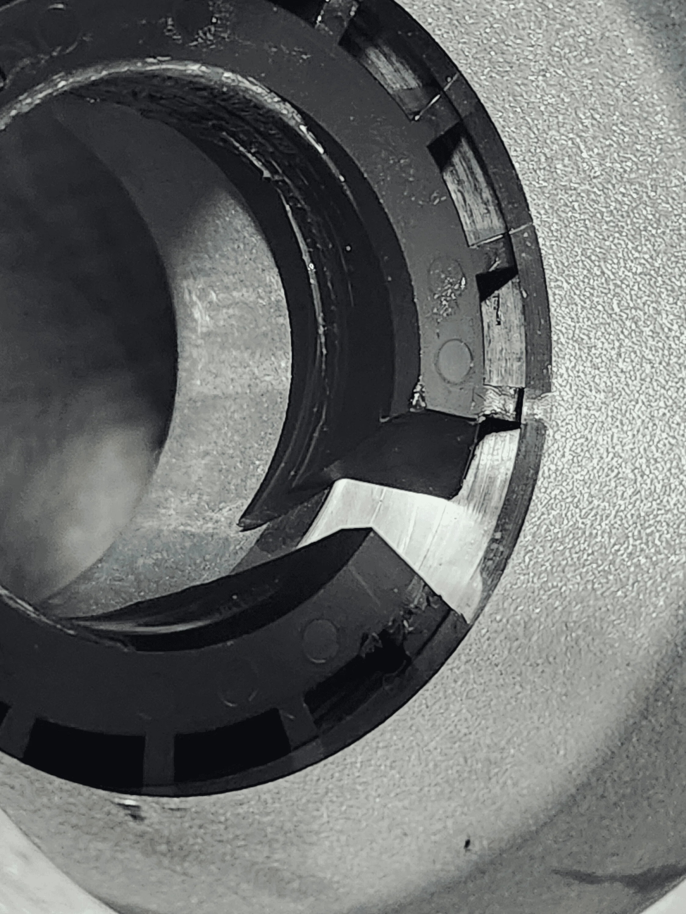

I keep seeing people post about steering upgrades, lets talk about what you are risking.
Factory tie rods are the big item everyone talks about as being the week link. We have seen mostly two kinds of failures, bent at the adjuster or snapped at the adjuster. The snapped failure is substantially worse than the bent failure as you have a complete loss of control over a partial loss of control. It is important to see the value in the type of failure as you rather have some steering vs no steering.
Factory steering rack is the next weakest item. The biggest hazard is the loss of the tensioner that can result in a complete loss of steering. The tensioner threads break off when the internal shaft running through the housing deflects. This occurs when the driver front tire puts to much pressure on the steering system the force pushes into the plastic factory bushing deforming it and then critically failing the tensioner. You also have an issue with the passenger side as doing the same thing but instead of destroying the tensioner it eats out the aluminum housing. This extra metal enters the system and slowly destroys the plastic power assist system.
If you upgrade your tie rods you are increase the stress put on the steering rack. You are literally moving from possibility of losing 1 wheel of steering to complete loss of steering. Spending some money on a driver side Delrin bushing is about the best thing an owner can do to mitigate the design flaw of the factory steering rack. This bushing helps mitigate the loss of steering hazard by drastically increasing the force required to break the tensioner on the steering rack. At this time with what is known about the Bronco Platform I would refrain from going larger on the tie rods unless you want be part of the break it first and find out latter club.

Icon tie rods are one of the strongest options out there and are stronger than the factory HOSS 1.0 housing. Icons probably even exceed what a HOSS 3.0 housing can handle. I would stay factory tie rods or maybe add some jks sleeves with the rough country bushings. The draw back to the passenger rough country bushing is you keep the factory housing. There have been enough housing failures to say I wouldn't risk installing Icon tie rods.
I would keep the Icon Tie rods as spare parts for the time being. Let a few other people destroy some parts this summer and see what works. I have a feeling more options are around the corner.
Tire size is irrelevant for critical failures, as it's the one mistake/instance that breaks parts. Force = mass x acceleration so even a smaller tire can have enough force if you crazy enough.
