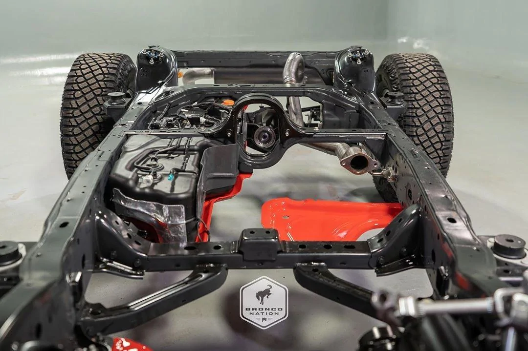

You just drop the tank and pull the basket out then swap pumps. Worst part is your not in a clean environment. I’ve changed and swapped many fuel pumps it’s not hard. You’ll smell like gas after that’s about it.
I can't imagine doing that trailside with a Bronco. The OP said he was at 3/4 tank approx 15 gallons at 6lbs/gal is 90lbs plus the weight of the tank. Probably need the fuel line disconnect tool.

Is there a rollover switch like on the old rangers? I recall needed to reset that switch on several occasions in my 1988 ranger....lol. it could be triggered by steep angles?
There's not a physical inertia switch any more but there is some impact detection in the restraints module that can kill the fuel pump after a hard impact. I think it would take a really hard knock to trigger it and also I would expect it to show a message on the cluster saying it was activated.
The tank is 4+ feet long and the skid plate alone is 50+ pounds so with 3/4 tank of fuel that is a tricky thing to do when not on level concrete. Also, the wiring and fuel lines aren't long enough to just let it drop to the ground so you have to partially drop it in a somewhat controlled manner.
You could cut line with tubing cutter and splice a rotary hp pu.p in line ,I would this before I drug it out. Maybe try a squirter of starting fluid to see if its fuel related failure.
This system doesn't have a return line so fuel pressure is regulated at the fuel pump itself. Old tricks might not apply to these newer vehicles.

Man that is tough, like most have said, if it is the fuel pump, not a bad job to do, BUT with 3/4 tank of gas and a incline, this isn't an ideal situation, and makes for a even more fun of a job.
Is there not a fuel filter on these Broncos? If so, this would usually be the spot to disconnect, run the open end into a fuel can and turn the ignition on to see if the fuel pump primes.
Seeing this makes me think about making an access panel in the floor to get easy access to the pump housing for times like this. It's a thought!

Couldn't you just get 3 - 5 gallon gas cans from the store then drain it in there- once complete just pour it back in?
Silver-Bolt
Bill
3,028
4,973
Portland, OR & Eureka, MT
2018 Ford Raptor, 2020 Audi SQ5, 2023 Wildtrak
Drain it how? There isn't a drain on the bottom of the tank. I don't see too many rigs carrying 3-4 empty 5-gallon cans on the trail.
Not saying it can't be done. I am saying it would be a big fix to do on the trail. More than your typical basic tool kit.
The best option would be to prep in advance and cut in an access door through the floor. Take it out through the top.

Who will be the first to pre-emptively cut an access hole in the body?
Shoot, great minds think alike! I see how Infiniti did it on my QX, wouldn't be hard to make like sample. I will be looking into doing something like this when mine arrives.
You don't normally carry those cans but if you go back to do a trail fix you could be prepared and take the tools and equipment needed.
And you can syphon it out or drain it from a fuel line.
But yes if you don't mind making an access door then that would probably be the easiest fix.

If I knew 100% it was the fuel pump in the tank I could do it on the trail. I’ve replaced broken ujoints in drive shafts, stub shafts and rear axle shafts all on the trail I could totally handle a fuel pump. Just would need another set of hands to help get it down and back up.
