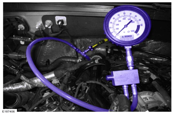

Is it possible (without blowing up the Bronco ) to loosen the fuel line on the engine side of the fuel pump and then turn the ignition on to see if the fuel pump is in fact pumping fuel?

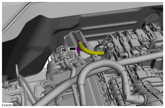

If you can get your hands on a fuel pump you can change that on the trail with simple hand tools they’re really not that hard to change. I seen someone mentioned the pump in the engine bay. Does that mean the bronco has a in tank fuel basket pump and a inline pump?
There's one on the engine driven by a camshaft. It's under a black foam cover. Looks like this.
*** Please note that I am not a mechanic and I did not stay at a Holliday Inn Express last night.
Yes, but if it is working it will spray alot of fuel. It's a quick disconnect RR of engine by DI pump

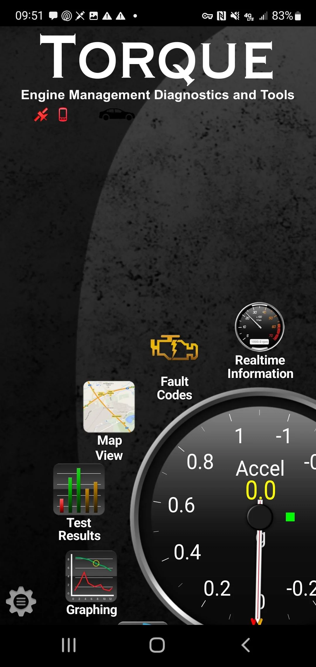

Everyone needs one of these, Android or IOS and this free app. Cheap and works, no cords and takes up zero space. Used them for years. I'd read codes before I started replacing a pump(s) on the trail. There's 4 other things it could be according to Jimmiee's diagram and this hasn't happened to enough folks yet to start throwing parts at it yet imo.
Ford Bronco My Bronco Died Today, Deep Into a Remote Trail [Fuel Pump Failure] Screenshot_20220601-095101_Torque
I have one and it works great. Simple and gets you some idea of what’s happening.
