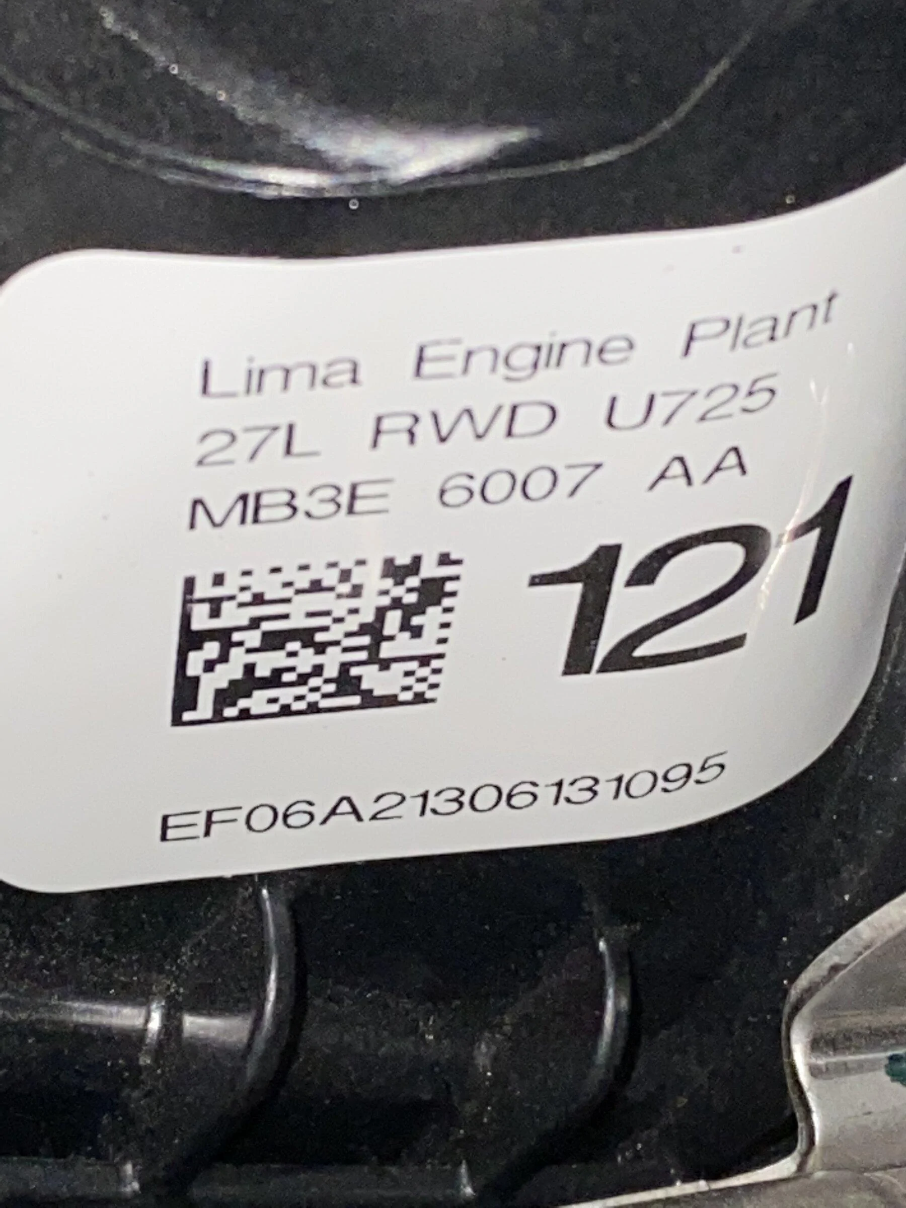

I doubt it. The crankshaft turns smoothly. There is just no combustion. Preliminary indications suggest fuel starvation. Plus, my engine’s Julian date (21306 = November 2, 2021) is outside of the known hot zones.
It def should not be the engine there have been no bad engines built in nov as of yet my engine was built on nov 19 sounds like it’s just something stupid and it still cranks which is good keep us posted sending good vibes your way

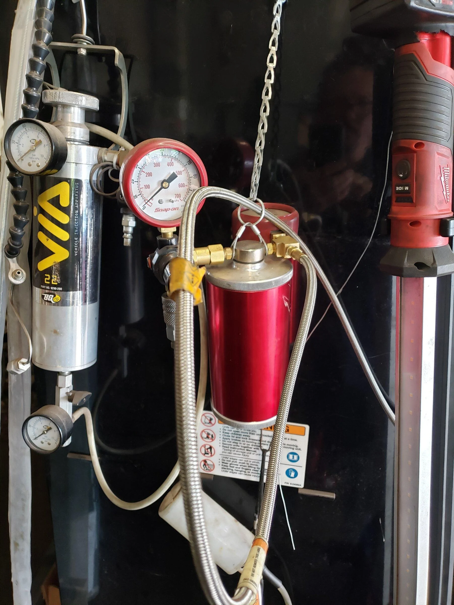

Thanks for the feedback. 👍 Just trying to think of potential ways to force fuel delivery short-term via a temporary splice just to get the vehicle off the trail so It can be brought back to a shop for proper repairs. 🤔
When we get vehicles towed in w/bad fuel pumps we use devices like these. They are meant for fuel injector cleaning, but they hold about a quart of cleaner or fuel, and the vehicle can be started and driven for a few minutes. They are charged w/compressed air, so if you or a helper has on board air you could make something like this work. Only to get through the trouble spots, then tow the rest of the way?

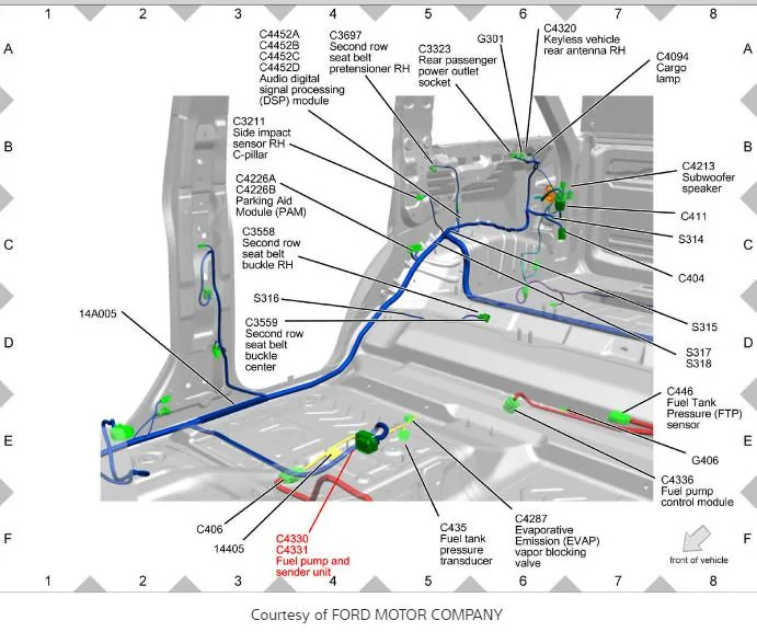

If you can get your hands on a fuel pump you can change that on the trail with simple hand tools they’re really not that hard to change. I seen someone mentioned the pump in the engine bay. Does that mean the bronco has a in tank fuel basket pump and a inline pump?
Here's a picture of the pump.
