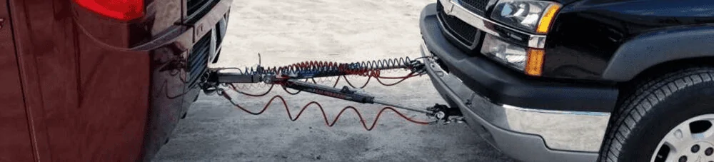

I'm hoping that another mounting solution is figured out because it doesn't look like I can do both 4-down towing and have a winch.
Likely need a new aftermarket bumper to solve the winch forward offset.
dmtndan
Jan 2, 2020
383
817
1991 Silverado, 2014 Malibu
You can put a hitch mount bracket on the front/back and have a winch put on that way. Assume it will have something if the sorts already to be towed.
Lab00Rat
1,587
4,403
MS
2022 BL 2-Door, 2021 Ford Ranger
The winch will interfere with the function of the tow bar for flat towing behind a motorhome.
Example w/o a winch.
Ford Bronco The Definitive Winch Thread 1599925055389
I'm not saying it cannot be done, just doesn't look like it. Need more details.

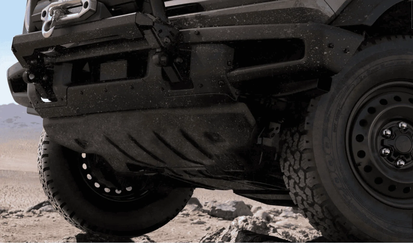

If you get the steel modular bumper which has the tow eyelets instead of loops or hooks along with a universal bumper end adapter kit from BlueOx you will be able to flat tow. That is what I will do, along with a Smittybuilt low profile 10K synthetic line winch. My only concern is the trail camera height, it may work with the low profile winch or will need a re-locating kit, not sure. The tow eyes do show below the bumper, might have to do a drop receiver to keep the towbar level.
GEP
Glynn
Sep 12, 2020
81
AB
Jeep
Not being nuts about the winch way out front on the modular bumper, I think I'm going to stick with my super old school and last ditch solution. A Tirfor and a pulley in my recovery bag. It will take all day but you'll get out. (I am not the kind of guy trying to get stuck though)
Lab00Rat
1,587
4,403
MS
Has the tow eyelets been confirmed as a flat-tow hitch point? I've been wondering about those eyelets for a while now.
Typical hitch point are wider to prevent sway.
JesseS
Jesse
Jul 18, 2020
1,090
2,076
Northern California
Jayco AY26, Honda F6B, CR-V
The hitch points on my BlueOx base plate are 24" center to center, hard to tell but the photos I have seen show the eyelets at least that far if not a bit more more. Remember if the hitch points are wider than needed it shortens the distance between receiver and toad bumper unless you use a receiver extension. As for you other question I haven't seen a Esourcebook for the Bronco yet, only the Sport.
Lab00Rat
1,587
4,403
MS
Yeah, I see. The Bronco loops look correct for frame connected towing.
Ford Bronco The Definitive Winch Thread 1599927934416
Ford Bronco The Definitive Winch Thread 1599928270080
JesseS
Jesse
Jul 18, 2020
1,090
2,076
Northern California
I checked with a source and was told the back of the eyelets are where the bumper attaches to the frame rails. I would maybe replace the OEM bolts with case hardened steel and locktight, and perhaps drill and add a bolt or two, will have to see. Had a friend lose a toad when the base plate broke free, seemed he didn't use 'red' locktight.
