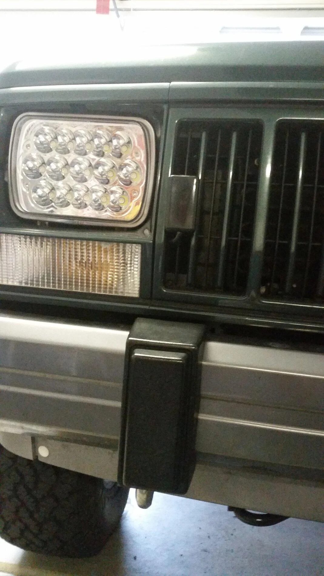

I have an Engo winch mounted to one of those Front Reciever mounts. Never got stuck to really need it but I've used it just to test.
Got one of those quick connects mounted in the grill... pretty nice setup.
But one drawback... I only hook it up when I know I'm going off roading. So it is not available if I just happen to be out or maybe do a little exploring while visiting a new area on a road trip..... so with the Bronco, I was planning on changing to a permanent bumper mount just so I know It will be ready whenever I'm out.
